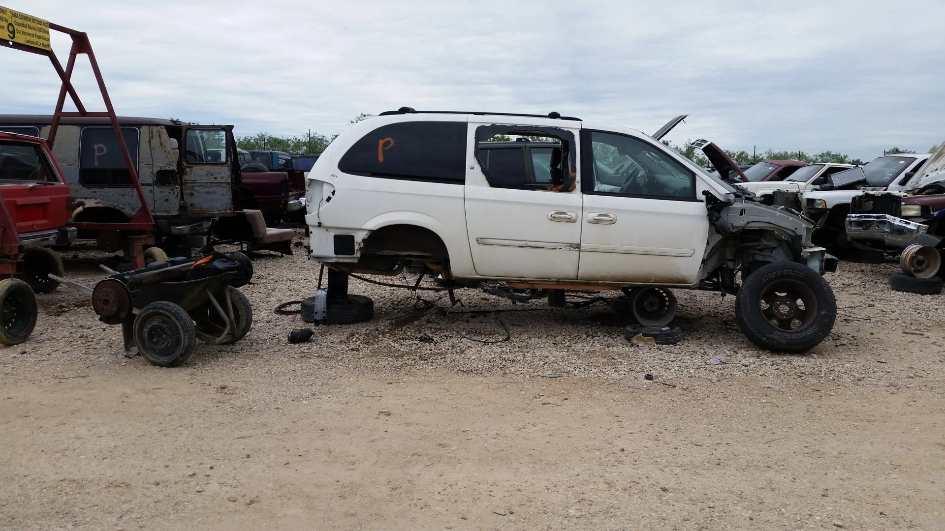

Most of my projects start in a Junkyard, so that is where I stopped by first.

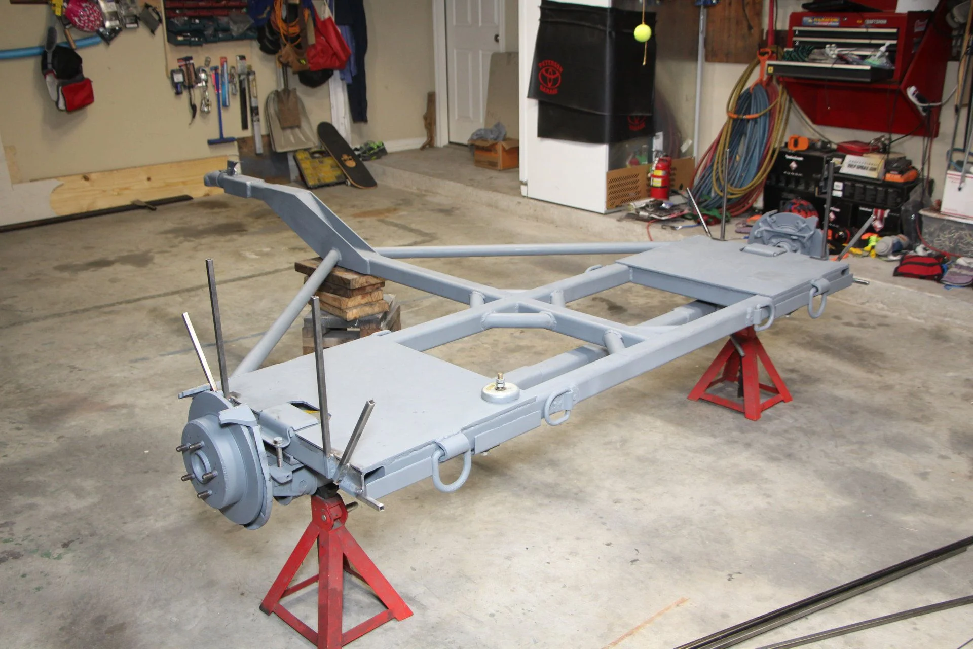

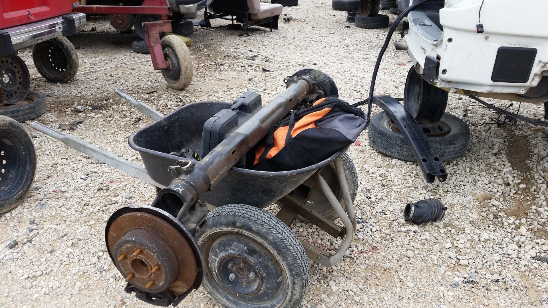

I found a nice 2006 Dodge Minivan and pulled the rear axle.

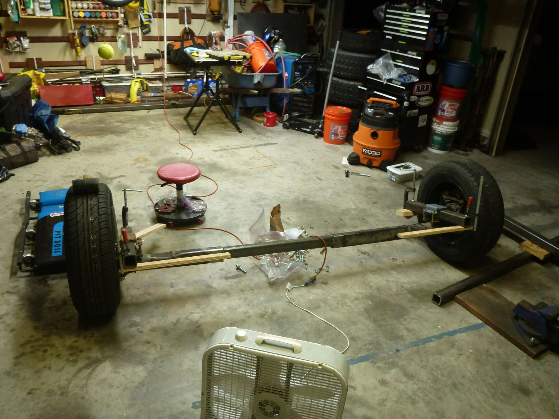

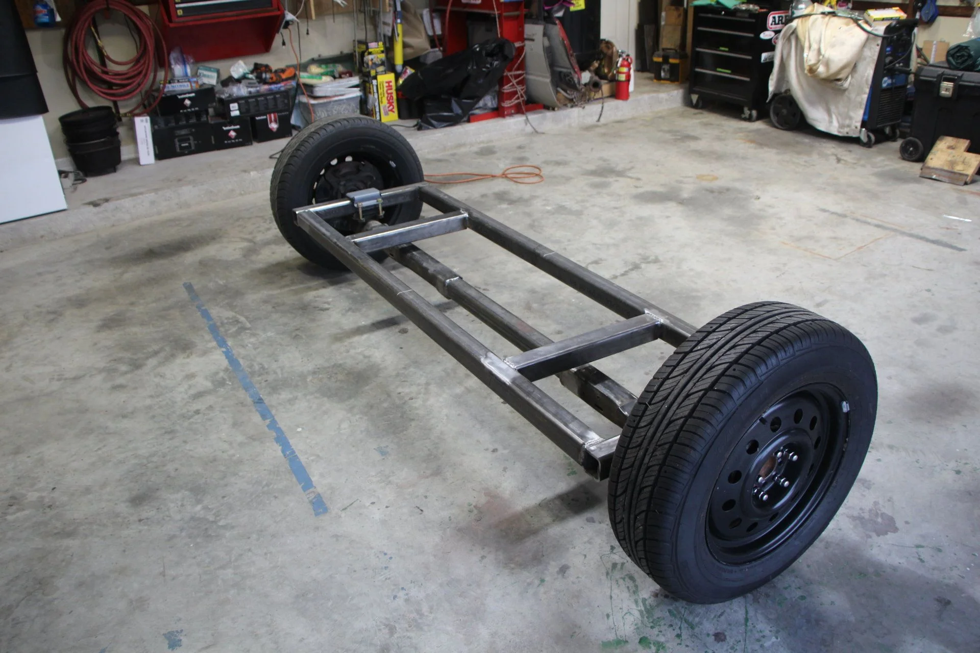

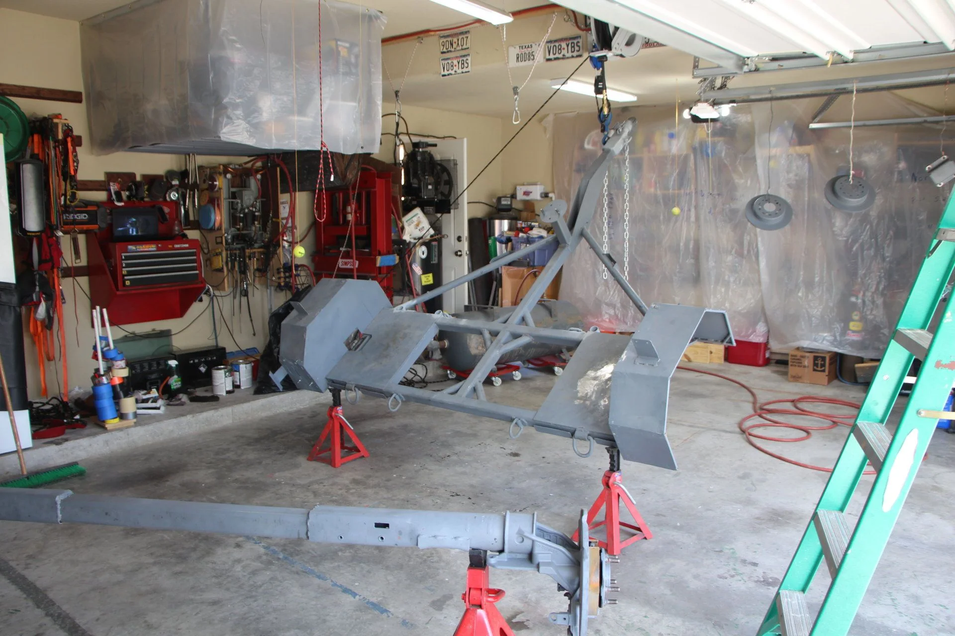

I took the axle home and cut it in half...

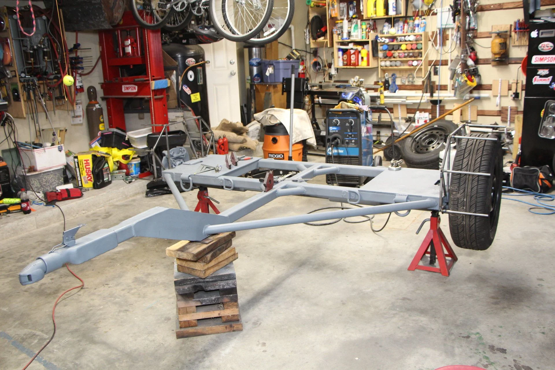

I had to make the rear axle wider and keep it under the Texas limit of 102" wide. Then I tacked on some steel...

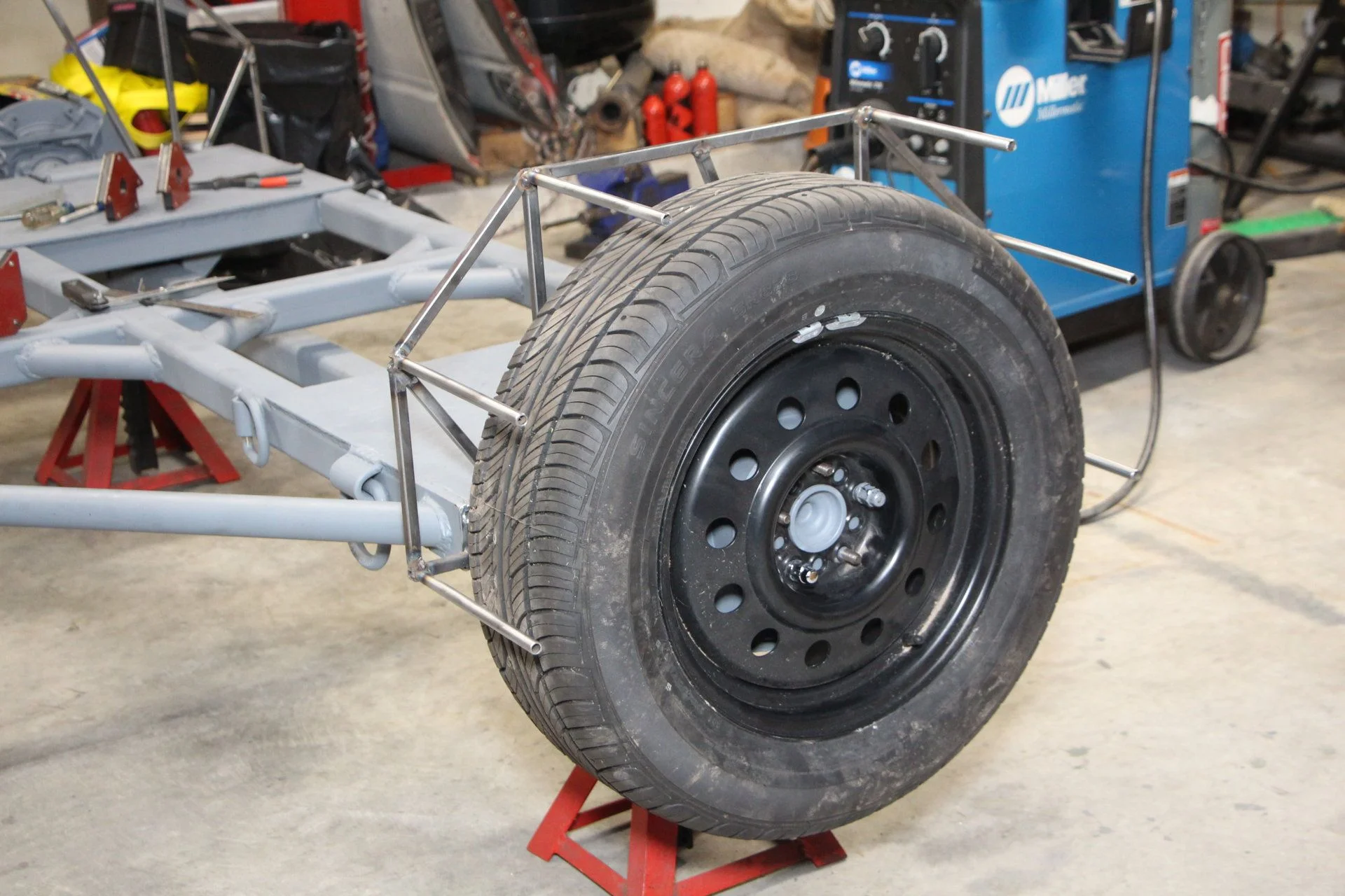

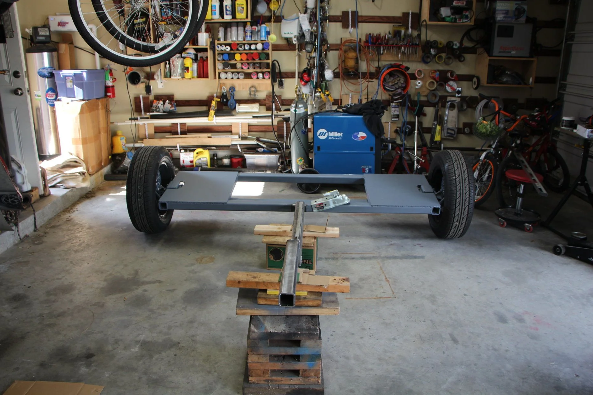

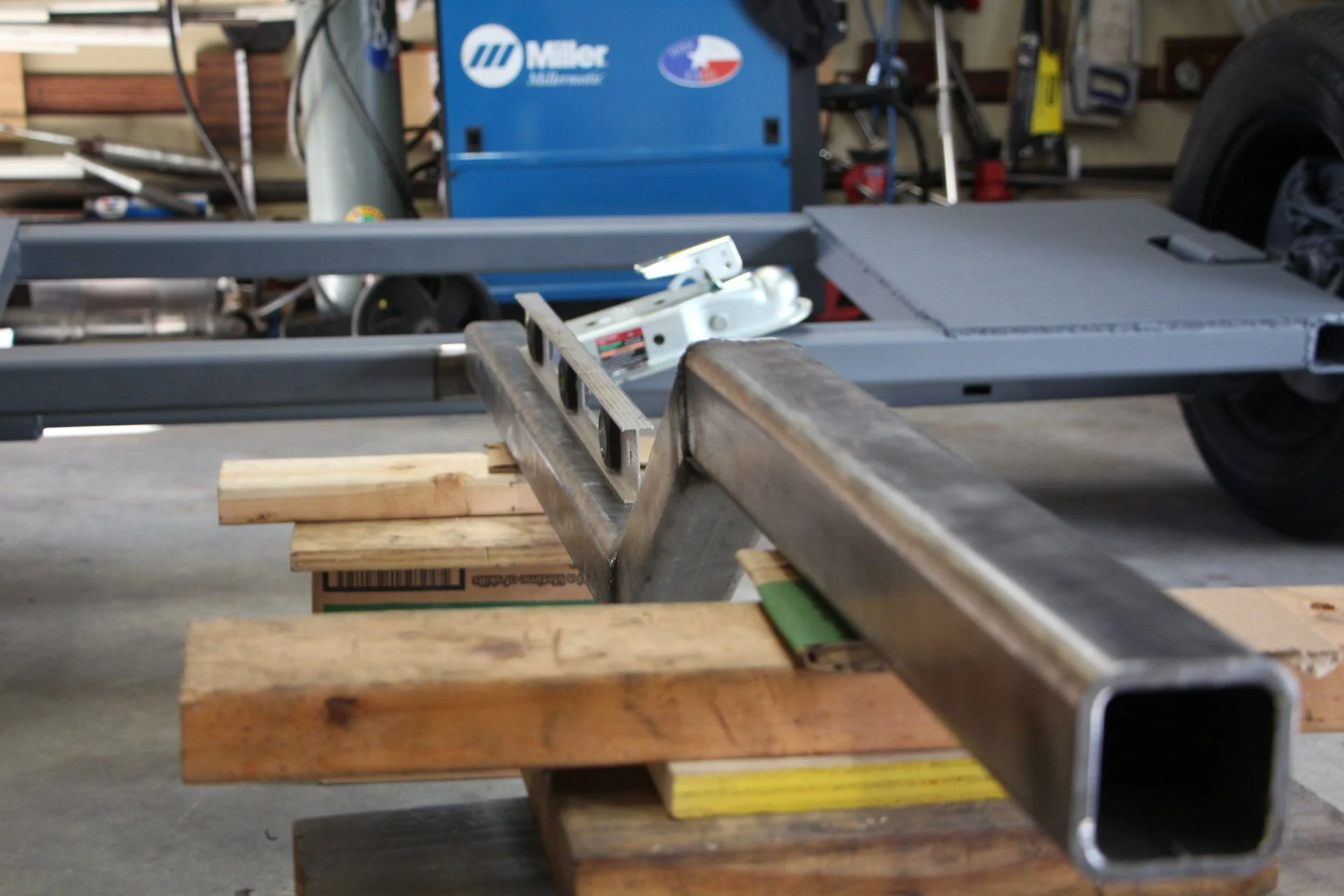

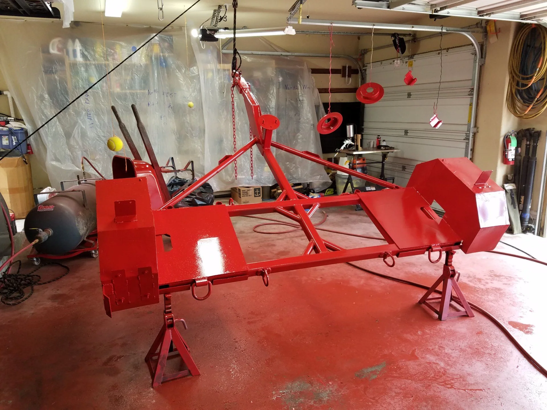

I added some more supports, some plate for my tires, more steel...
I added more support pieces, a bunch of D-rings, then I had to figure a good way to make the fenders...

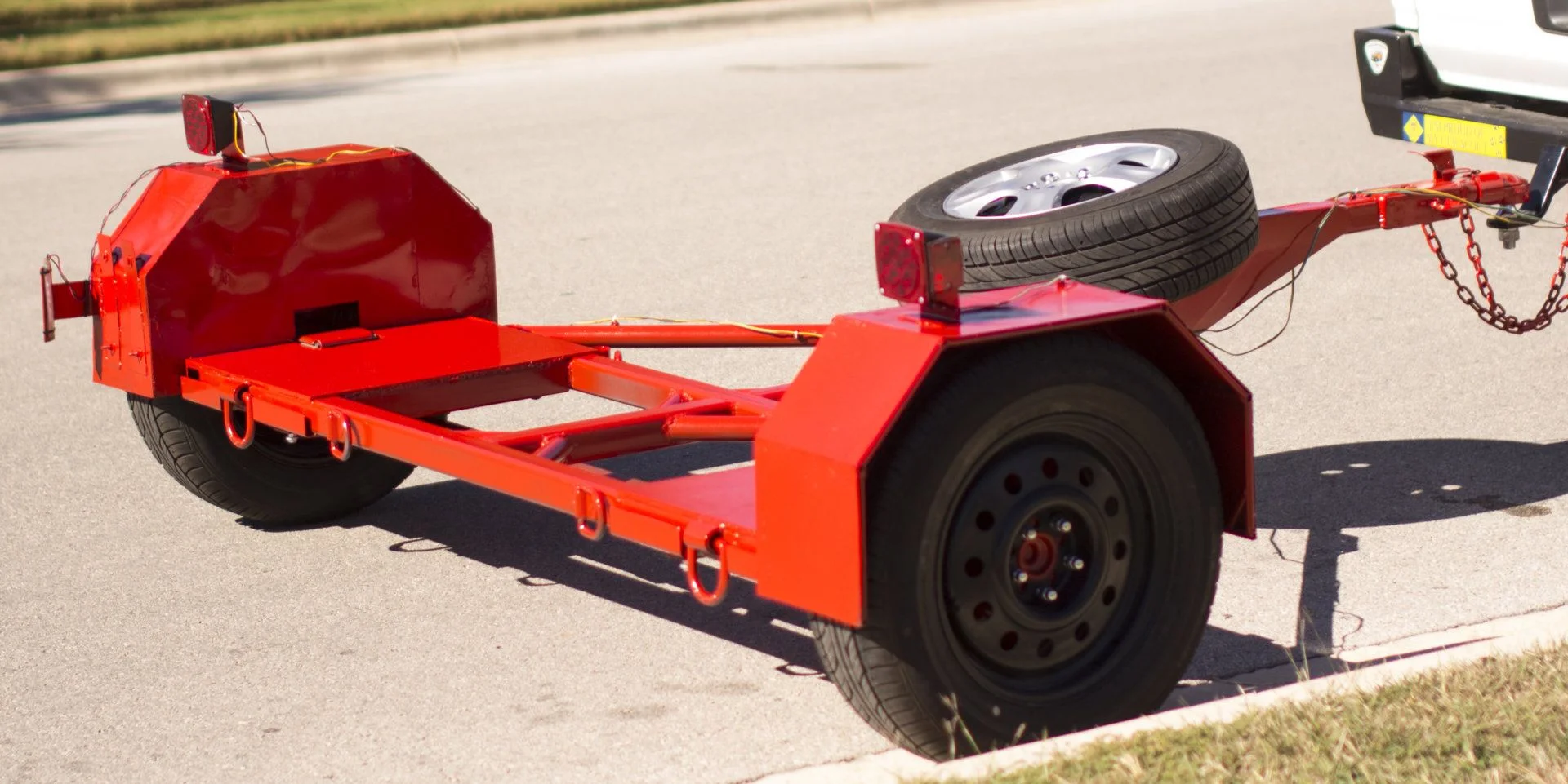

Then it was time to add some paint...
I usually use the Tractor Enamel Paint from Tractor Supply because it is cheap and simple to spray.

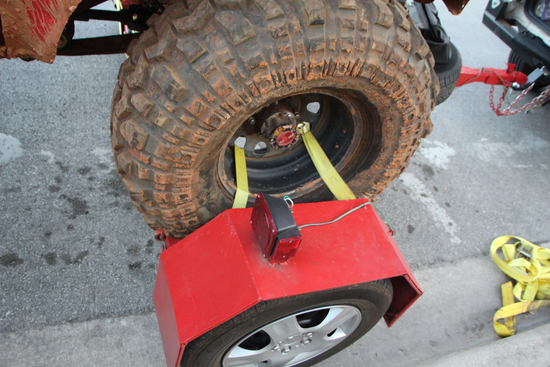

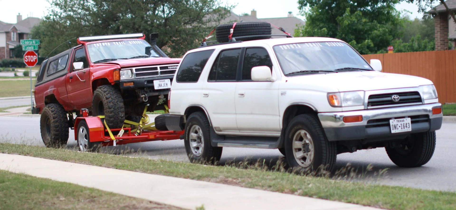

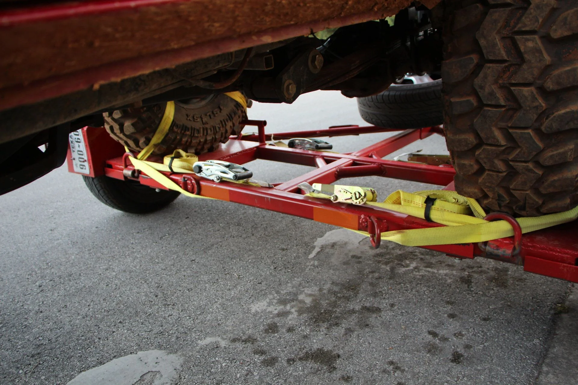

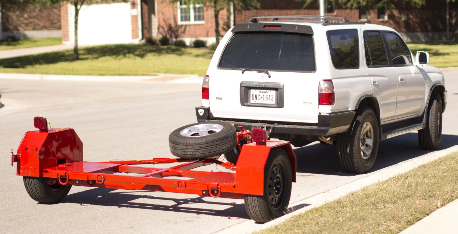

Here is a shot of my "stock" 1985 Toyota Pickup loaded and ready to go to the Lone Star Toyota Jamboree. I have used the trailer a few times and the straps seem to work best going through the D-Rings because it keeps the tires centered.
I used a lot of steel I had in the garage and picked up some more at the Recycle Center. I only spent $450 but it did take a long time to build.

I like everything but the straps through the wheels, You are asking for a cut strap that way. Didn't read all text, disregard if you addressed it above.
