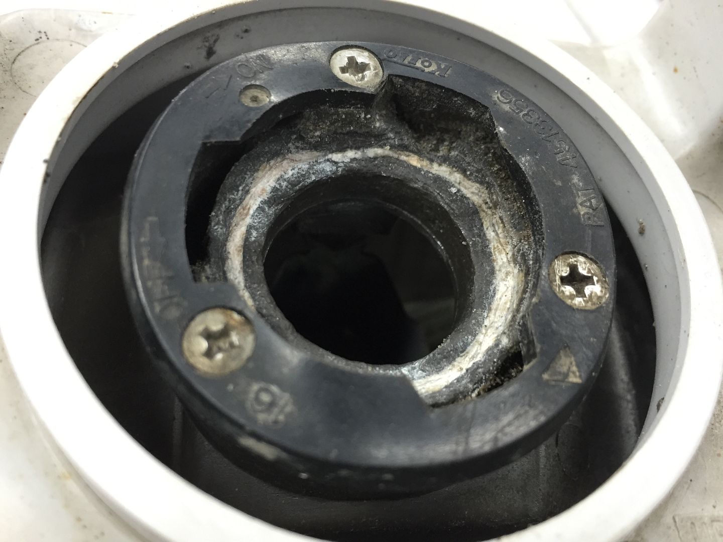

I rarely use my foglights anyway, but the other night my son noticed that one of them was out.

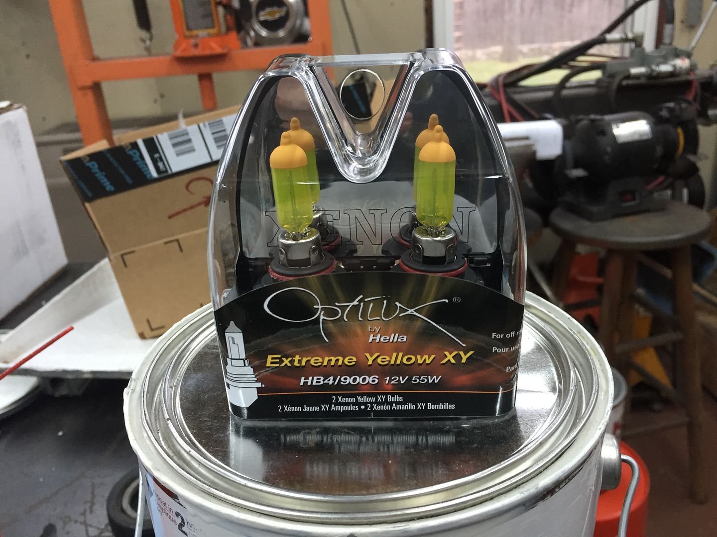

I'd made a mental note a while back that one of them (PS) had a bunch of condensation in it, so I had planned to try to dry it out at some point. I figured that it might be nice to swap in some yellow-tinted bulbs so that they would actually work in fog / snowy conditions. The pure white bulbs don't seem to do much except reflect a lot of blinding light back into the windshield.
So I picked up a set of these:
Removing the foglight housing is simple. There is a weatherpack-type connector that unplugs from the bulb socket and then a single nut retains the housing. This can be snapped off quickly with a 10mm socket.... which is what I did. :(
No worries. As it turned out, my odds of "repairing" the leaking housing were basically nil anyway... the bulb was frozen in the socket and when I finally got it removed there was a strange corrosion on the bulb-seat area that ruined any chance of a weatherproof seal with a new bulb anway.

Are you going to use the yellow bulbs you have?
I just ordered a cheap one off Amazon and that's exactly what I'm going to do; pre-emptively seal it everywhere before the install.
Yeah, I'm going to try the yellows and see if they are any better in fog/snow. The whites are basically useless in those conditions.......

How have you liked the yellow bulbs Greg?
Will you keep them in the new housings?
Well I threw the original bulbs away so I guess yellow will be just fine.... :)
Yellow seems a little better in snowstorms (less glare) but I wouldn't say that it's a mind-boggling improvement. It's cheap money for a couple bulbs so if you are tempted just give it a shot!!!
