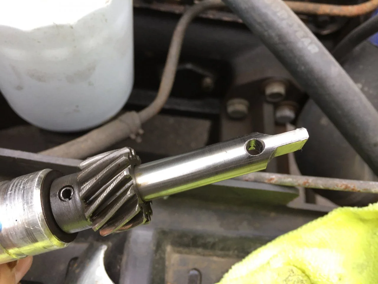

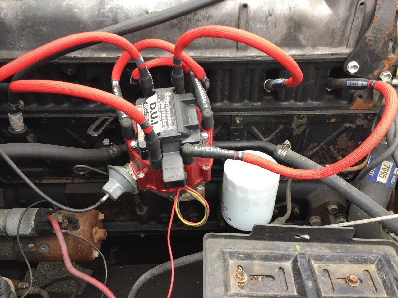

I have an DUI HEI distributor in my 40 with significant vertical shaft movement - something like 1/4 in.
Context: I had it at a shop last fall due to persistent electrical issues that kept causing it to burn out parts. They had the whole thing apart and I'm guessing didn't reassemble correctly. That amount of movement seems like more than shims, which I understand to be ideally set around .02 in.

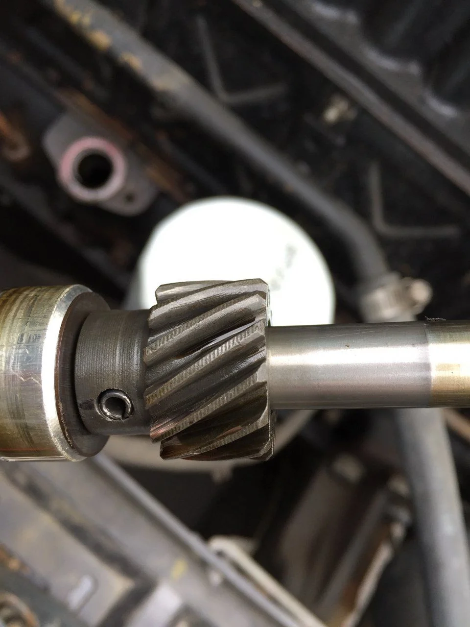

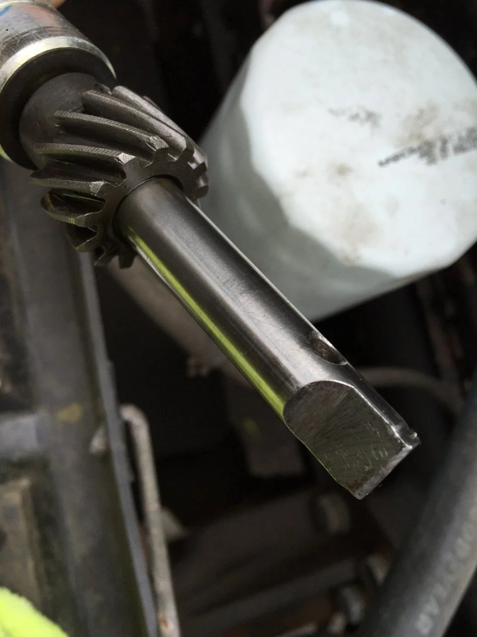

Stump saw it and noticed it appears to have wear marks at the tip of the oil pump connector as if it wasn't fully seated in the pump slot.
Thoughts?

Good input. I have an old distributor and will compare length. I did note the vertical play on the stock dizzy is almost nothing. The question on the DUI is how to eliminate the vertical play. The amount of movement appears more than an issue of shims.
I took those a while ago so didn't capture the gap, and I won't have access til Saturday. But those show a little of the uneven wear. Screwball is going to take a look. Thanks all.

What uneven wear are you referring to? The wear on the gear?

The wear on the gear is non uniform and the blade is worn oddly as well, as if it were walking up and about to pop out of the oil pump slot. His free play can be measured in fractions of an inch, not thousandths.
