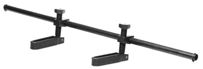

A VW/Audi overhead cam tool (sometimes w/ a few mods) works well for most of these head types.
