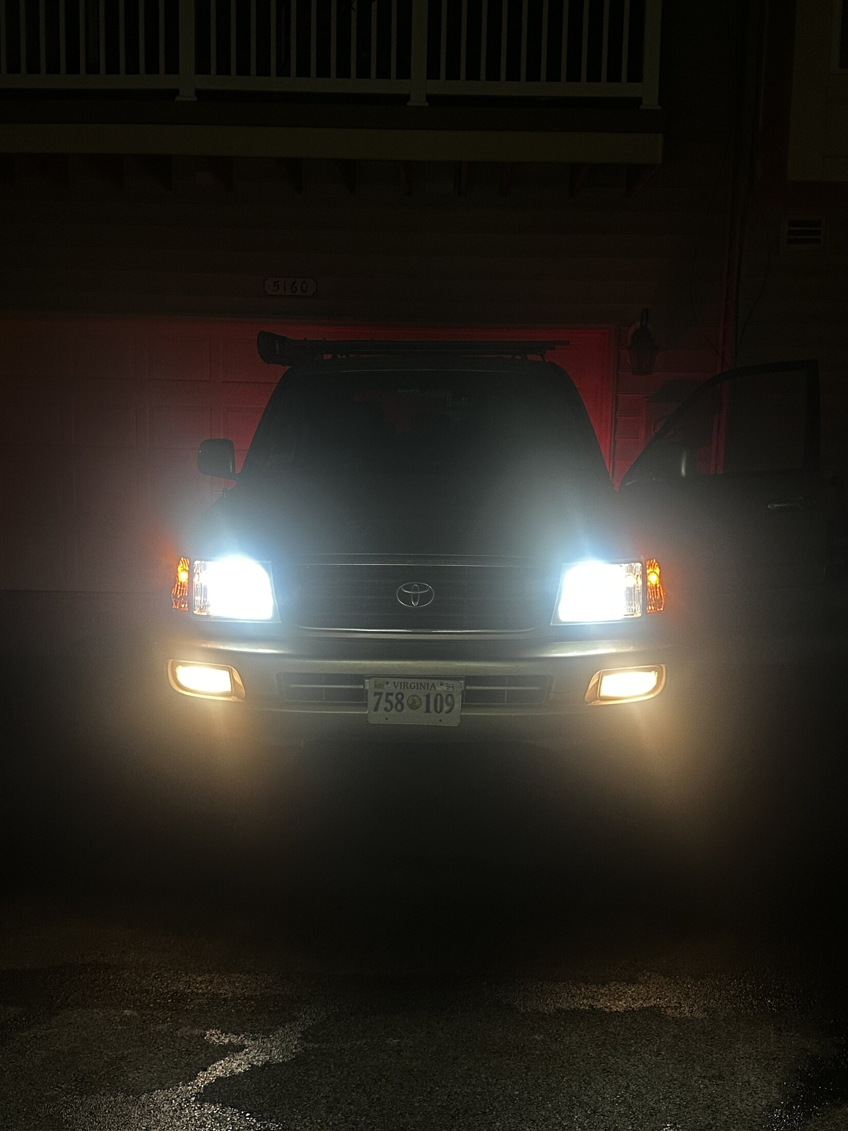

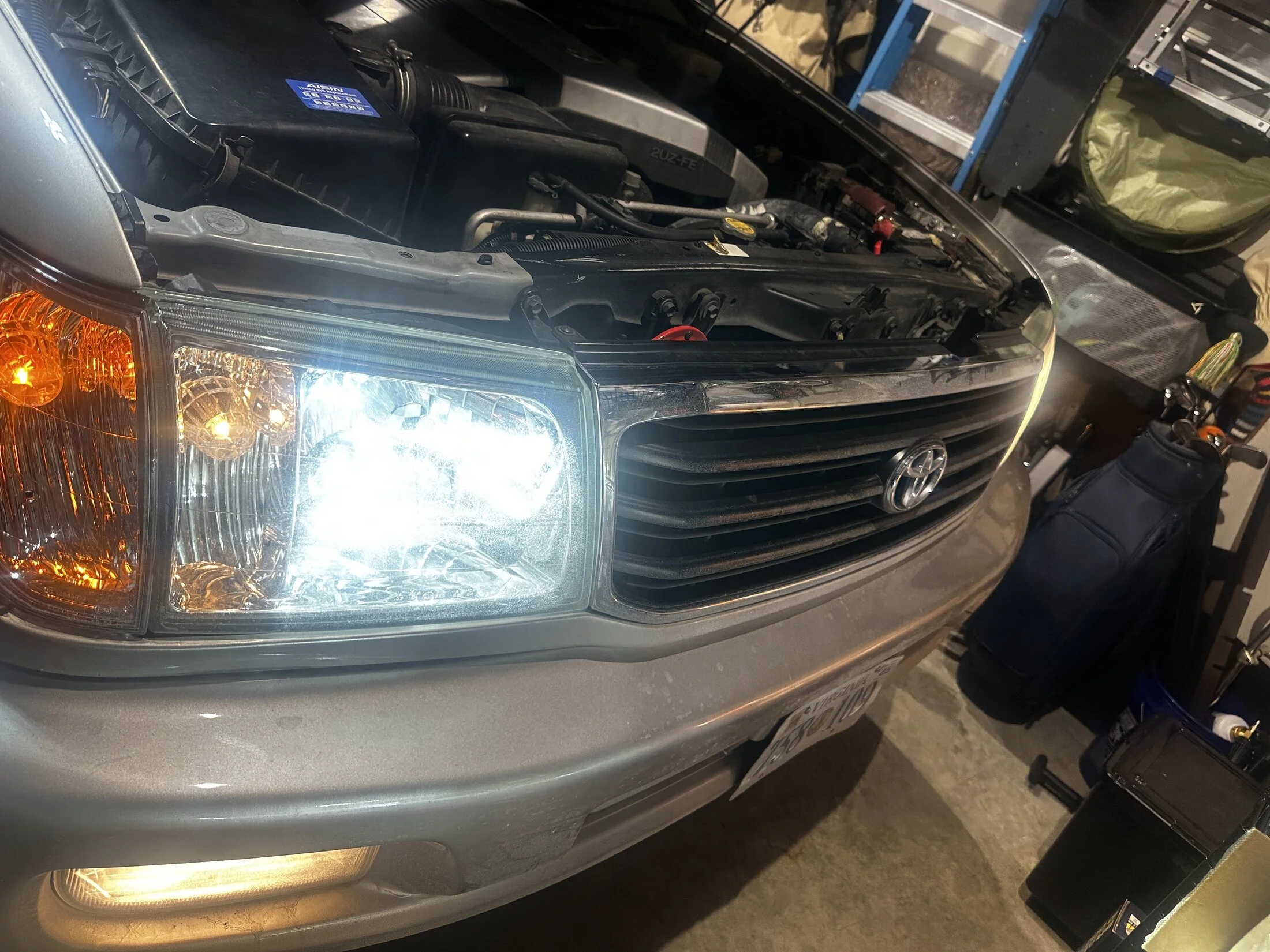

I just installed these as well and they’re great! I had no problems installing them in under 10 minutes. I didn’t remove the battery - just took off the battery strap and slid it back a bit.
I have a 98 with glass lenses.
Now to do the fogs and DRLs
The gasket ring was loose out of the box so maybe it threw off the orientation. With the three diff sizes tabs behind the housing it took several tries to get them right. I also have glass lens.
