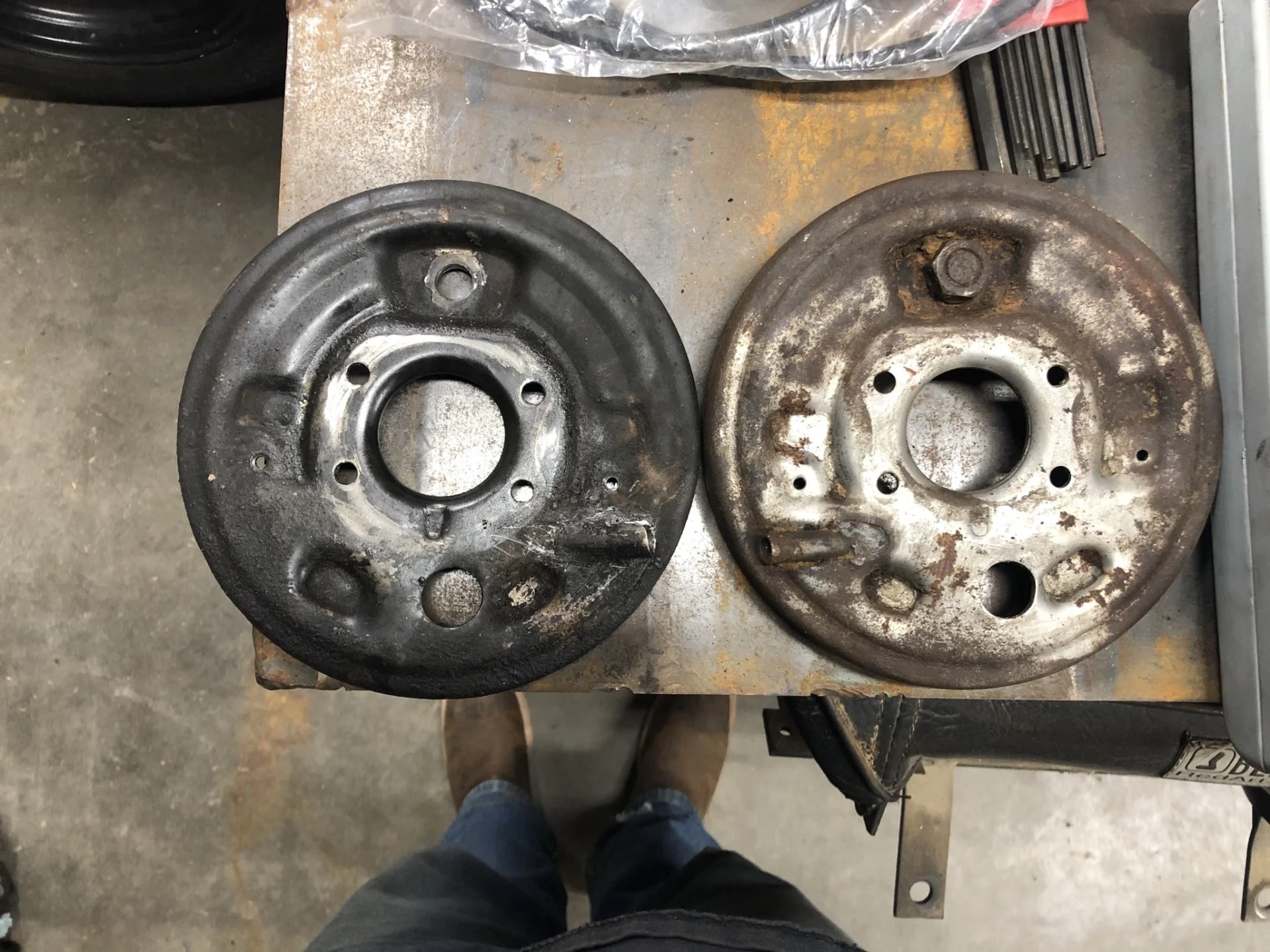

I started my truck in low gear, with parking break engaged, and the backing plate sheared the 4 mounting bolts and backing plate was damaged by the cable ripping out. Total bonehead moment.
I bought a replacement backing plate through the classifieds, and went to install this weekend to find it is a mirror image of the one i removed.
Any chance i bought a RHD backing plate? Can I just install this one upside down to get the cable inlet on the left side of the truck as it was on the original one?
last pic the one on the left is a 40/45 series
the one on the right is a 55 series
I would just get the correct 40/45 backing plate versus making the 55 one work

Thank you
FWIW, did same thing years ago, i just peened the torn edges back in and reused it, 16 years no issues. mine was torn just a hair less but almost identical result. I secured the cable back 8 inches or so as well with a fuel line clamp.

Im just going to replace it, I have a double seal housing from Valley Hybrids to go back in as well.
