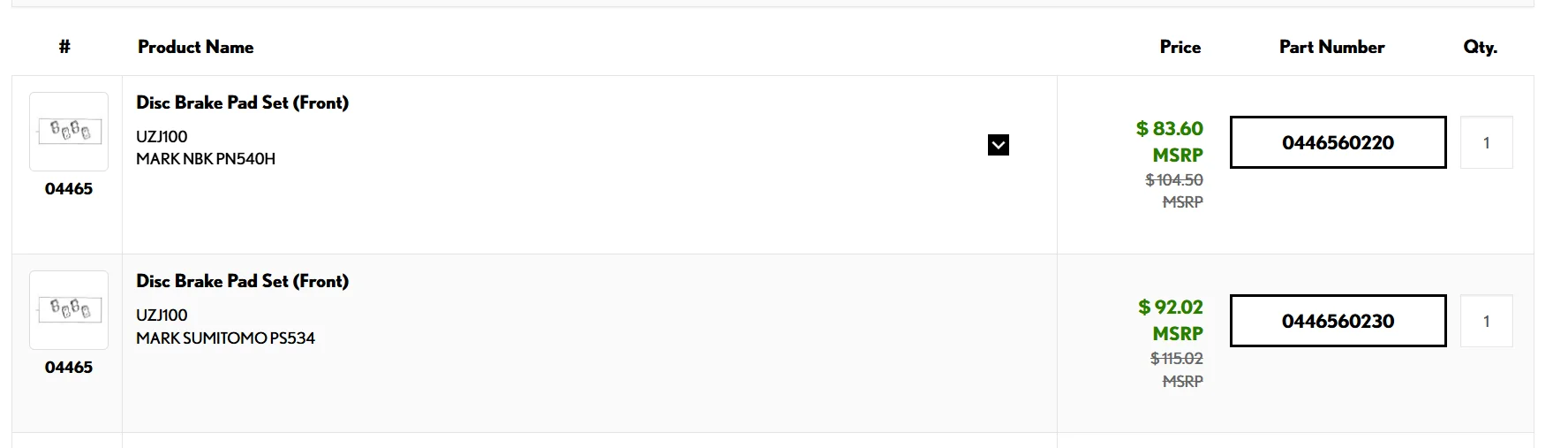

Hello,
I need to replace the front pads on my 2005 LX470 and I want to stay OEM. I have new OEM rotors, but I need to get pads and I see there are two different options:
04465-60230 Sumitomo $115.02 MSRP
04465-60220 NBK $104.50 MSRP
Why are there two, nearly identical parts available? Is there a specific one I should be using?
Last question... Are the OEM Anti-squeal Shim, Pad Retainers, and Pad Clips reusable?
FF and FG... now I'm going to go research why one is better than the other ;)
To close this out, I was previously searching for the parts using just the 2005 LX470 and it showed both... When I search by my cars VIN, it only showed the Sumitomo version for my vehicle.

Toyota designates the following years and pads. They might be physically interchangeable but the pistons in the calipers are indeed different.
03-07 04465-60230 Sumitomo $115.02 MSRP
98-02 04465-60220 NBK $104.50 MSRP
So I was a victim of Toyota's crappy online parts search. I entered 2005 so it should have excluded the earlier ones.
I'm guessing each dealer/group runs their own website(s). Which site did you use?
