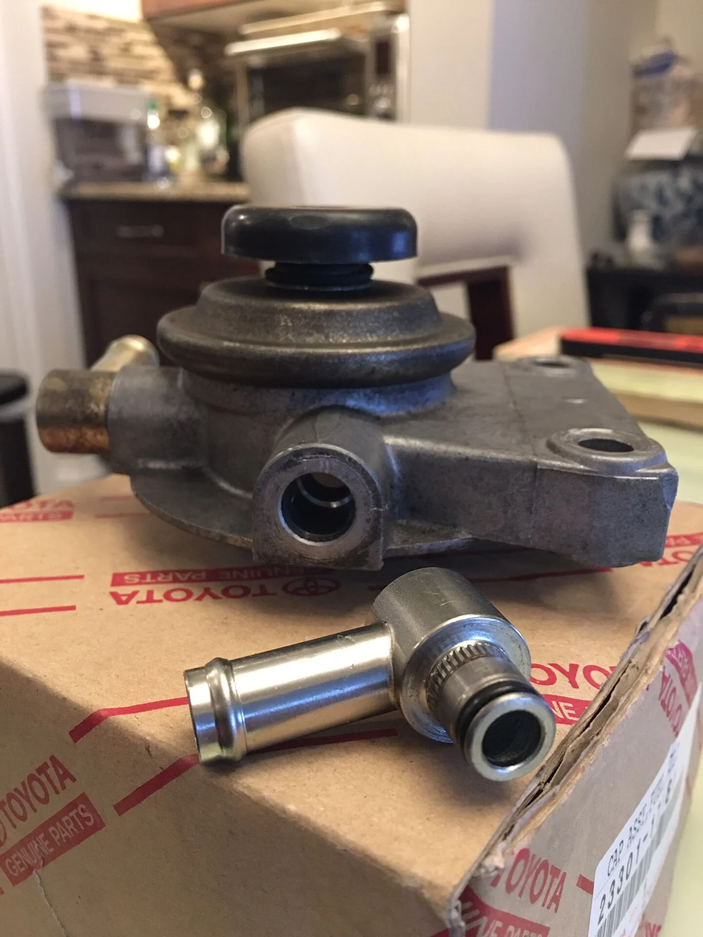

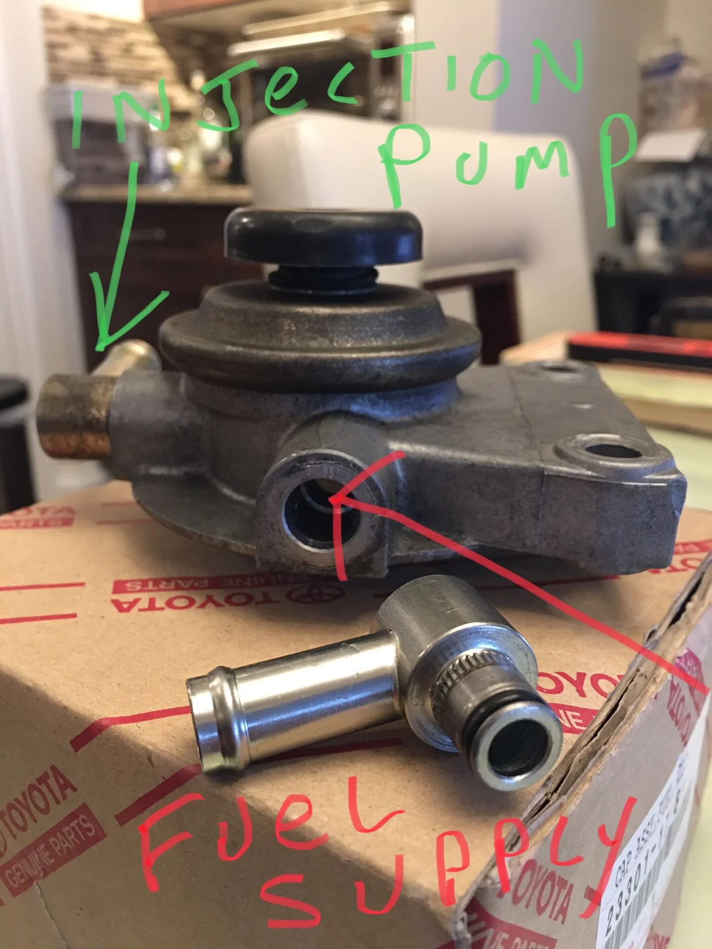

@mudgudgeon @veiloctane …sorry to ask a dumb question…so here goes
which of the ports on this housing is attached to the injection pump? Is the the port still attached to the housing in your photo? Subsequently, the one that is removed goes to the fuel supply?

If I had to guess, I'd say opposite to what you have labelled.
That's based on how they are installed in hdj80 hzj105. I think they are all essentially the same configuration, but not certain.

Easy way to find out is to pull the hoses. Push the prime and see where fluid is coming out of
Well then..I did this and it is the one labeled in green for the injection pump…so I still take a guess that this goes to the injection pump? The only thing I currently know about diesel is how to fill the fuel tank !
No shame in limited knowledge this is how you learn. I would pull one hose and pump the prime. If fluid comes out then that’s the hose that goes to injection pump.
