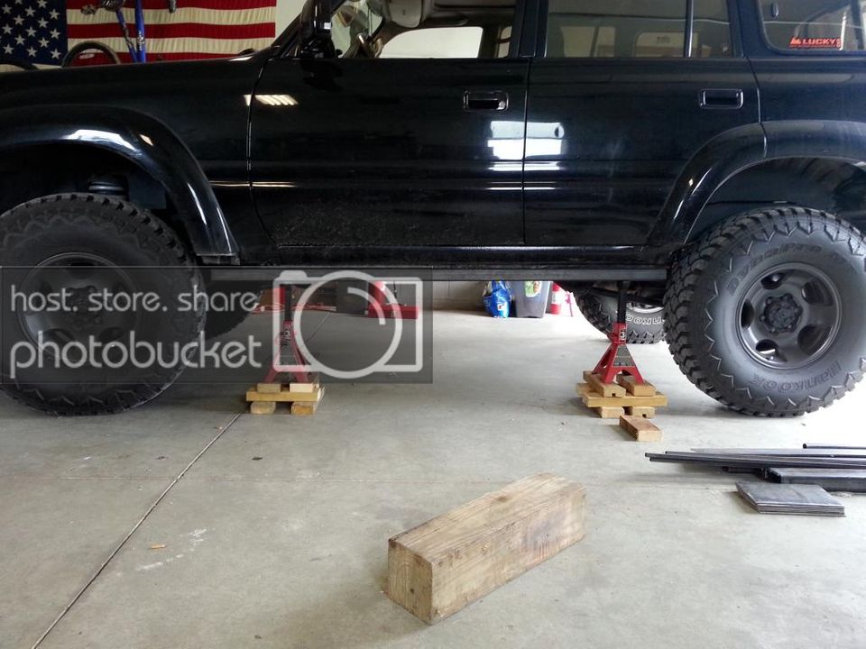

If you have any interest I could snap more photos of the rock sliders I have for more ideas.
Imo Hrew tubing shouldn't be used on sliders and if you use it keep the seem inside..
It's all degrees of strength/weight. 4130 would be better than ASTM A513, which is better than home depot pipe, which is better than paper mache
True but you should always use a material that will withstand its intended purpose... I would hate to see something fail and ruin your truck... DOM has proven itself for rock rails
