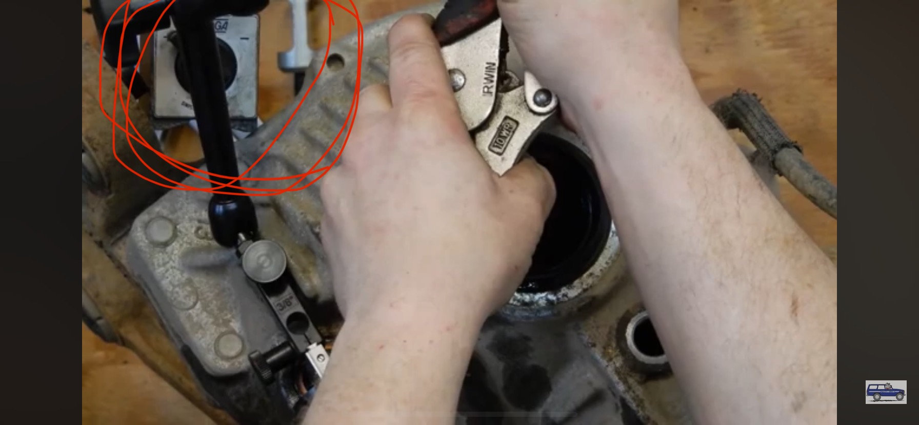

Would anyone happen to be able to identify the metallic apparatus otramm is using under his diff in the attached photos that he’s magnetized his dial/dial test indicator base/arms to?
Sorta looks like a valve spring compressor.. but I can’t see enough of it to be sure.
Edit: yep, OTC 4572 large valve spring compressor.
Thank you. I figured it was some kind of a clamp…I attempted to set my base and dial test indicator up using a pair of Vice grips clamped to a bolt back there. Looks like maybe it worked.
I need to figure out what otramm was levering against with his pry bar to turn the ring gear…then I’ll hopefully be able to ensure the dial test indicator is centered on the tooth face.

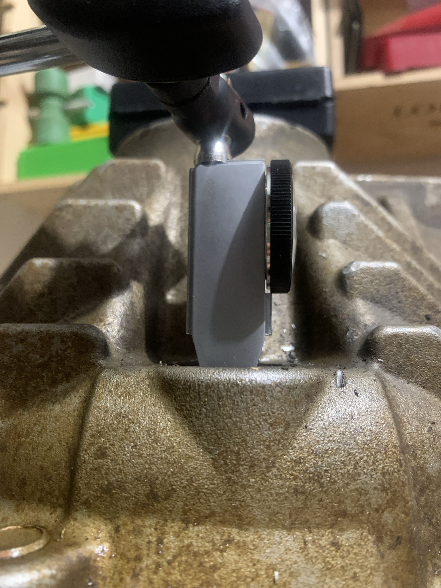

The stock short “probe” on my inexpensive dial TEST indicator made for difficult measurements since the tool essentially blocked the small opening/drain plug in this clamshell (I think) style differential case…so you had to blindly attempt to place the tip of the probe on the face of the ring gear tooth.
In one of the videos I watched in this topic it was advised that they made longer probed dial test indicators.
Amazon has longer probes to attach to any dial test indicator for around $8. The thread on the probe isn’t standard though-there are multiple available. The following probe ended up threading appropriately into my gauge…and also allowed one to see into the differential to place the probe appropriately for measurement.
I may need to do some math though since the short probe appears to be 16.55mm and the long probe is 44.5mm.

For anyone trying to do this at home, the inexpensive dial test indicator listed above along with the extended probe above appears to have made for a relatively easy measuring of the front diff backlash.
  • Otramm uses a large pry bar or chisel placed on the cross pin to wiggle the gears while disallowing movement of the input flange bolts of the diff…he appears to have leaned the bolts onto the work space to disallow that movement.
  • I used a chisel with a medium vise grip on top of it to push the cross pin.
  • Like Otramm, I placed some blocks of wood under the diff to place the pinion/input flange (if that’s the name for it) on the work surface so I could get a measurement on the face of the tooth on the diff
  • I used a large vise grip clamped to a bolt as a magnetic “base” for the dial test indicator base (it needed to be relatively large to give a large flat plane for the magnetic base of the dial test indicator to be settled)
  • I replaced the probe on the dial test indicator with a 45mm (I think) one (original was 15mm). This allowed me to see down the drain for the diff to place the probe on the tooth appropriately…you could do it without this, but this is my first time doing it and, at $9, the longer probe was worth a shot to make things easier/clearer
  • I got 5.5 hashes “swing” on the dial test indicator (which won’t mathematically be the same as what I got with a 15mm probe).
