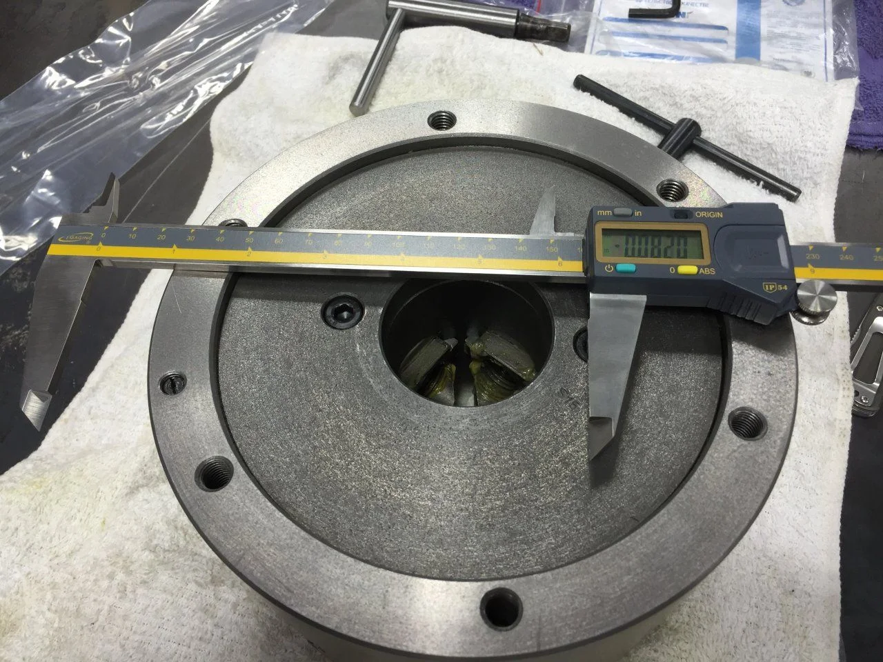

I recently purchased a 12" iGaging caliper and love it. It uses a commonly found battery (2032). The large digital readout is easy on my eyes and for the money, its a great buy. I will say my 6" Mitutoyo has not required any batteries for 34 years;).

The iGaging calipers are as close to a digital Mitutoyo as you can get but a fraction of price. I paid $70 for the one showed . They are smooth and feel right. Operating a machine shop and fab/welding shop under the same roof requires additional precautions for both tooling and machines. Both dirty but the grim and grit from the welding side can ruin a machine let alone a $70 tool.
