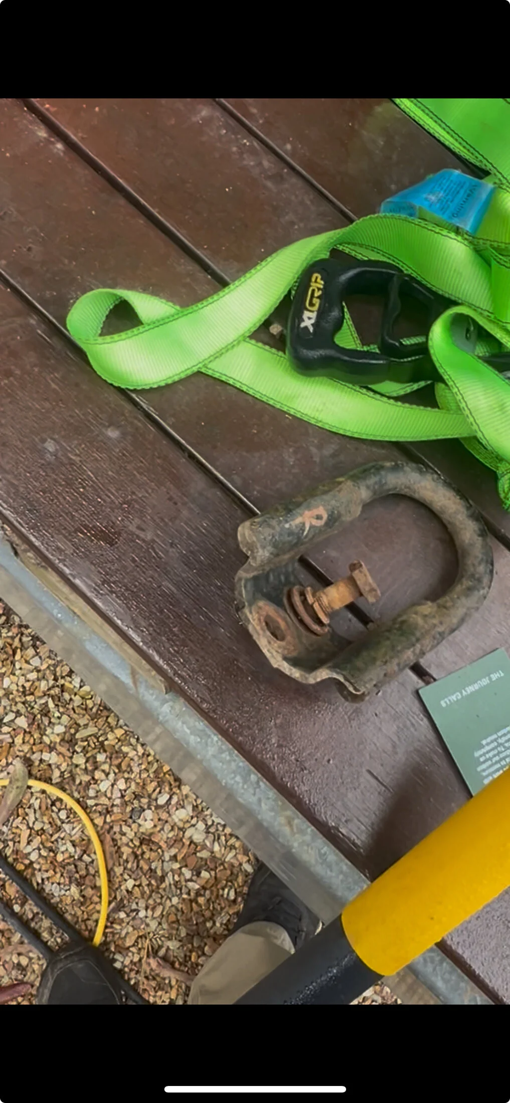

Any pointers on tapping new holes for a new rated recovery point? I've never had to tap new threads before, and its a bit daunting doing it into the body but I'm sure I can figure out how to do it properly.
While using a new titan terrain jack on my 08 sahara 200 it lowered too quickly while I lowered the vehicle + rear bar down onto jack stands and ripped the recovery bolts out. I'm surprised- the car didn't drop far, so its probably a blessing this didn't happen in an actual live incident with a snatch strap. On odd thing was that while 3 bolts used 18mm hex heads when checking both sides, 1 bolt had a 19mm hex head which means someone did something strange once upon a time to fit the rear bar.

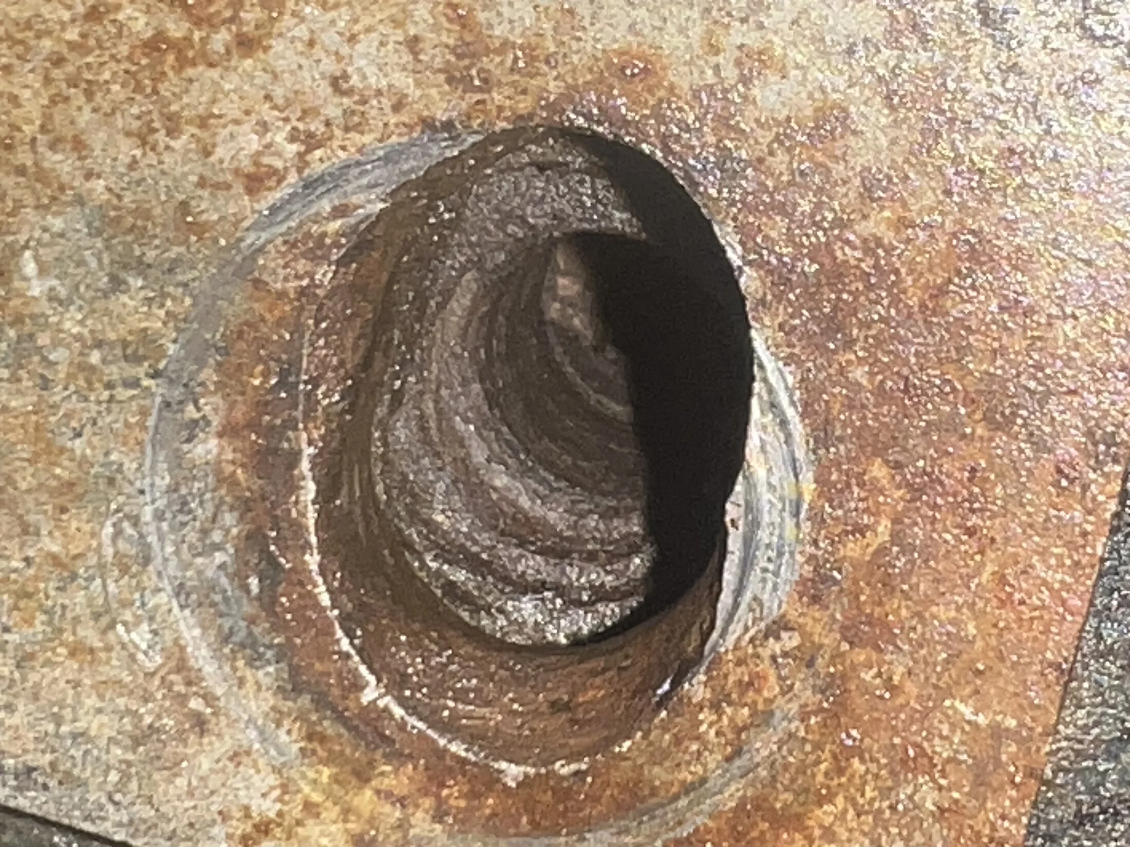

M12 x 1.25mm (fine thread). Did the bolts break in the frame? Do you have a picture of the frame? Depending on the condition they might be able to be thread-chased to clean them up (if I am understanding the problem correctly).
Yeah, something fishy going on. Maybe previously cross threaded, improperly torqued bolt then loaded, etc. The thread at the current size even cleaned up with a tap doesn't have enough meat to be reliable or safe. I would drill it out for the next size up. With the proper size bit and tap. New threads. Use up sized bolts or helicoil back to factory sized bolts.

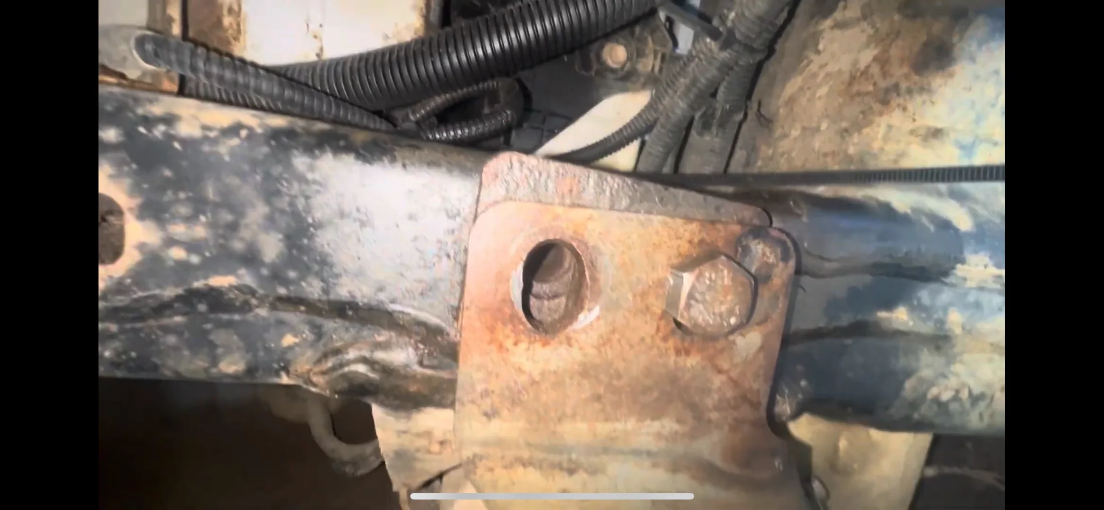

@Queglay do you have a photo of the frame?
Considering a clean bolt didn’t hold, using the existing size hole is not on the cards. I’ll get a picture today.
Does look to be 1.25mm pitch. Damaged bolt measures as 11.5mm so probably m12. I think just the bolt hex head was different. The vehicle does have kaymar wheel carriers installed, so I wonder if the kaymar kit id supposed to come with longer bolts to account for the wheel carrier plate
Can anyone confirm the original length of the thread for the bolt? I get 50mm. Hoping that kaymar supplied a longer bolt. What i don’t get is there is an extra plate between the wheel carrier and the frame.
This extra plate here under the kaymar wheel carrier has me scratch my head a bit.
The captive nuts in the frame can sometimes move. Instead of moving the nut back, maybe they just screwed in one that kinda fit but hanging by partial threads.
How can you even replace that captive nut? Looks to be well locked in place. Sure would be nice if its an option.
I have no experience with helicoils but learning now. One thing I'm not sure about is getting it flush just to where the captive nut is, and what would happen if the coil was not the right length to match.
Measuring the distance to the back of the nut to the plate, is 35 mm, nut sure about the length of the threaded section of the captive nut exactly though.
Those captive nuts don't have a lot of meat to remove. They aren't built like a typical hex nut.. more like a thread insert with a flange that is welded to the inside of the frame (afaik)
The plate is just spacer that the kaymar uses.
Kaymar replaces the oem bolt with a longer one.
Here's pics of mine and the OEM bolt

Only thing I’m also wondering as an alternative is how to replace the captive nut, would save having to do a helicoil in there.

Captive nut… you might need to just remove that then use a lollipop setup through a hole somewhere to get the female hardware in there.

Personally? I wouldn’t use helicoils in this location. Without the ability to really evaluate where they are getting installed for strength, plus these can hurt people if they fail, unlike an alternator mounting point (also for example.)
Yeah, I agree with Bloc: a 10.9 bolt and a helicoil isn't likely a strong combo. I'd suppose it may be better than nothing, if you can source metric M12 x 1.25 helicoil inserts.
Whatever solution you arrive at, Make sure you test it well prior to field use. Consider a hitch-mounted shackle for recovery in the meantime.
I wouldn't mess around trying to make those current parts work, and I wouldn't be inclined to use a nutsert/helicoil in this highly shear loaded part. You could use a long air chisel to cut off the old captive nuts and make a rectangular threaded nut plate that replaces them. A quick stitch with the mig welder could hold it in place until you get the bolts in.
