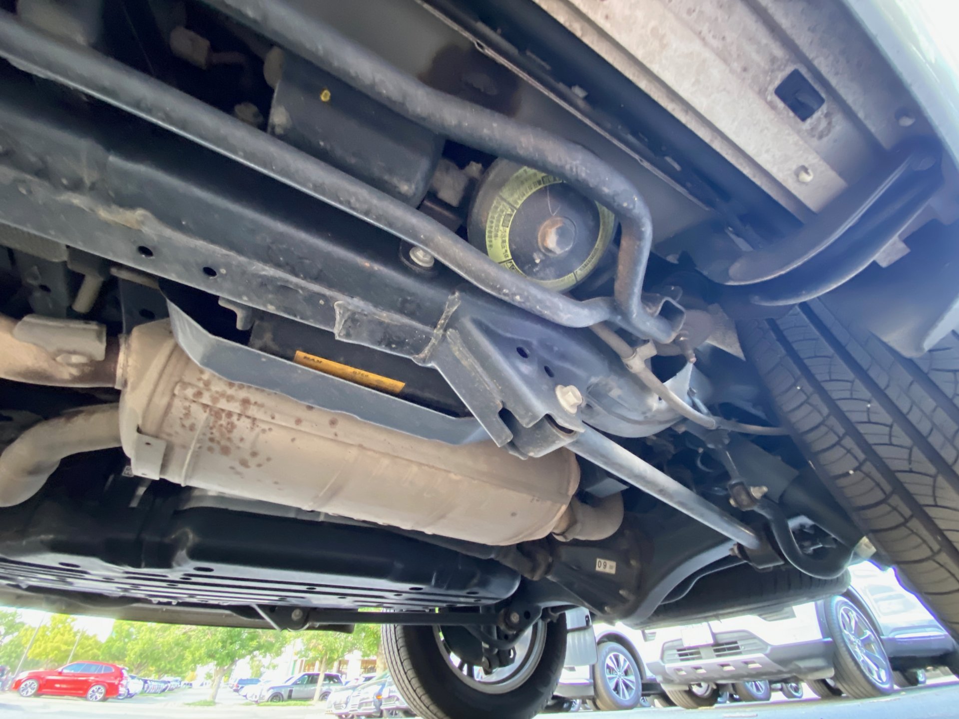

Thinking about picking up a 2017 LX570 in the Denver Area.
Is rust not an issue in Denver?
What about other corrosion to copper, aluminum, etc?
Do the roads still get hit with Magnesium Chloride here?
IME rust is typically much less of an issue in Colorado than the Midwest or NE, but mag chloride is still used here and can cause problems. More of a potential issue if the vehicle sees frequent mountain driving in the winter without periodically spraying off the undercarriage. That said, a 2017 that has spent its life in CO should be a pretty good bet from a rust standpoint.
Edit: just saw the pics, I'm not seeing anything concerning.

I’m as picky as it gets with regard to rust and that truck looks great. Texas trucks have exhaust flanges that look exactly like that.

Truck pictured looks good to go 👍
