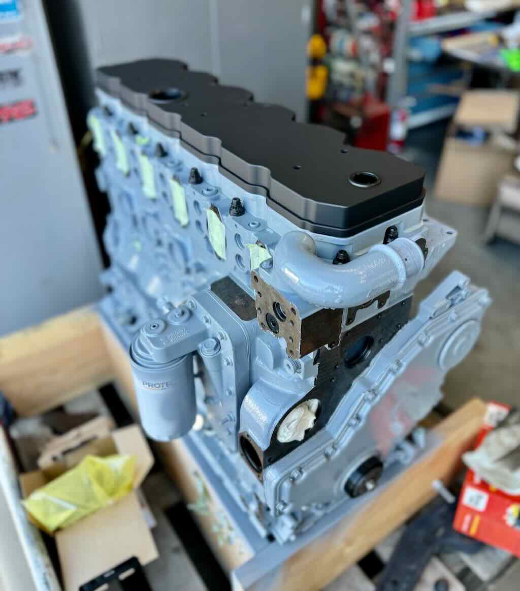

Engine one getting painted, custom billet low-profile valve cover so don't have to cut sheetmetal:

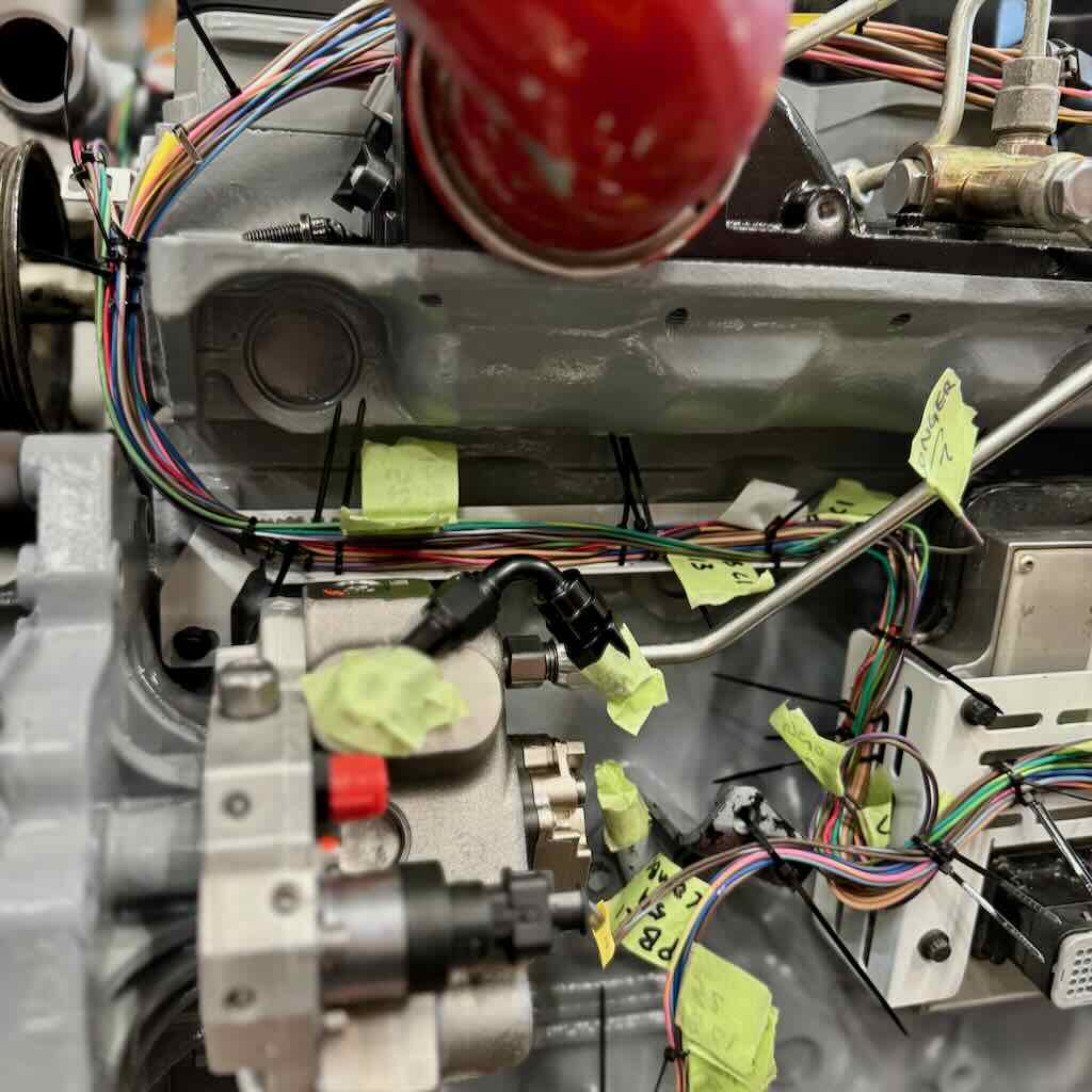

Figuring out the "from scratch" harness routing and the harness attachment points:

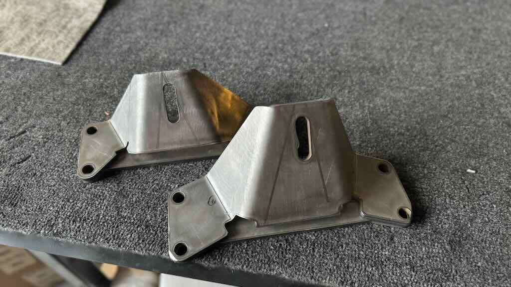

Engine mounts:

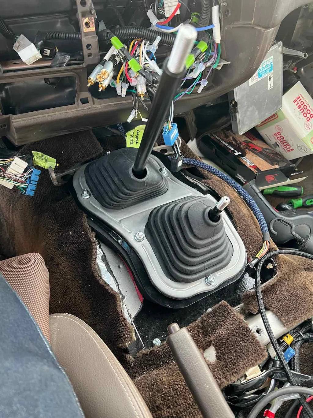

Manual shifter console adapter and guts. Uses Toyota rubbers to keep dust and sound out:
