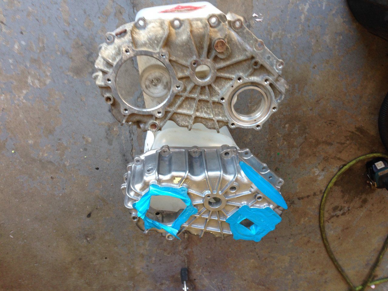

Delancy, polish or paint on the t-case, and did you polish the Alcoas before mounting the KM2s? Either way looking good. Not much room in the garage though! Never answered on A, B and C pillars on 1 tearing apart!:):beer:. Oh and pics of Mexico?
Thanks Bob.
It's a clear coat on the blasted, the polished case.
Those wheels are Alcoa's....didn't think to polish...

Plan's is stab it in today, to assess need for 60 cross.
Are you staying with stock width 55/axles and the 60 T/case?
If so how are you going to address the offset for the drive shaft angle?
Yes and I don't believe it'll be an issue.

I'm faced with the same dilemma and without offsetting the transfer case 2” it’s impossible to get the third member flanges perpendicular and inline with the transfer case flanges.
This is a short video showing my concern.
I might be over thinking it, here’s to hoping for the best!:beer:
Think we've the option to alter TC if/when the PS frame mount is changed for the 3FE motor mount, usibg 3FE to utilize the 3FE AC & Alternator mounts.
May have to push the entire engine back, a bit, to clear the fan clutch and fan. Not sure of, but may be moving things around, anyway.
Regardless, if the TC output isn't parallel to the diff output, can shim the rear to point at the TC and use a double cardan joint at the TC.
If it's not in either plane, as long as it's off by a minimum of 2 degrees in any direction, can use a double, double cardan shaft.
Not first choice, so hoping to avoid either.
