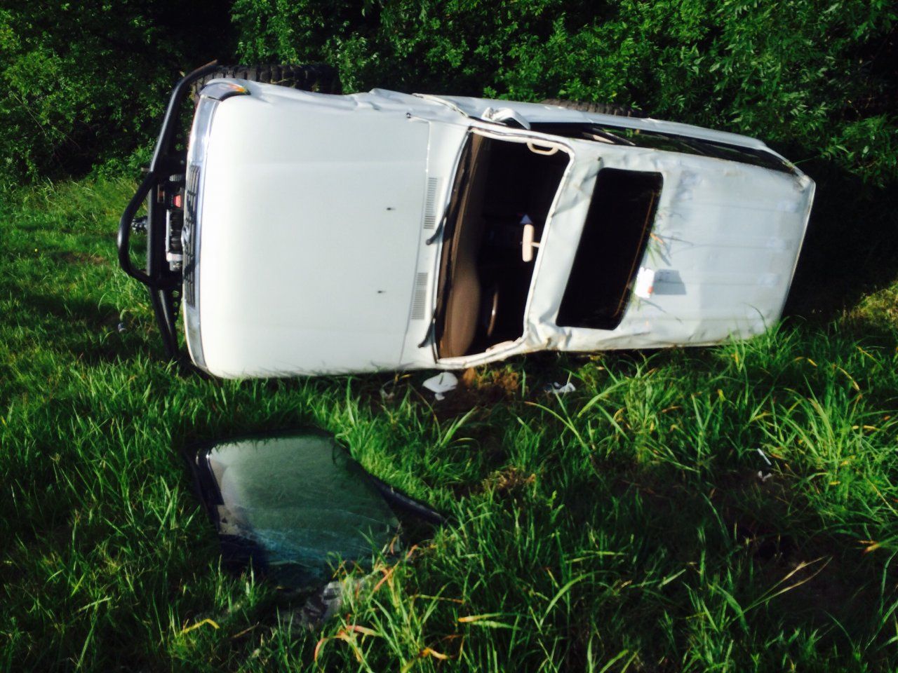

Que? What happened?

A stated in the 80s thread ... That sucks. Glad you are OK.
Re the second pic ... Looking sexy there. Justin Timberlake has nothin on you ... You're brining sexy back!
