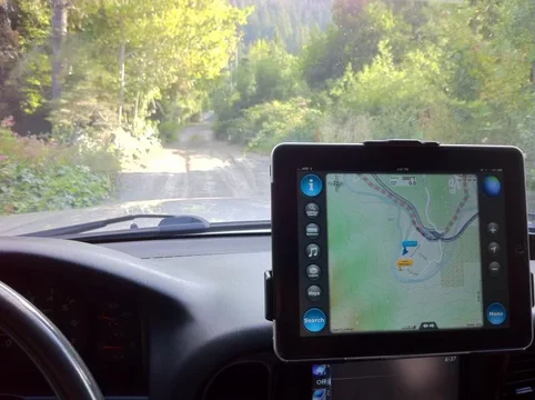

No, quite the opposite actually. I've had the csx for a long time, but want more screen real estate. The iPad 2 w/Motion X is nice, but still not perfect. Honestly, it's a awkward stage in the technology right now. If I were to bet, I'd say that AppRadio (or similar) is somehow going to win, just a matter of time. Until then there is no perfect solution.
