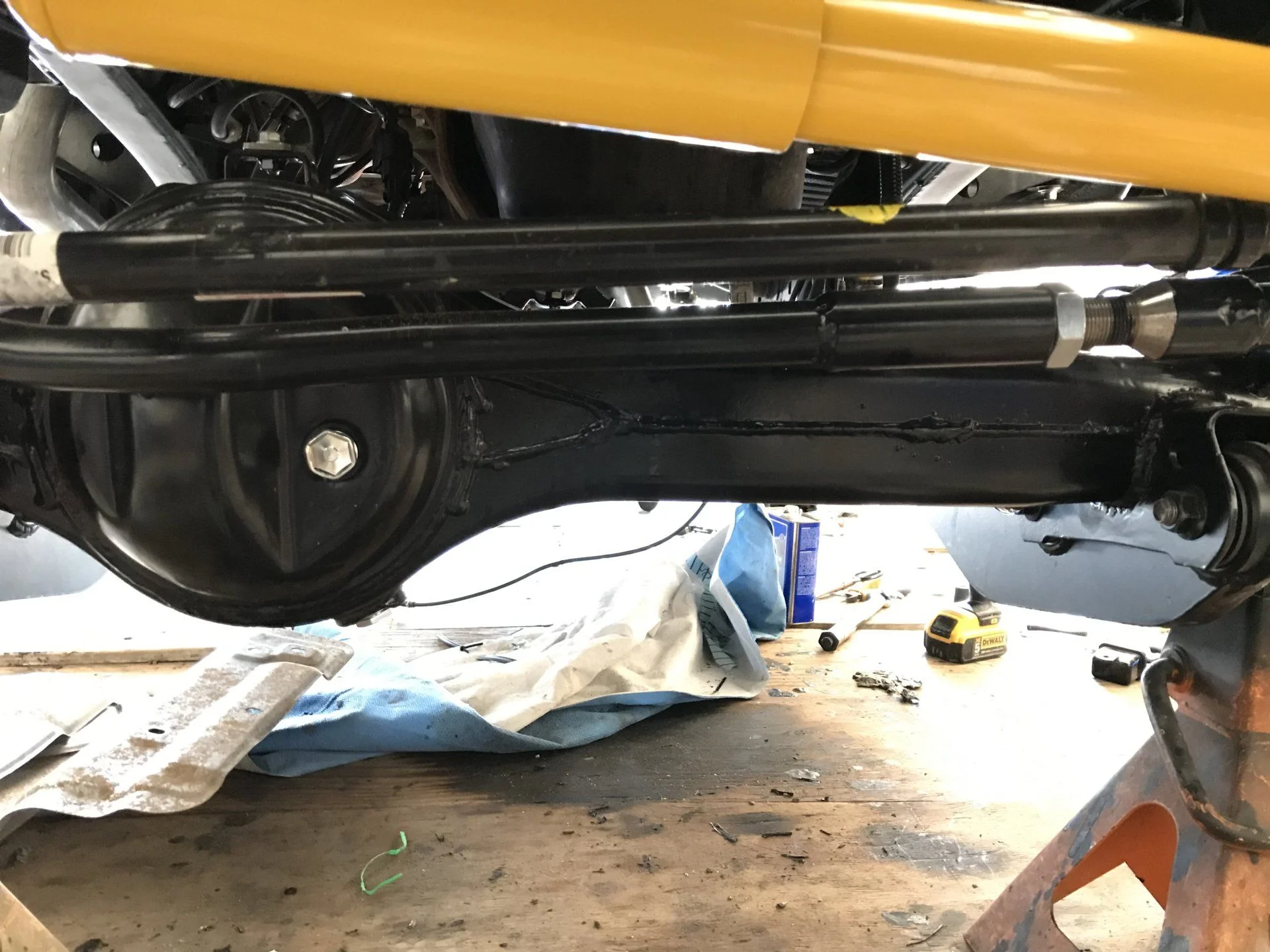

Death wobble, KZJ78
Here is a couple pics,
This is 2007+ 70-series.

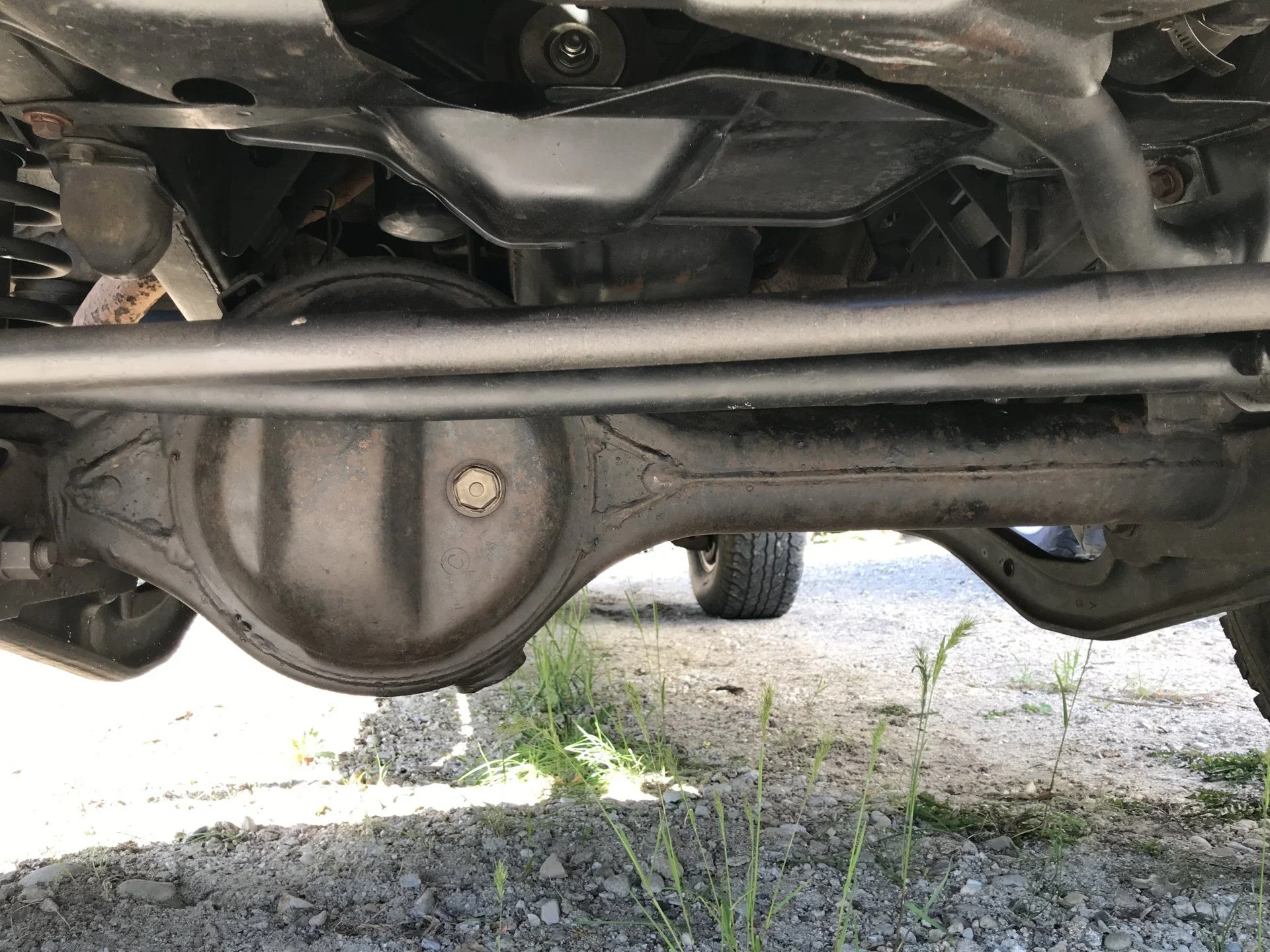

This is a stock 92 Prado.
