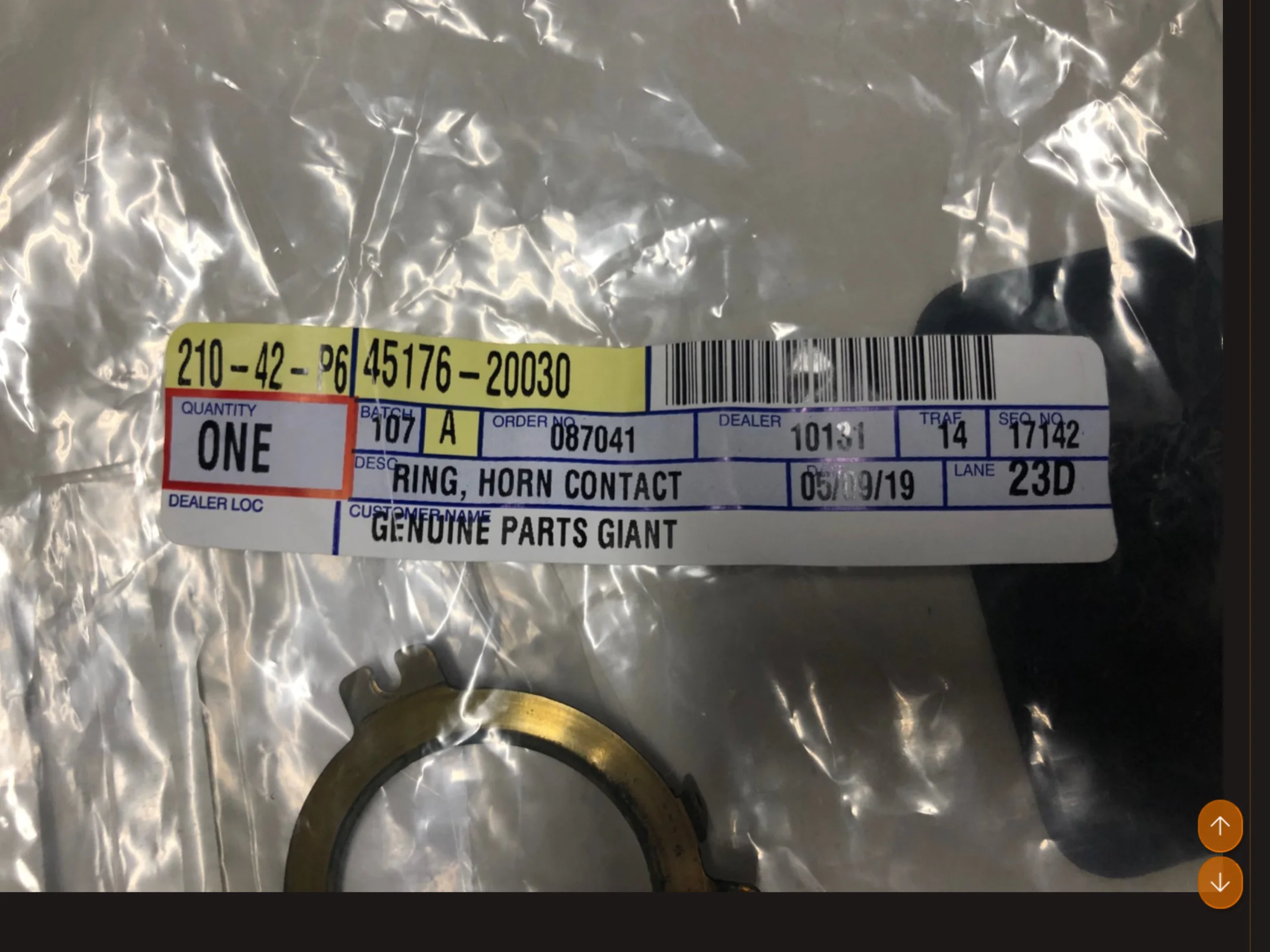

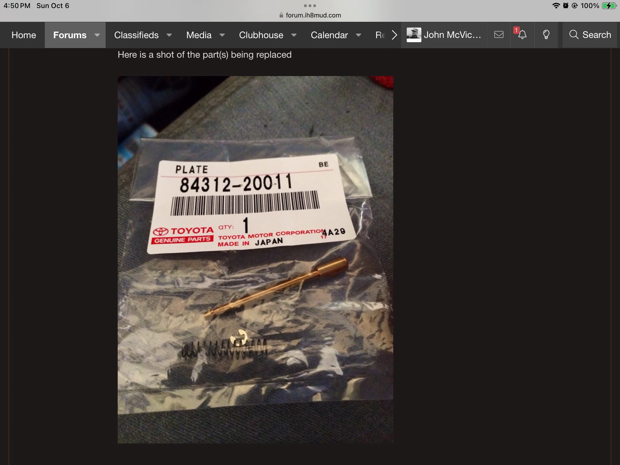

Pull the steering wheel & replace these 2 parts.
The new pin is on the left, old on the right…you can see how worn down the pin is.

My bet is you will need the parts I suggested, but it’s very easy to pull the steering wheel & access them before purchase.
You do not need to have a steering wheel puller in order to pull the the wheel. Very easy w/o.

my WAG is to take @John McVicker advice and change the brush and contact plate
but as stated above, remove the steering wheel and ground the brush, that should make the horn activate to make sure that is the issue

See post # 4 & solve your problem…long term fix…10 years + and about $20.
