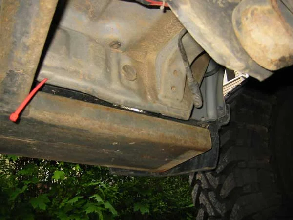

The other place to look is along the edge of the body, under the doors, on the frame rail side of the truck. You will see drain slots there, maybe the size of a quarter, 3 of them or so. If this truck was wheeled, they might be clogged.

in this one you can see the hole for the sunroof that i chased with some wire as well as a ziptie in one of the slits (heh) along the body.

I looked and looked but I don't think I have these drain slits... (as seen in the other thread) or I'm looking in the wrong place.
attachment.php
They may be Duralined as it looks like when they duralined the flairs they did the lower rockers underneath as well. Might just need to drill a few small holes.
