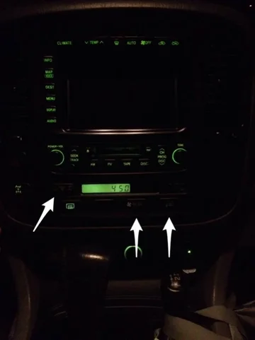

Could you guys tell me if the following buttons should light up? I'm trying to determine if I need to order bulbs for the antenna, rear air, and mirror heater switches.

All 3 should light.
Steve
Ok... I'm going to order the bulbs before I tear into the dash. Thanks again guys!
They light up in my 2001 LX if that helps.
Pretty sure they are T4's
Is your hazard light out too? That's a T4 for sure!

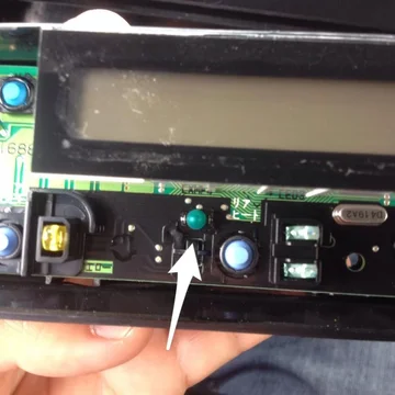

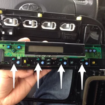

I finally had the time to tear into the dash only to find I didn't have the correct bulbs.
Would anyone happen to have the part numbers to the following bulbs?
Thank you.
You can get these t3 & t4 bulbs at your local parts store for less than the dealer. t3 = 3mm and t4 = 4mm diameter bulb. I used these bulbs from my local Napa:
600-0103 bulbs (3mm)
and
600-0107 bulbs (4mm)
If the plastic bases don't fit, just swap them into your OEM bases and re-use the green covers.
