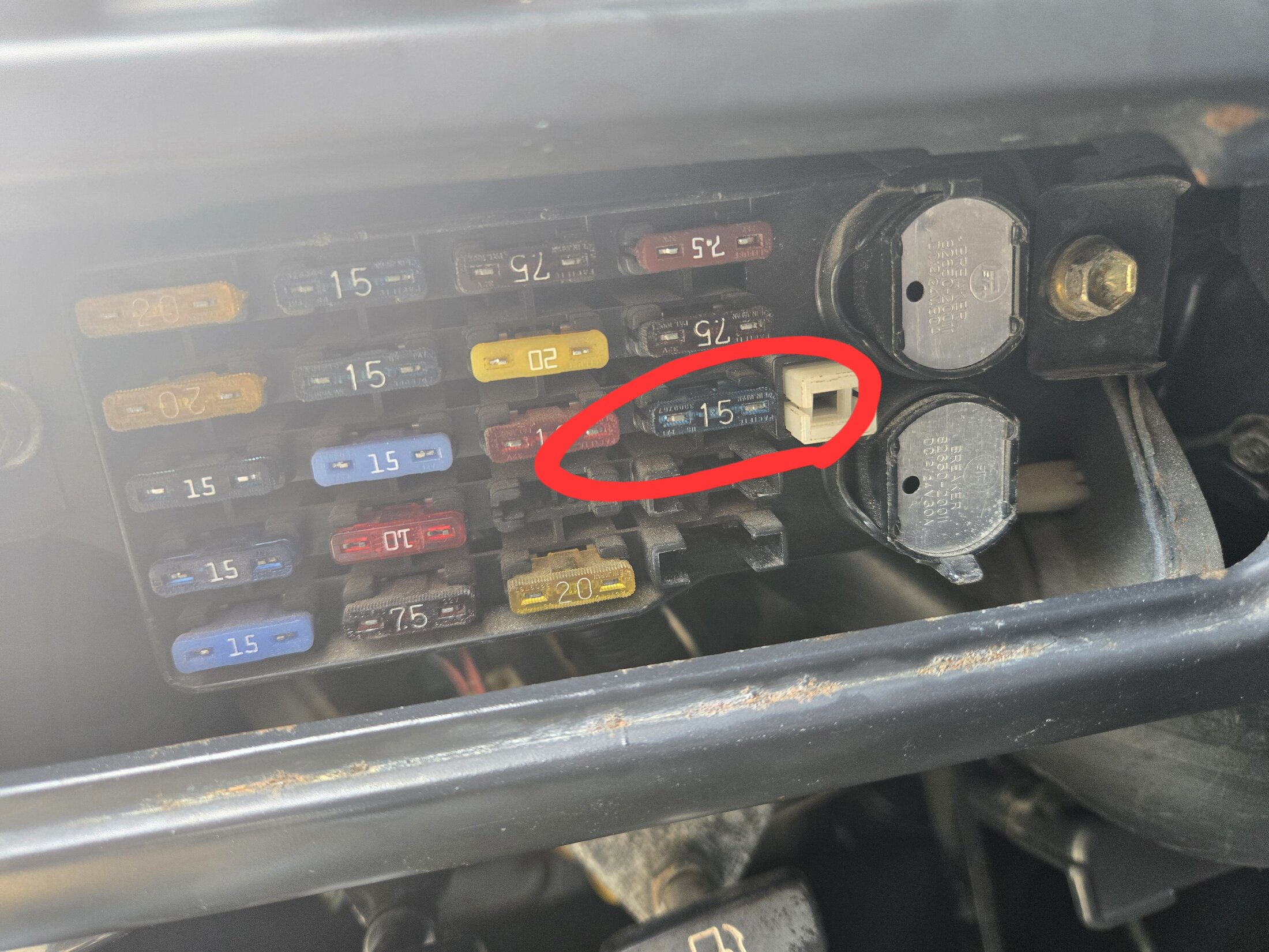

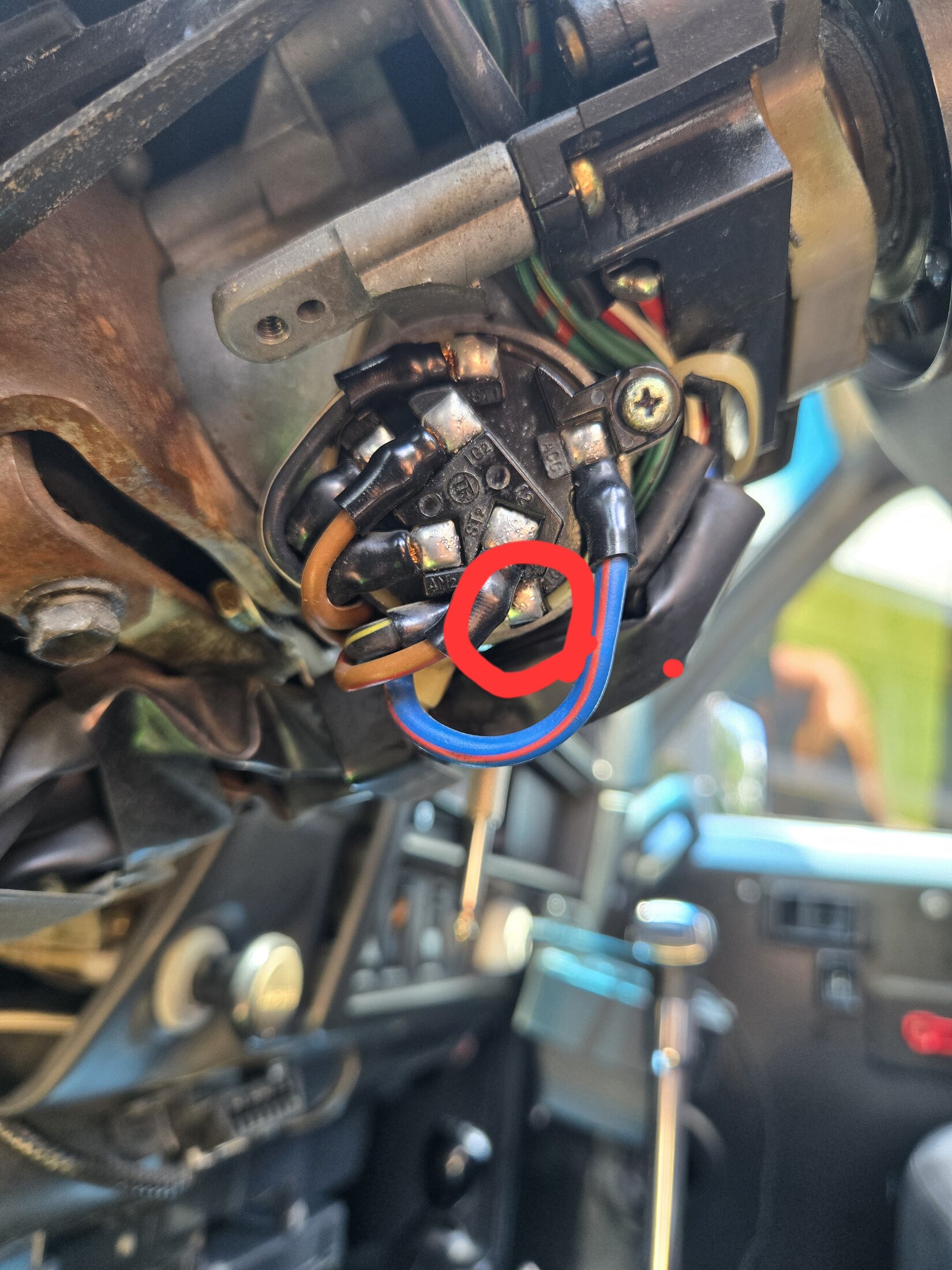

- what is the RED ⭕ mean around the
10ga Primary Black w/ Yellow Tracer stripe IGN. KEY ON solder joint-point back side of your OEM TR rotary ?

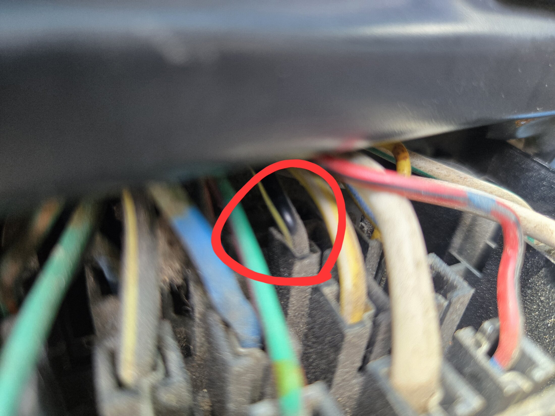

- What is the
from-location on the other end now fine with 12v ? : if I pull the dash fuse and feed 12v direct from the battery, its fine. Voltage stays steady and the battery gauge does not move.
- more then 1+ additional ( :wrench: same very A+ status-level :wrench: ) tech pics of the above , posted below would help much here .....
thanks
