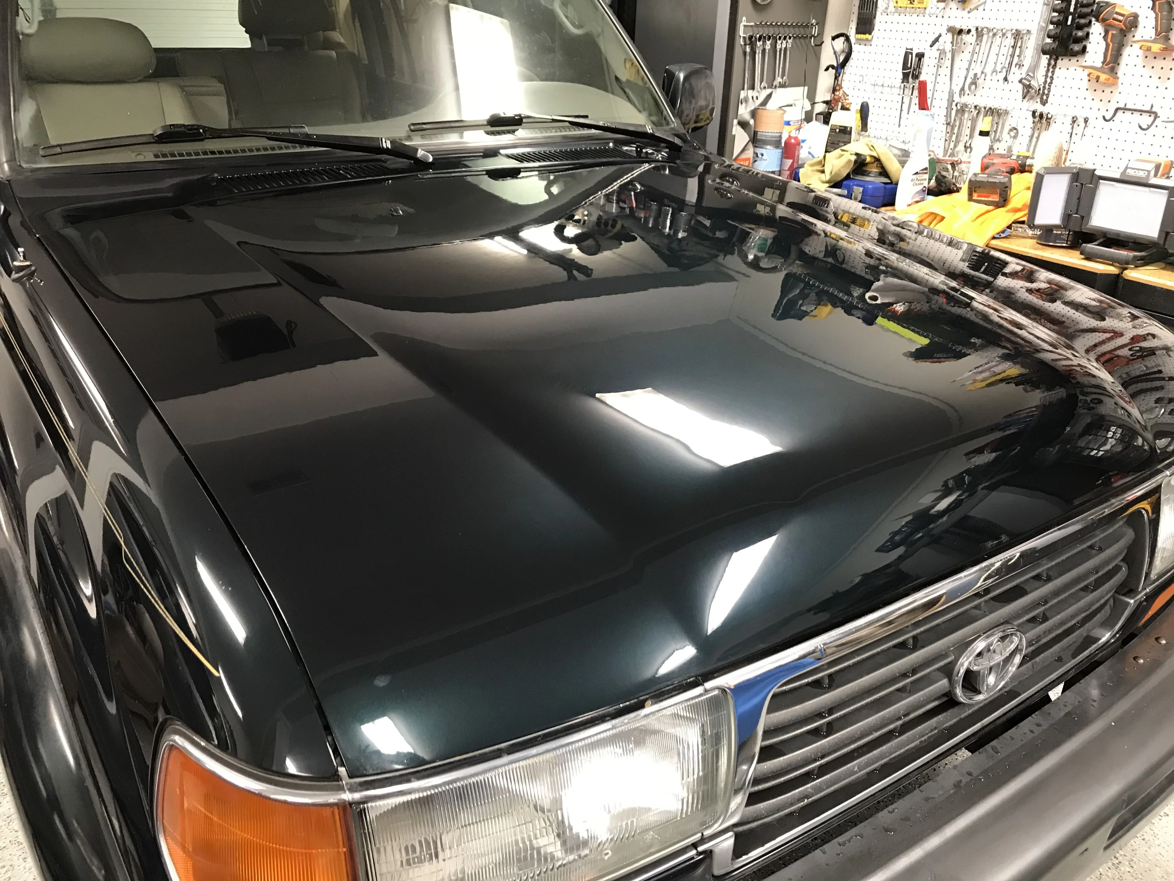

Would recommend some serious commitment if you want to try this at home. PITA! But won’t have gloss coat peal for a while.

It’s three part primer, color and gloss. Shot with air compressor and gravity feed air gun. Got the paint from Www.automotivetouchup.com

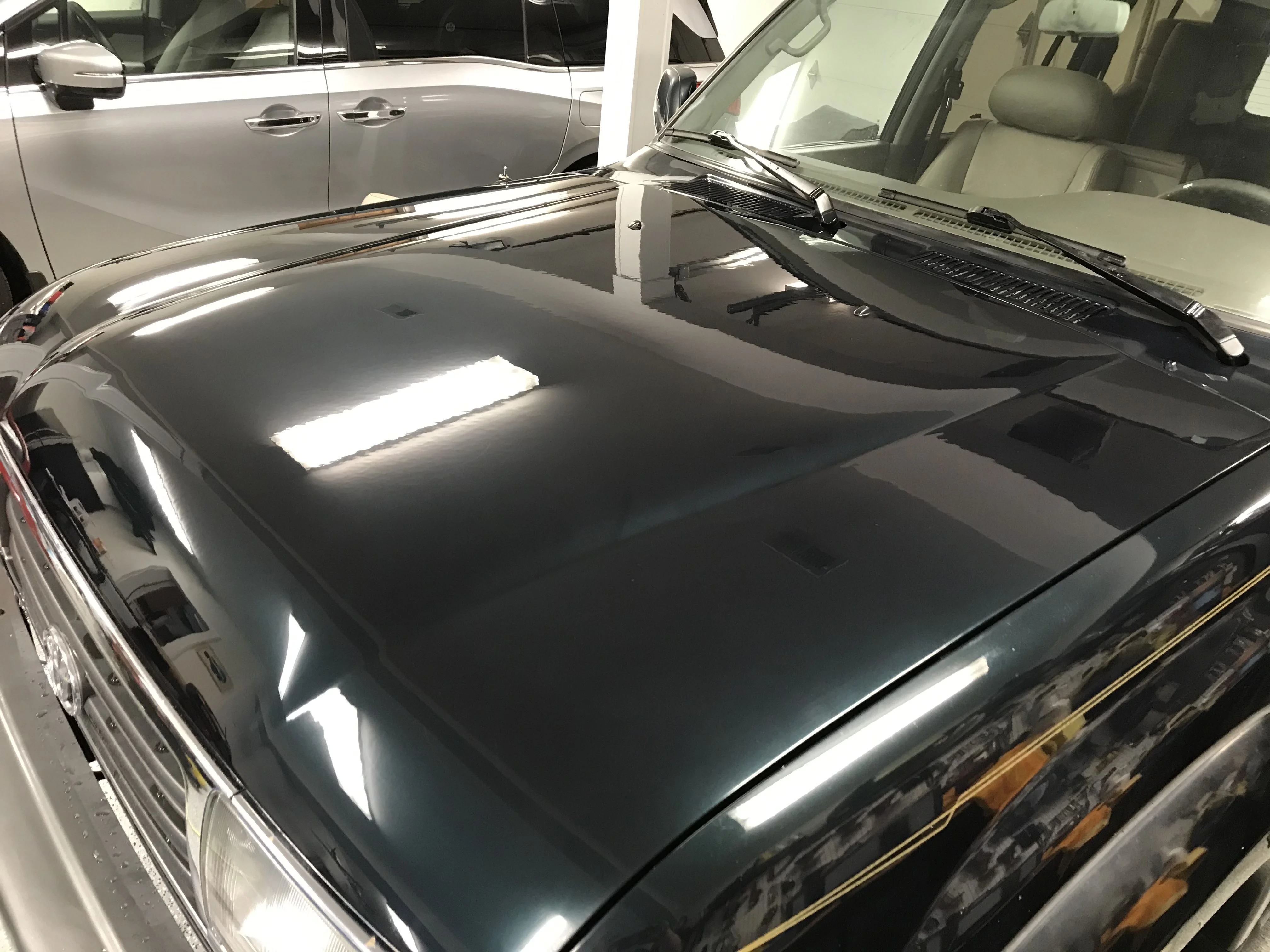

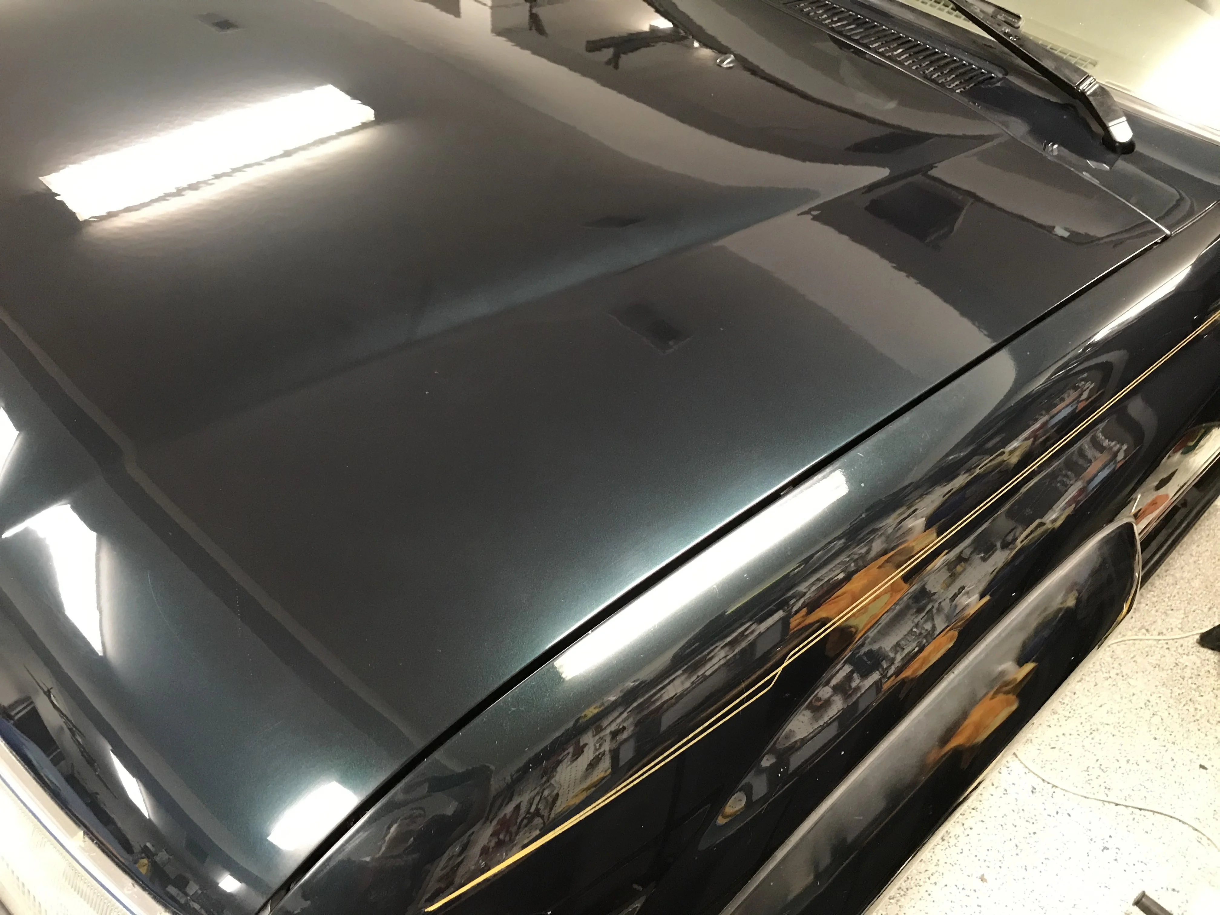

Took 2 quarts of primer, 1 quart of color, and 2 quarts of gloss to lay down enough for good coverage of hood and rear upper hatch. Color match is good. Looks slightly darker but believe once I buff rest of paint on truck we’ll be good.
....I can also tell you if I go for the roof(also gloss coat failure) I will not be doing a back to bare metal paint removal. The factory paint is sealer, primer, thick color and then gloss. I’ll sand off the gloss and color and go from there...if that. That stuff was solid after 23 years! ...and it is the roof anyway.

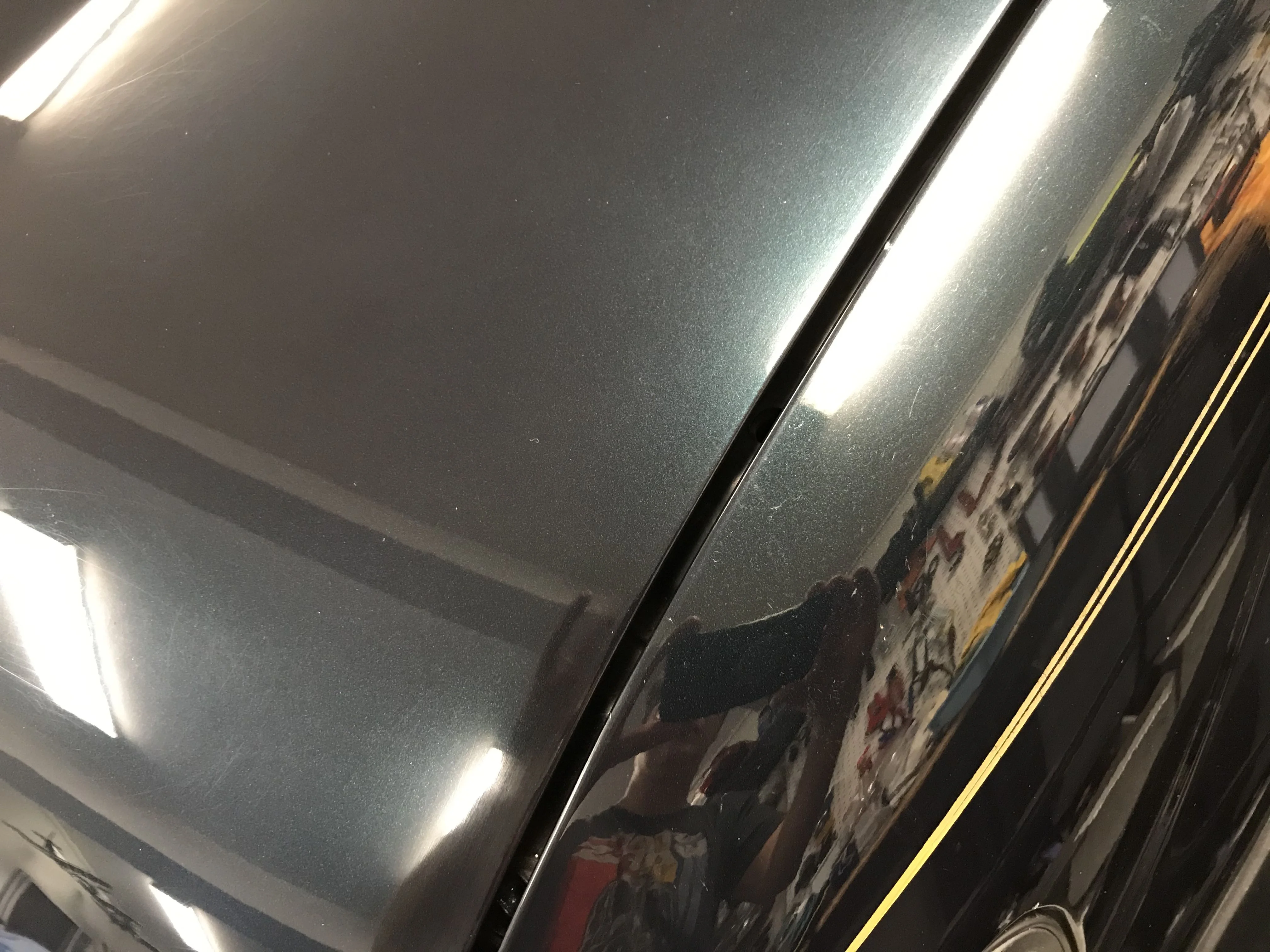

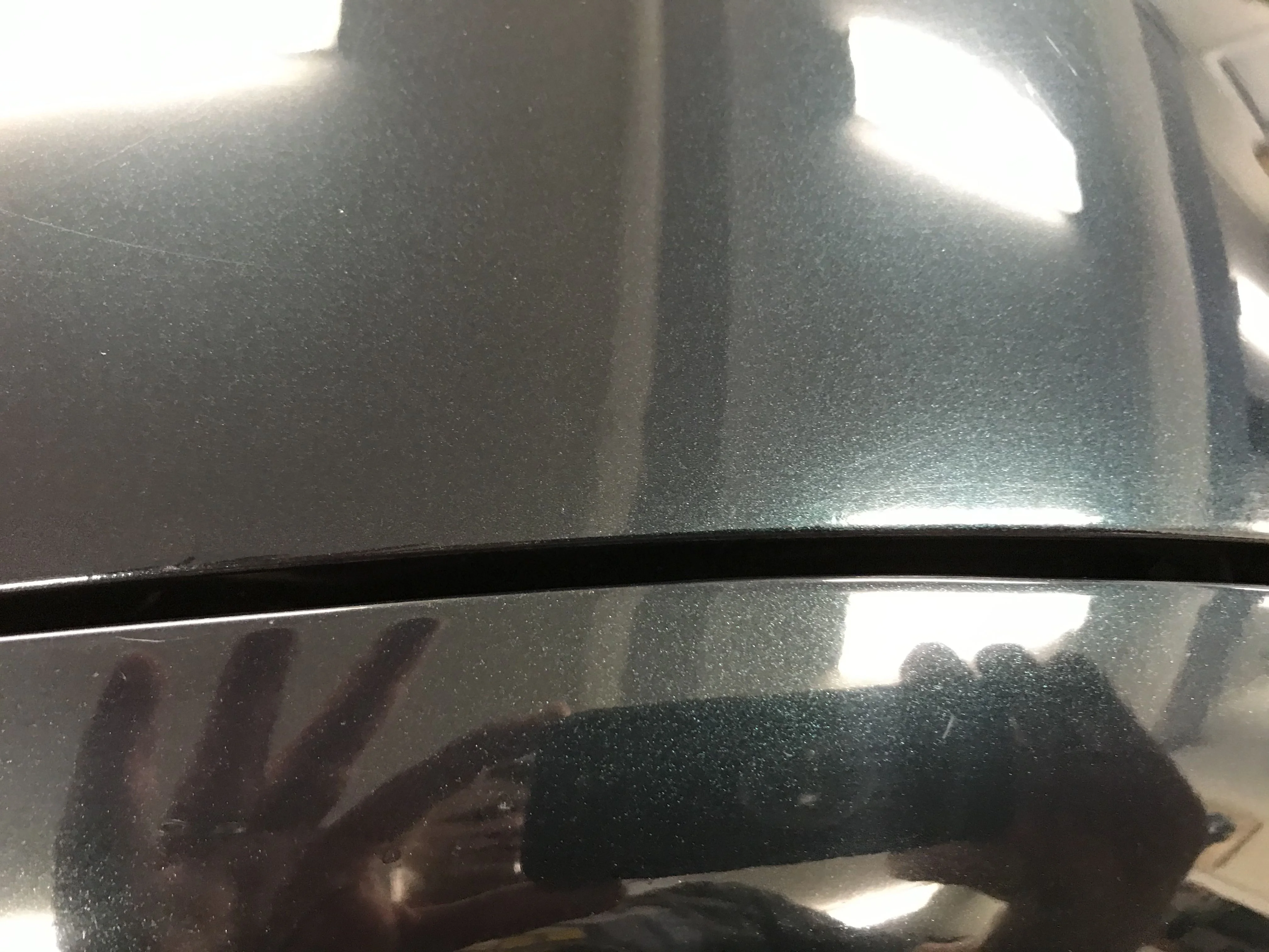

So the final on the hood ain’t perfect but certainly good enough to hurt one’s feelings the first time you scratch it. Automotivetouchup.com 6M1 is a spot on match. Hood is repaint. Fender is factory original.
