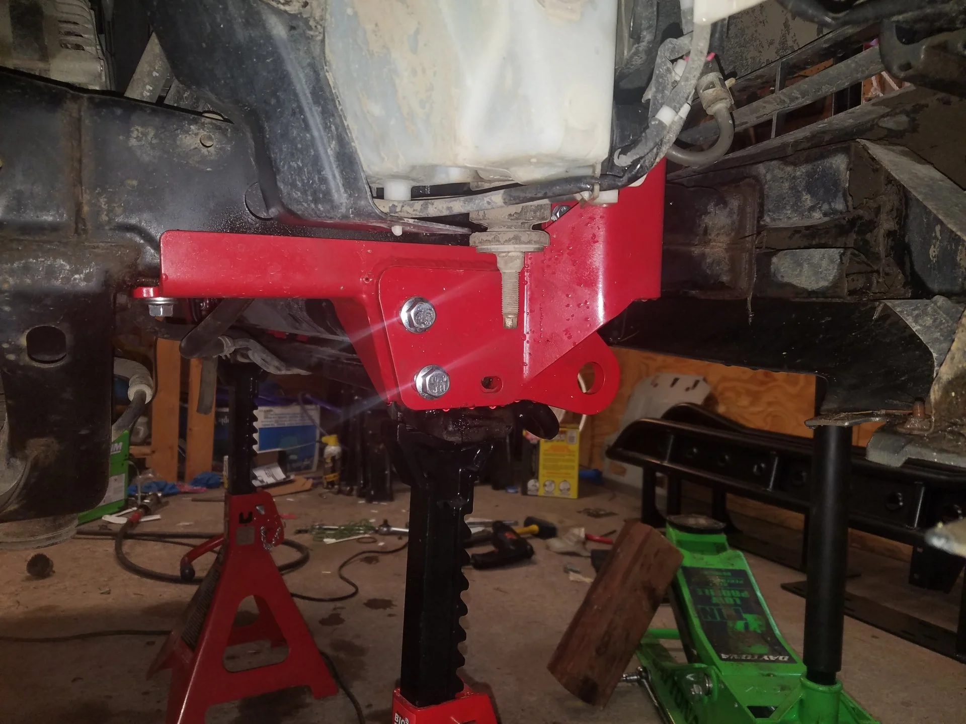

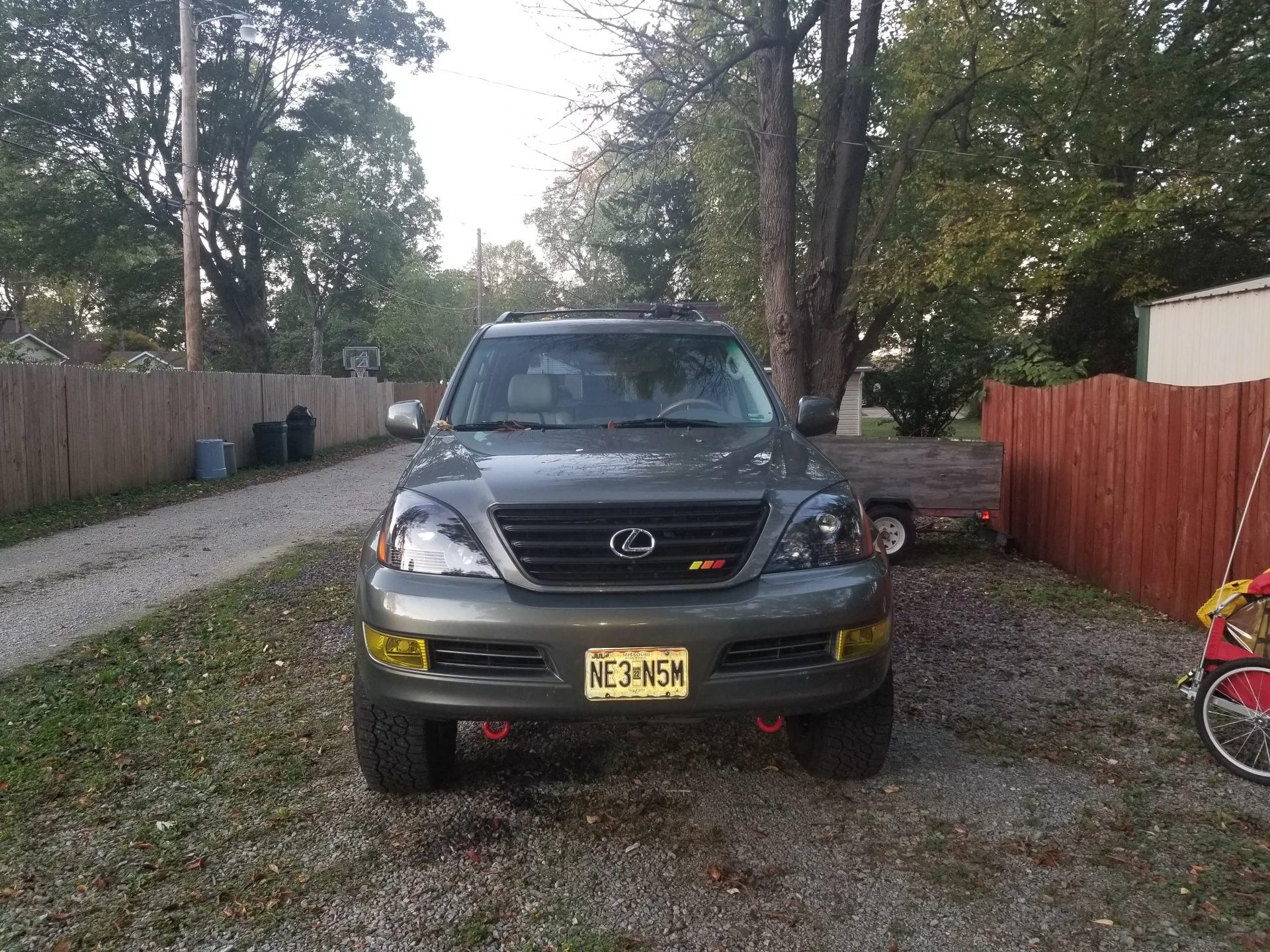

You'll need to add a pair of front recovery points to mount the shackles. There is nowhere on the OEM front frame area where you can really mount them otherwise. I have SRQ Fabrication recovery points, and they are very beefy and reasonably-priced (plus easy to install). They come raw so you'll need to rattle-can them (I also chose red). After that, you'll have a nice, secure area to mount the shackles where they are visible. I have yet to actually use mine but would have no qualms about pulling out another vehicle (or getting pulled out myself).
