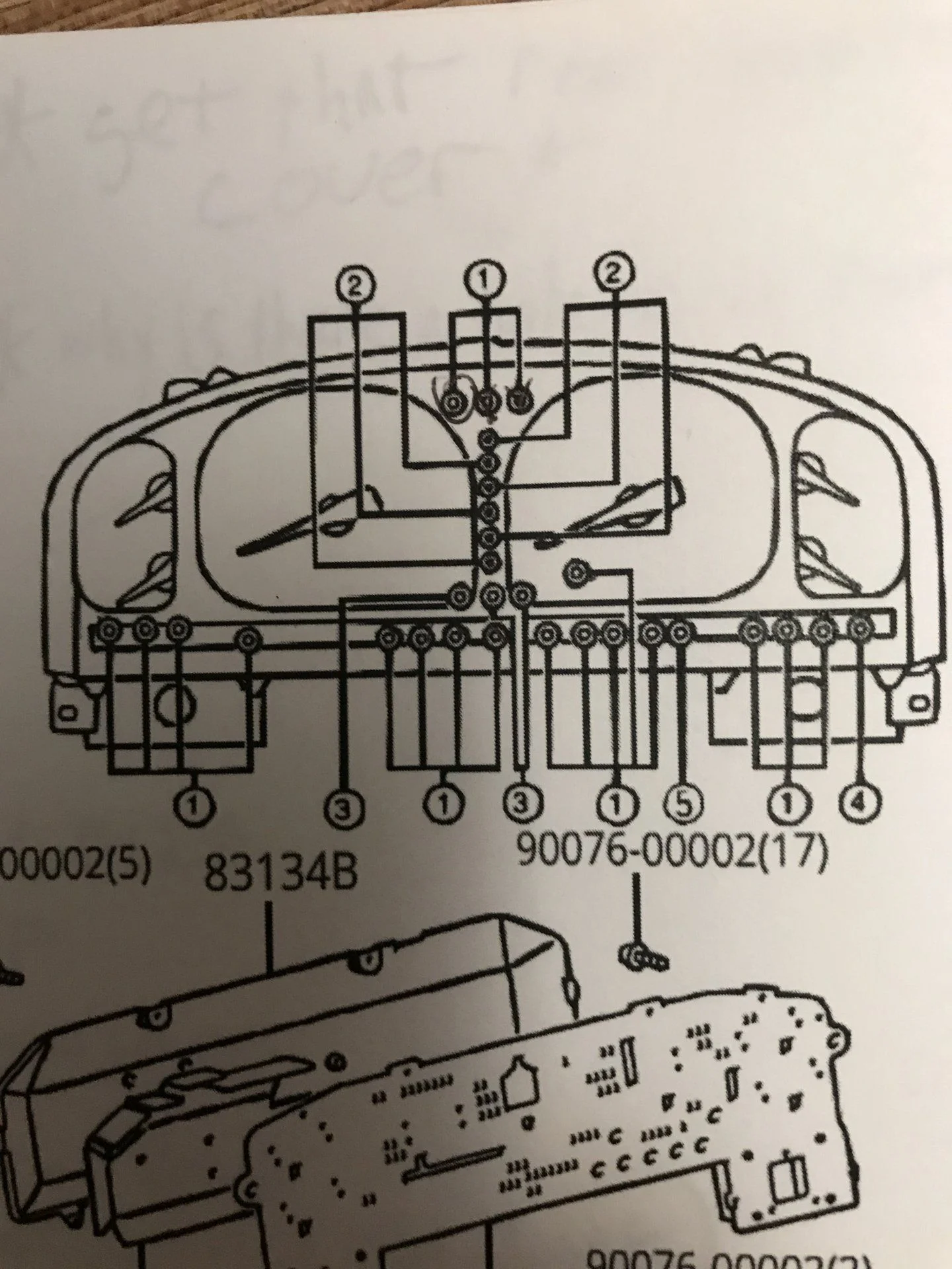

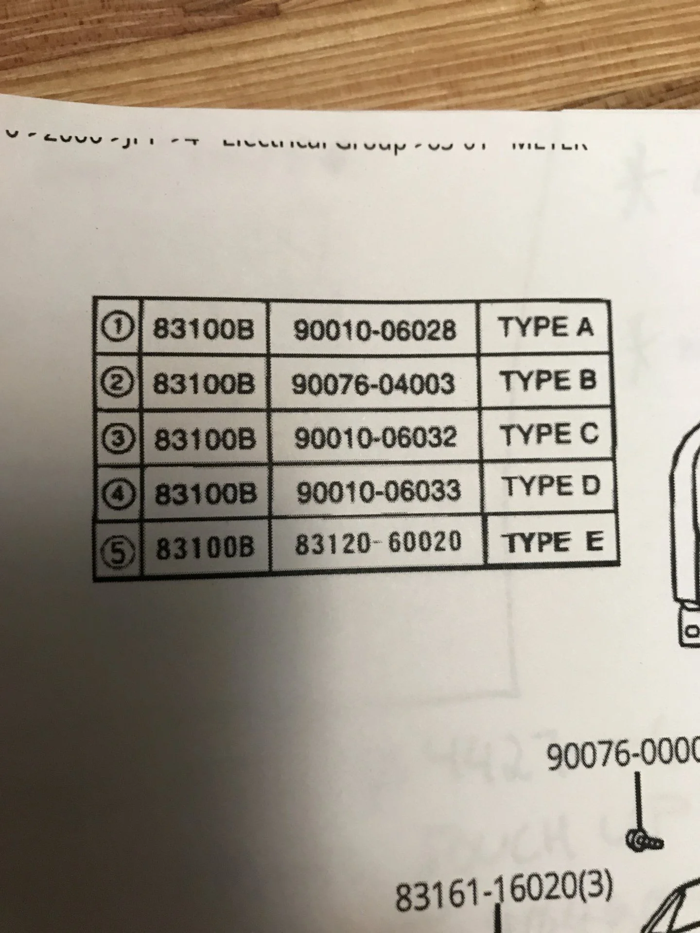

I’ve got the bulb to replace mine. I plan on removing the ABS bulb while I’m in there. I’m sick of looking at that light being on.
Yeah I just sat down and replaced all the burnt out bulbs in my cluster yesterday. It’s not a bad job and I rather like the all the bulbs working, even the “D”.
Anyone know which bulb(s) control the overall illumination of the entire cluster panel when you adjust the cluster panel illumination dial?
Mine works kind of but is super dim regardless if I set it all the way high/clicked to high or low, all seems about the same.
