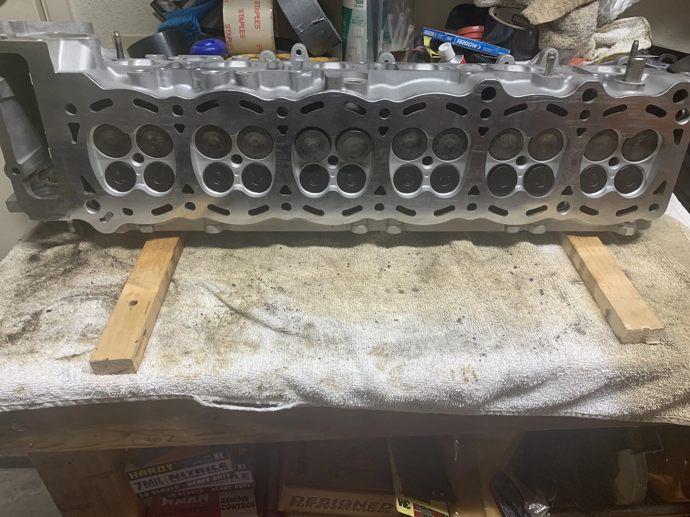

I used HDS Machine a couple of years ago and was happy with their work on the head and also had them media blast the upper manifolds.
