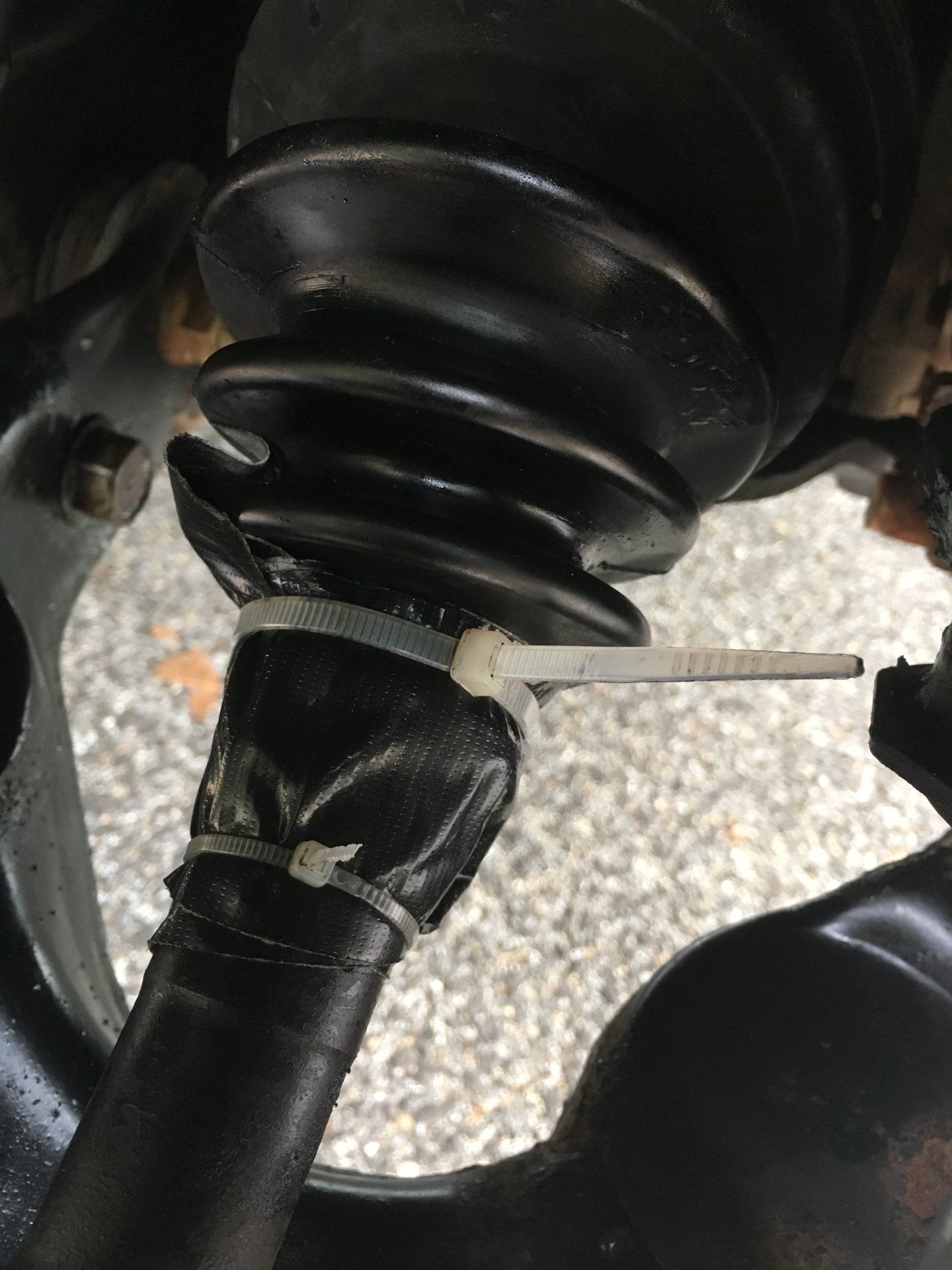

That's throwing a lot of grease, you sure the boot isn't torn?
No, I haven't had time to actually get down there and check if the boot's torn. But I agree--it's quite a lot of grease. If the boot's torn I'll prob just go ahead and get new CV axles. I'm hoping that's not the case, however.
Ok so I had an hour to take a look and there was a small tear right above where the boot clamps to the axle. Every time I wiped it clean, more grease reappeared so I’m hoping here is still a decent amount of grease in there. I fixed it with an extremely advanced and technical patch—gorilla tape and zip ties lol. Worst cv boot patch ever but I’m hoping it will keep the crud out until I can get it in for a new one.
The "caffe latte" color of the grease suggests it has mixed with water. Not good for your CV components to run water in them, even if it still has plenty of grease, they will damage fast. As suggested before, you need a full rebuild
Yep time to rebuild it, pull the axle, disassemble the tulip/cage and inspect for scoring, chips etc. If all is well, clean it rigorously with cleaner and repack with grease from the kit you get at Toyota. I did both of mine on my old LC, it sucked big time, dirty as hell, but it was due.
Isn't the Toyota grease sort of cream/latte colored? That looks like the stuff that was put in my wheel bearings by the dealer a few years ago.
