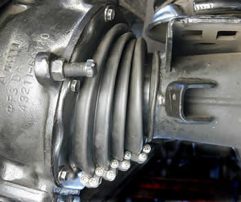

good idea? can anyone think of any downfalls?, easily torn maybe? anyone (maybe in a mine) used them?
http://gearingdynamics.com.au/Split-CV-Boots-For-Toyota-LandCruiser-78/-79/-70/-80-Series
Been used in mines, still seeing new units shipped with these, last ones heading to Saskatchewan.
Only downfall could be lack of visual evidence of a leaking seal???
Would fill the rubber with grease during install and monitor.

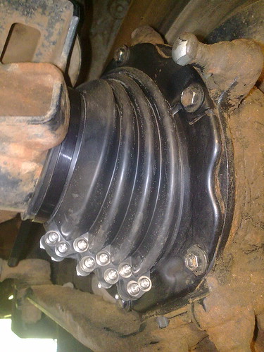

I got my boot set shipped directly to me from Gearing Dynamics. I put them on a couple of weeks ago and have been very pleased. I thought some of you might like some first hand feedback.
These boots do not replace the seals on your birf. They are to provide added protection to the seals and balls from debris. http://farm4.staticflickr.com/3797/10795456406_9c1ac98351_n.jpg
Your birf seals are retained and the boot simply goes over them with the seal retainer holding it in place. If they do get torn there is no risk to your birf as the seals will still do their job. :)
The boot should also prevent any water/mud from getting to the seal edge thus providing for a much longer life of the seal.
You do not put any grease inside the boot as they are simply protectors for the exposed surfaces and do not replace the existing seals.

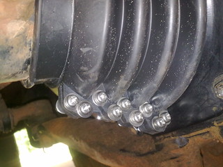

If you are concerned about inspecting the seals for leakage it is quite easy. You simply undo the "zipper" screws on the bottom and look inside.http://farm3.staticflickr.com/2884/10795429365_61d4be796c_n.jpg
I recently took a trip in the bush after a typical African rain storm and drove through about 3km of water that was above my axles. Upon returning home the inside of the boots were dry. :cool:
Like most things when I installed the first side I had some difficulty :hhmm: and contacted the guys at Gearing Dynamics and they responded within the hour. :D (it was during their business hours) I had difficulty squeezing the boot through the narrow top side but with a little perspiration it was fine. The second side went much easier with the experience. :clap: The roads out here should be a good real world test. You can find all the pics of the install with instructions on my Flickr Set :cheers:

IMO I dont like these. For the intended purpose (mining where there is lots of grit/chemicals/horrible s***) they are great at keeping the seals alive in vehicles that have a short life, but for general use like ours I dont think they are worthwhile.
You would need to be extremely vigilant at maintenance and inspection, if there is a small hole or tear water will get in and rust the balls out without you noticing. In a well maintained and used cruiser how often do the balls get rusted so bad you can use them? Or the seals fail? My front end has done over 100,000km since its last rebuild, no leaks, movement or rusting to be concerned with and the only maintenance is to pump in extra grease every now and again.

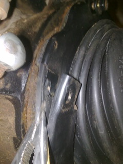

can you take few pics of how far they goes in to the housing tube ?
It simply goes around the outside of the tube, right next to the spring seat. The first pic in this threat is a good one and here is the one on my truck.
