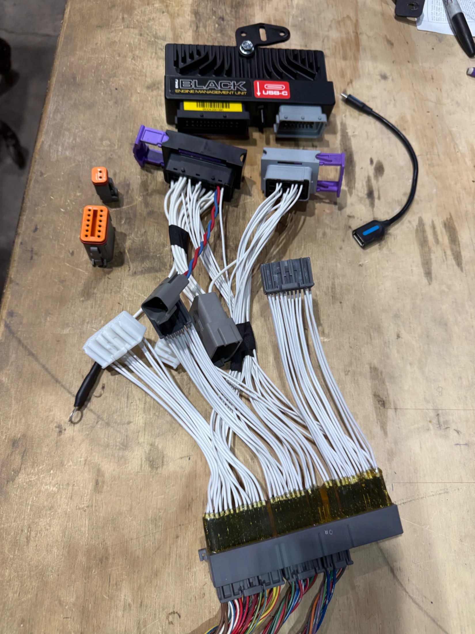

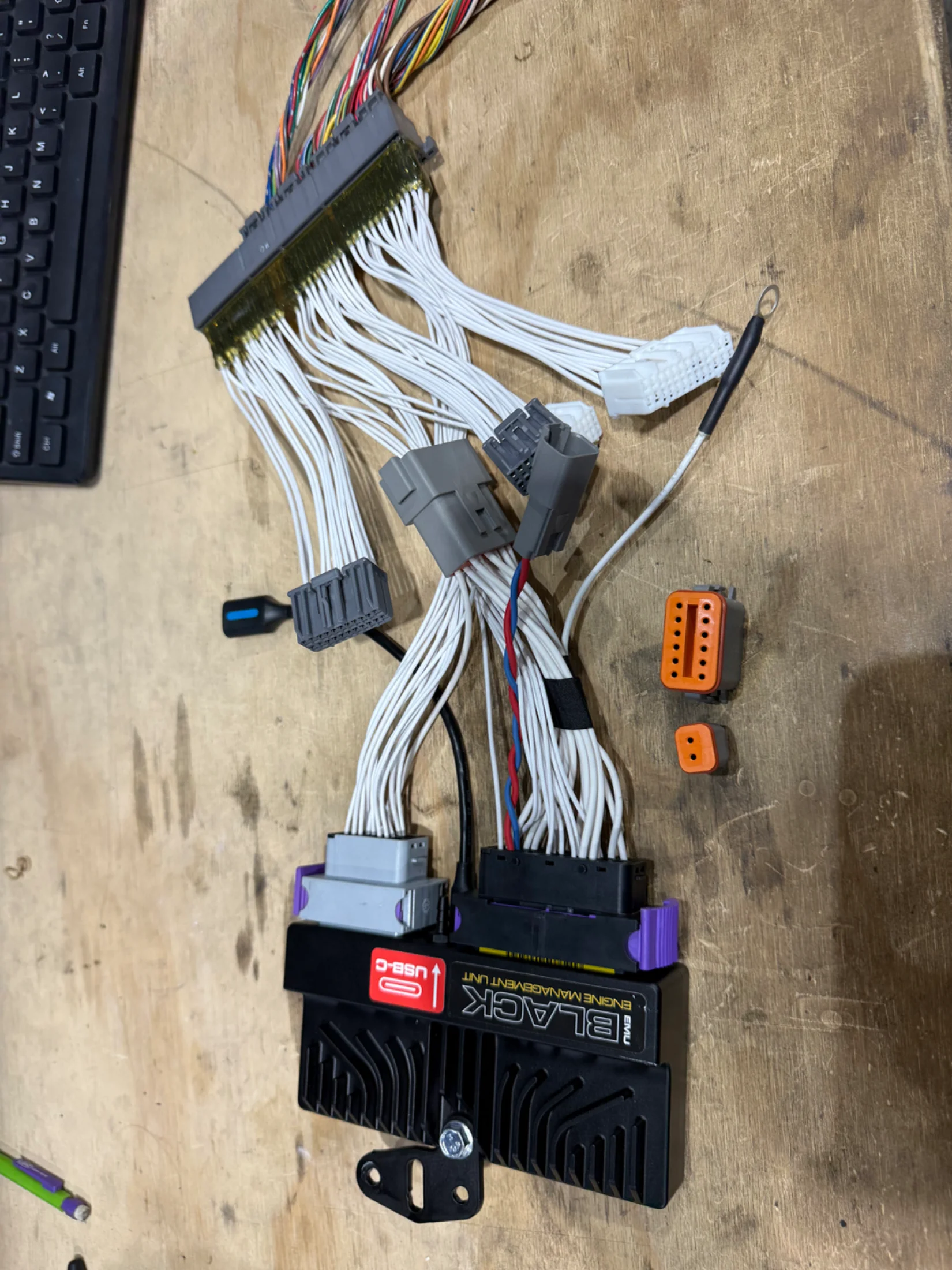

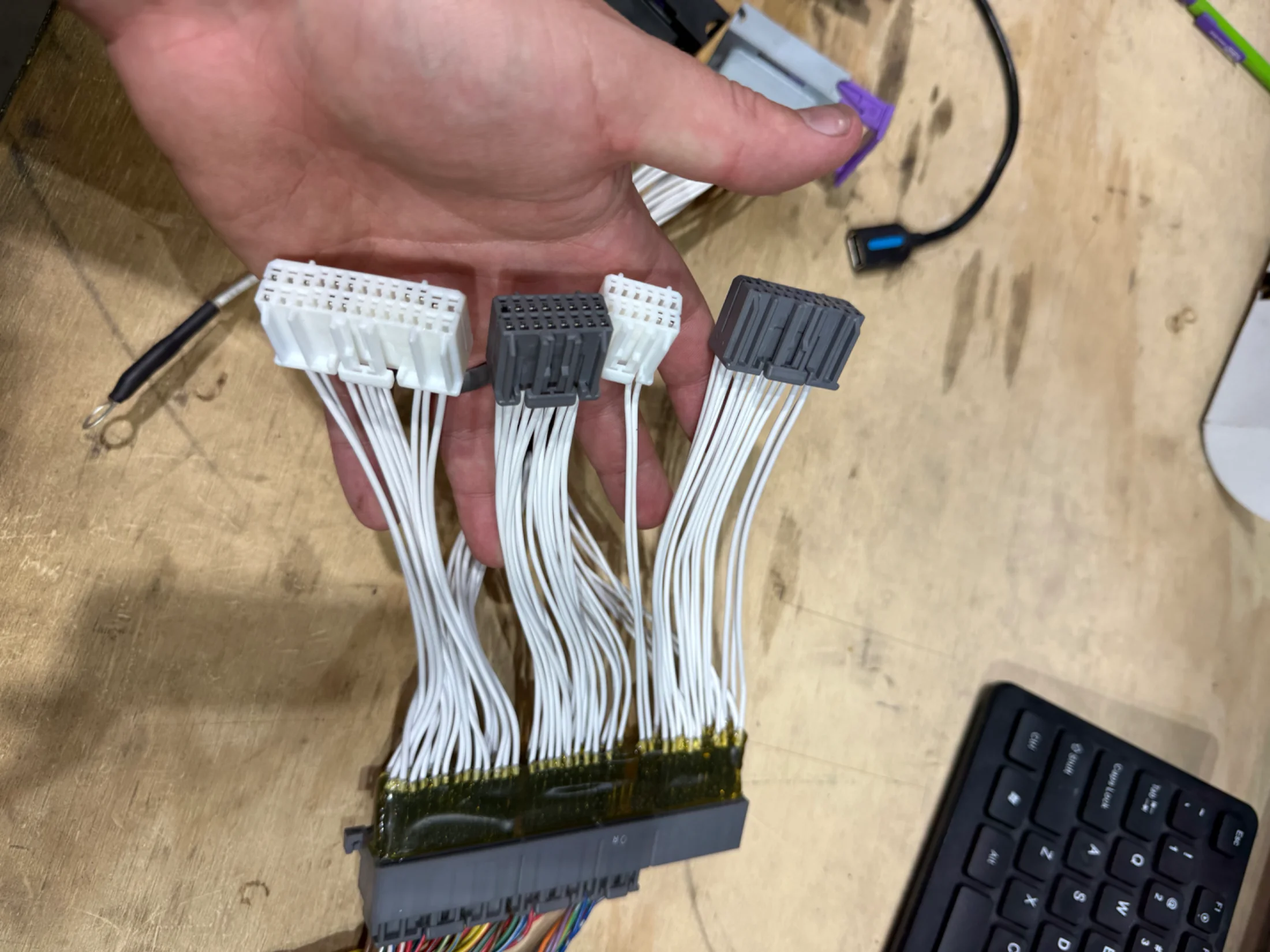

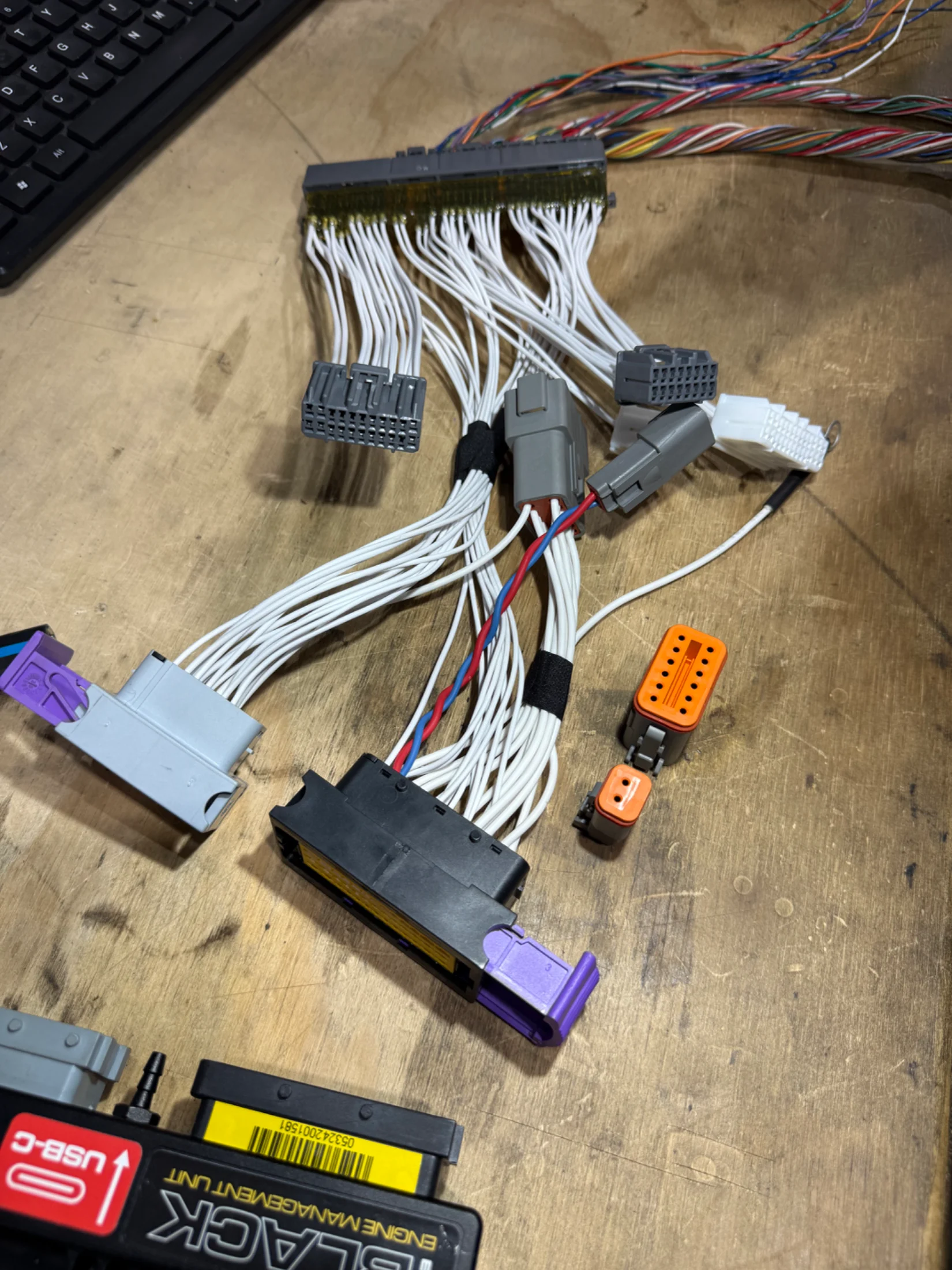

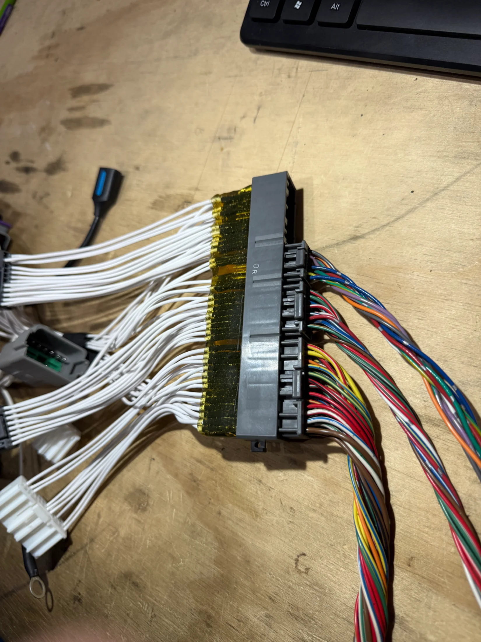

Alright we’ve talked about the PNP harness a bit… proof it exists. No cutting wires on 95-97, 93-4 require one splice for tach and another harness wire sent to ground. The 12 pin is for knock sensors, iat, and extra inputs and outputs so the end user can customize/build on. 2 pin is for CANBUS - think trans controller or Haltech UC10 Dash (yes those works with the EMU Black). Emu black has a USB C to USB A to connect to the laptop
This can be used for any FI - other turbo kits/superchargers.
View attachment 4008042View attachment 4008047View attachment 4008049View attachment 4008051View attachment 4008052
God wiring frightens the s*** out of me, looks great.
