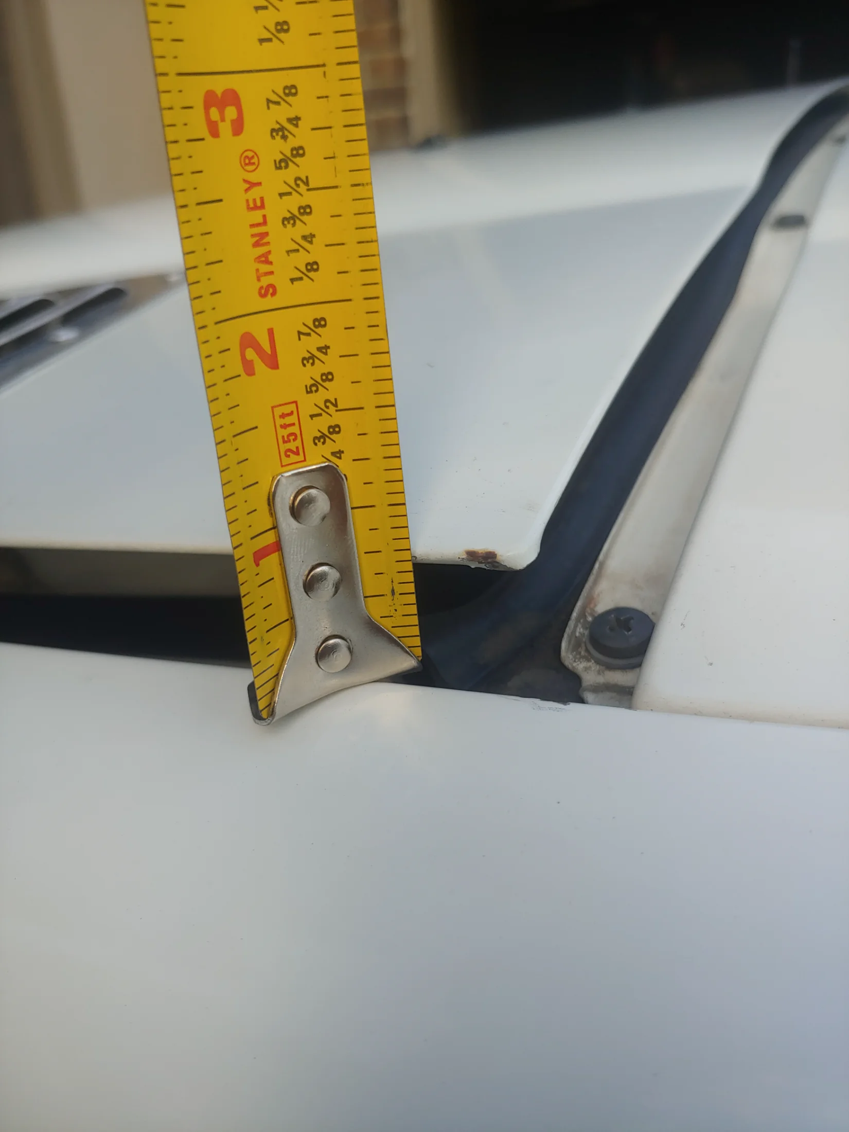

@efjayatee How high do those hood risers lift your hood?
About 5/8". You can reach out to @Outsane
And he can make them to what ever height you want. These are his standard height risers.
$35 comes with spacers and bolts
For those of you worried about IAT's we haven't had problems with the standard airbox configuration but a snorkel does do wonders to cut the IAT's when wheeling and airflow is stagnant. I have logged snorkel truck vs non snorkel truck on 90+F days and the difference can be upwards of 40-50 degrees, 110 snorkel vs 156 stock airbox.
No hood vents or risers on any of the trucks we've built to date and haven't had issues. Not saying they don't help, just haven't needed them. Will be interesting to see how @efjayatee 's underhood feels hopefully this upcoming week with the risers

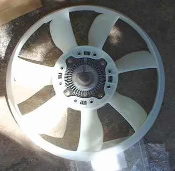

Are you referring to the "ringed fan" that came with the supercharger or a version of the 3FE that some guys including CruiserDan used.
Ringed Fan ?

Yes, the ringed fan came with the supercharger. It has a plastic ring on the outer circumference. The tips of the fan can't flex into the radiator because of the limited clearance but turns out not to be optimal for cooling.
Yes I am aware of CruiserDan's 93 supercharged vehicle. He took advantage of his parts department to sample other Toyota fans. I couldn't find the earlier reference to the 3FE fan but it looks like the 4Runner V6 was the ultimate winner.
The only reason that fan was selected for the kit is because it was an off-the-shelf Toyota fan that would fit on the clutch and not hit the radiator. It was NOT selected for it's performance properties. You should see one in it's original V6 pickup configuration. It has a very unusual shroud to go along with it in order for it to get proper air flow.
In other words, the ringed fan is a compromise at best.
The ringed fan was selected by TRD simply because it was on the shelf and would fit in the hole. In it's original configuration the ringed fan had a very specialized shroud that it interfaced with. Find an 88-92 V6 pickup and pop the hood and look at it. When used in an 80 with a 1FZ the fan is not ducted in anywhere near the same manner, therefore making it not very efficient at best.
Also in the original application it was possible for the fan to tackle the shroud thereby wiping out the shroud, the blade, the battery, radiator hoses air cleaner resonator and denting the hell out of the hood. Not he best design.
A stock clutch, similarly tuned as the above, with the TRD supplied spacer and either a 3FE fan blade or a late 3.0 V6 non-ringed fan blade. The latter blade part number is 16361-65020.
The 65020 blade moves more air than the ringed blade that came with the kit. There are trucks running the 3FE blade with apparent success but I am not comfortable spinning that blade at the higher 1FZ revs.
