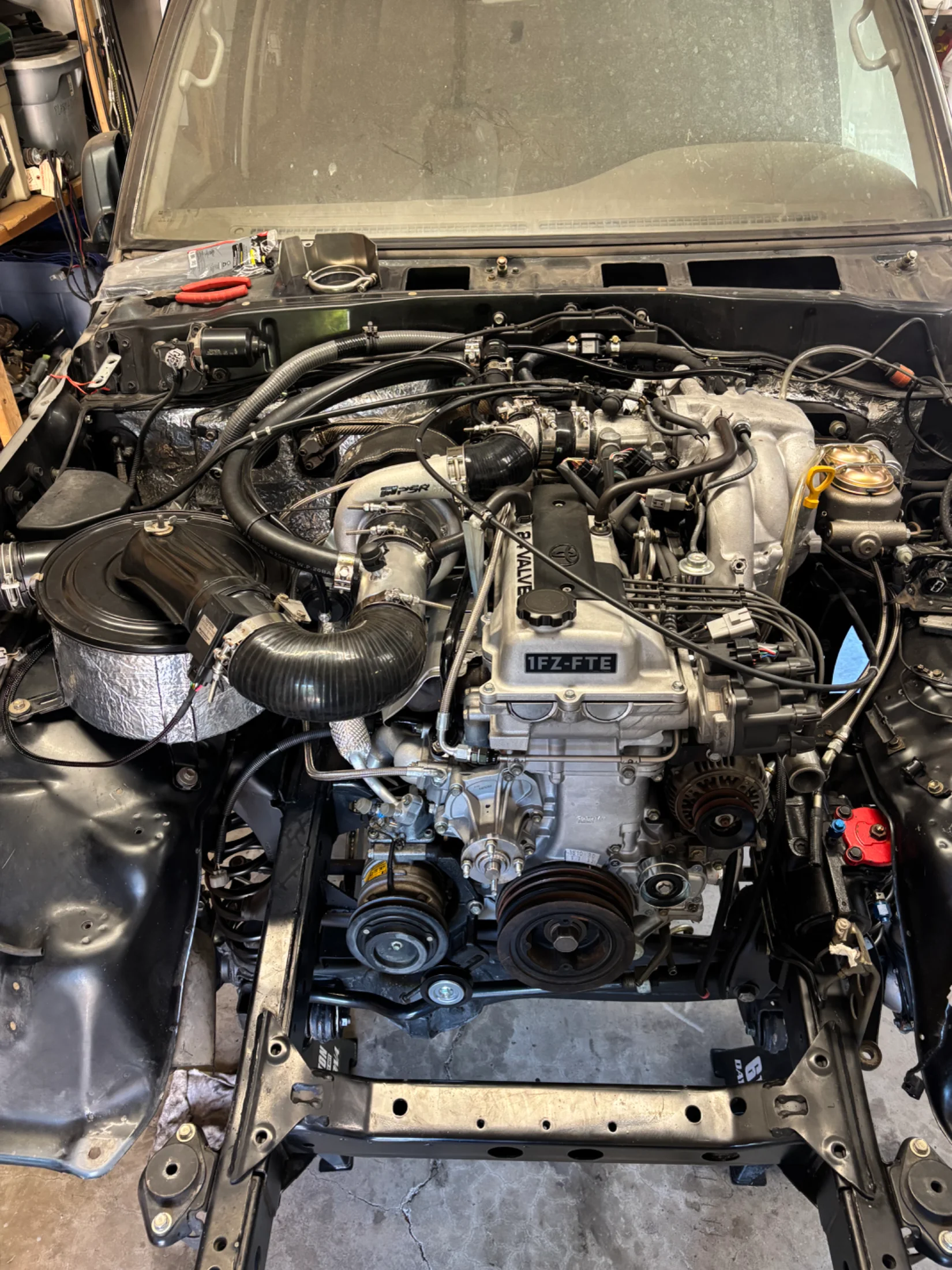

My stage 1 kit is installed but hasn’t ran bc the rest of truck is torn apart around it. I think I need to stop reading this thread……. 😆

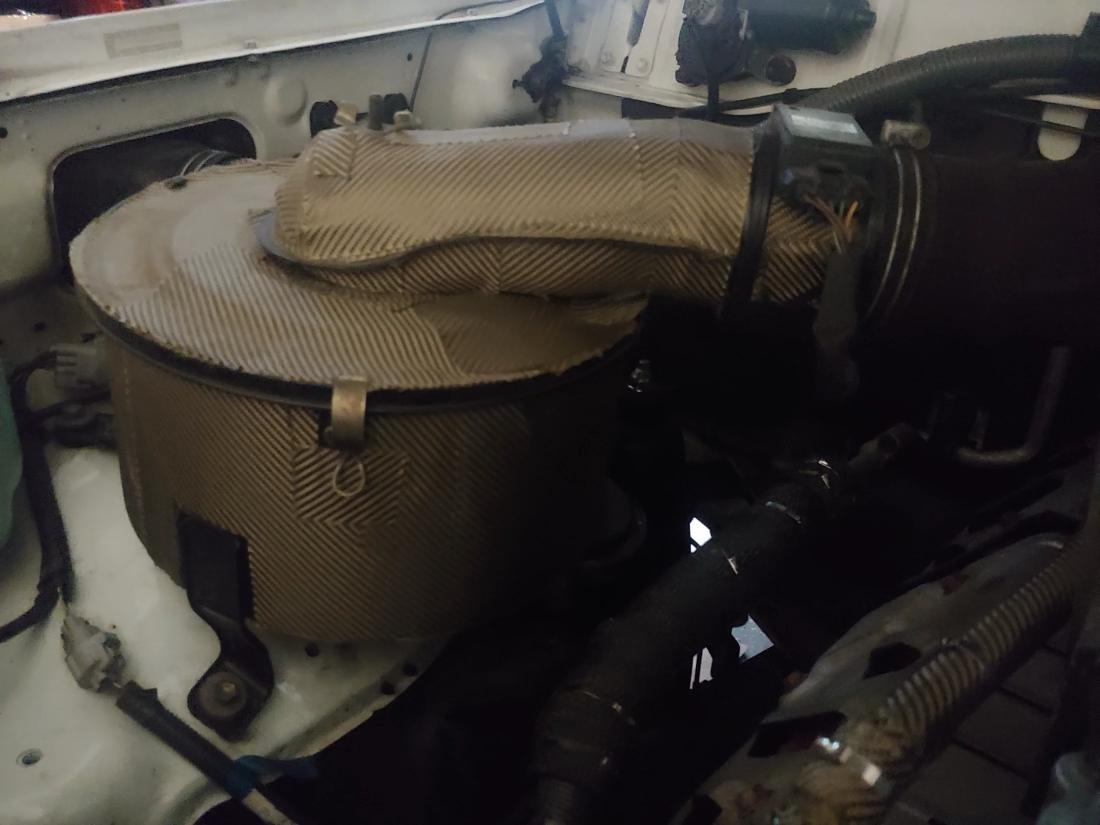

Love what you did with your air cleaner to reflect the heat. Just recently did that on mine as well.
The entire area gets heat soaked but I figured I could at least reflect the most intensely heat exposed side of the intake can.
I did it for giggles and gigs. Didn't seem to help the IAT but I don't have a dorkel on this one.

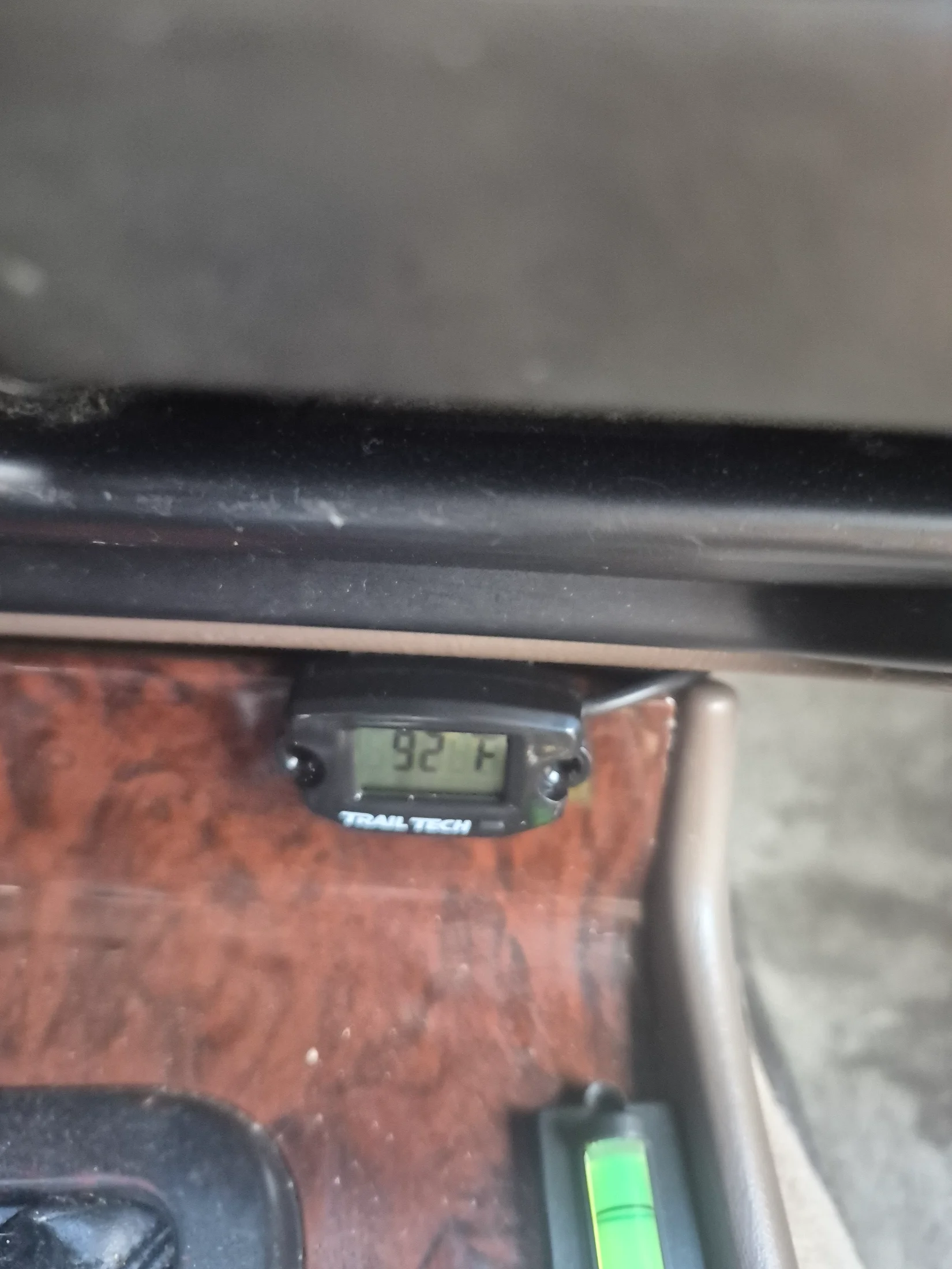

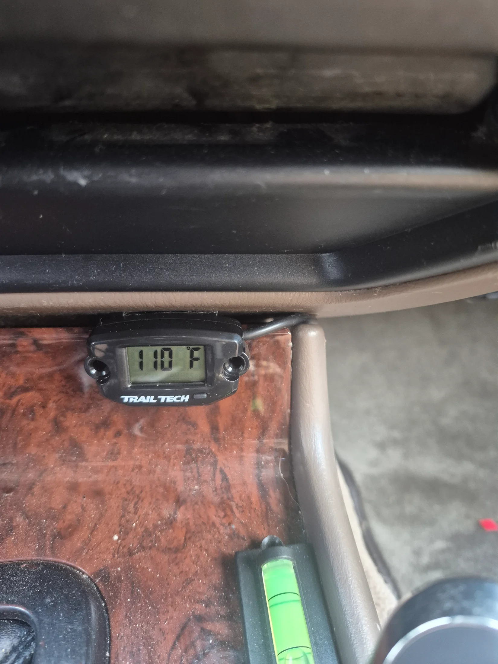

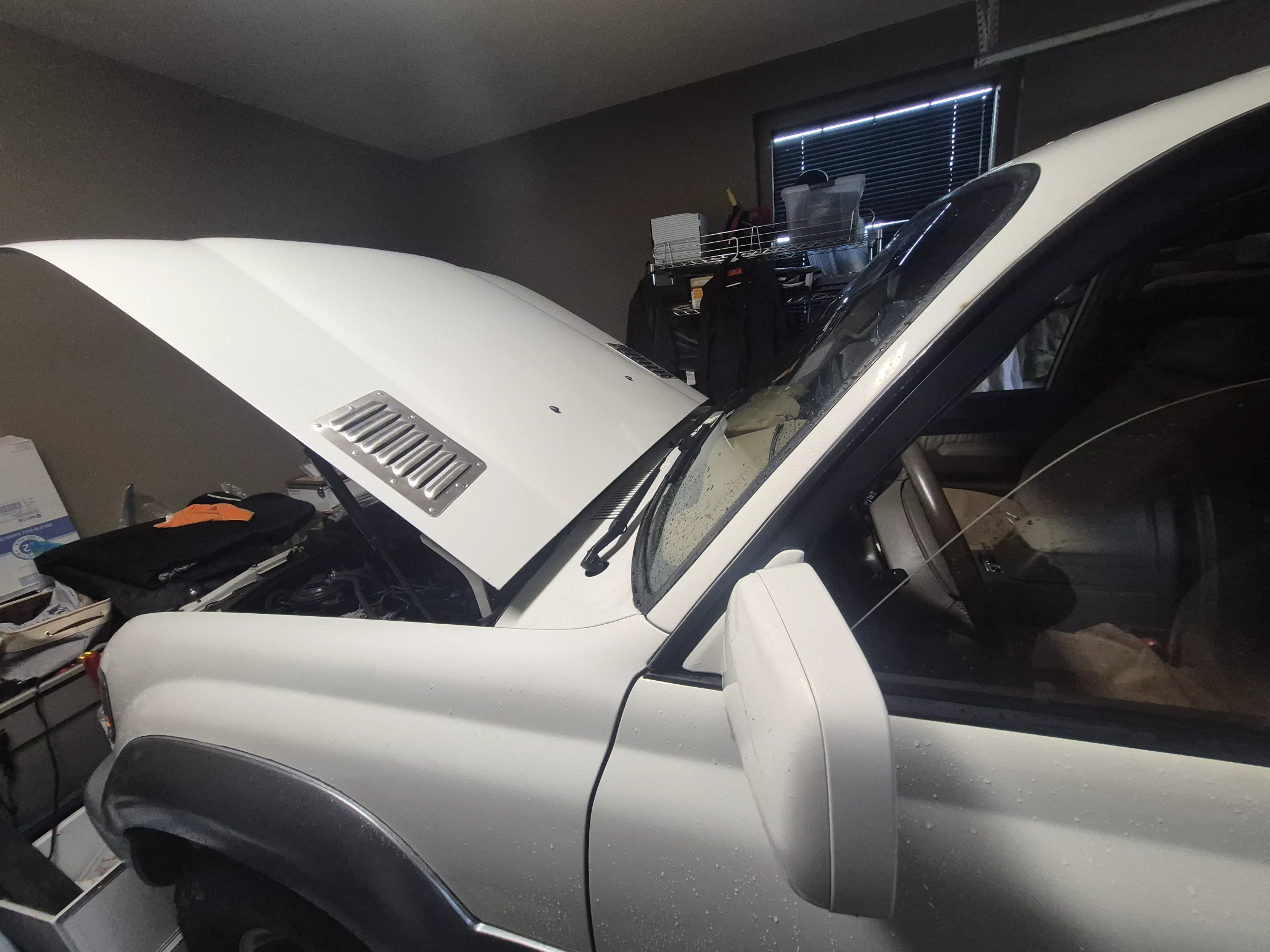

I was curious so I installed an ambient temp inside the stock engine bay on the manifold side to see how hot it gets.
Condition:
Outside temp 80° and cloudy
Distance 20miles round-trip
Drive: Freeway and street
Mods: solvefunction hood risers and hood louvers
At idle/traffic, the bay temp reached 110°.
In town driving 96°
On short a drive on a freeway, temp went down to 92°
I believe at stand still, traffic or idle the hood risers and louver doesn't significantly draw hot air out of the bay but definitely better than no mods.
But where the hood risers does shine is when moving. It let's the hot air better escape than the hood louvers. I could only imagine how hot when the Turbo is installed!
I need to figure out how to keep the engine bay cool(er) for the Turbo.
I'm not exactly sure what my plans for the future of my rig are, power-wise, but I've always planned to include ceramic coated exhaust in the package... Maybe I should plan on a ceramic coated airbox as well. 🤔
Only if you don’t like the look of what I did to mine which is less costly.
