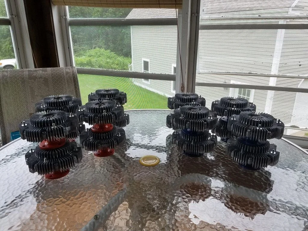

they arrived and will receive the first stage of modification this week. They then head out to my machinist for flange work and then on to Joey for distribution.
I was able to get my hands on a few more so if you are interested get a hold of joey.
Looks like the machining for the Orange Hubs will be complete and shipping out to me by the weekend. I should have all the pieces ready to ship out by the time they show up and be distributed out to those that pre-ordered.

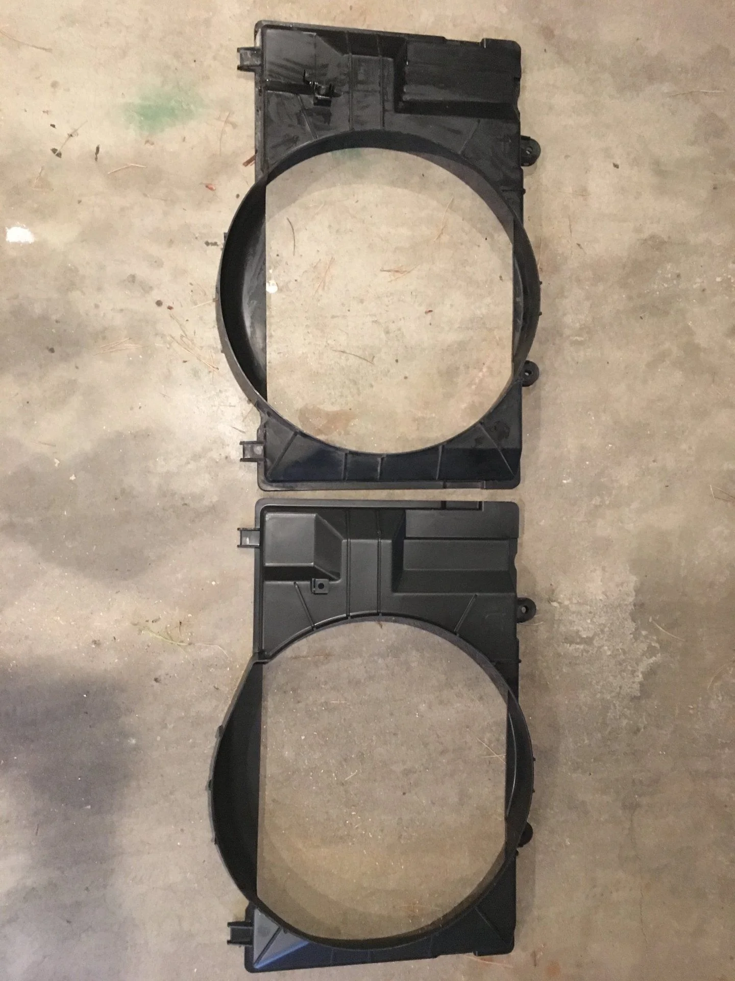

Shroud update:
I had an occation to ordered a fan shroud from Toyota for a customer who had a broken one.
This was also a custoner who ordered an orange clutch for his SC.
Turns out Toyota has redesigned tbe shroud and reduced the interference area where i had the contact issue.
The change is more that a slight change and i'm curious if there is sonething else going on.
So if you have considered replacing your shroud now might be a good time to do so.
So, if I get a new shroud do I not need to install the wedges?
I didn't. In the original instructions I had you remove some of the shroud where it was curved inwards toward the ran. Thst area doesn't exist in the new design.
I added the wedge as insurance but with quite a few reporting no issues with out it, it would seem to be ok to run without it with the new style shroud
I just put mine in with a new shroud today. Here's the difference between the shrouds. New one is on the bottom. The differences is a small jog in the bottom left corner of the ring. Other than that it's identical as best I can see.
I'm glad I have a new shroud. :) It was an accidental up-grade. My original had a crack in one of the top ears so I replaced it when I put the new clutch in.
