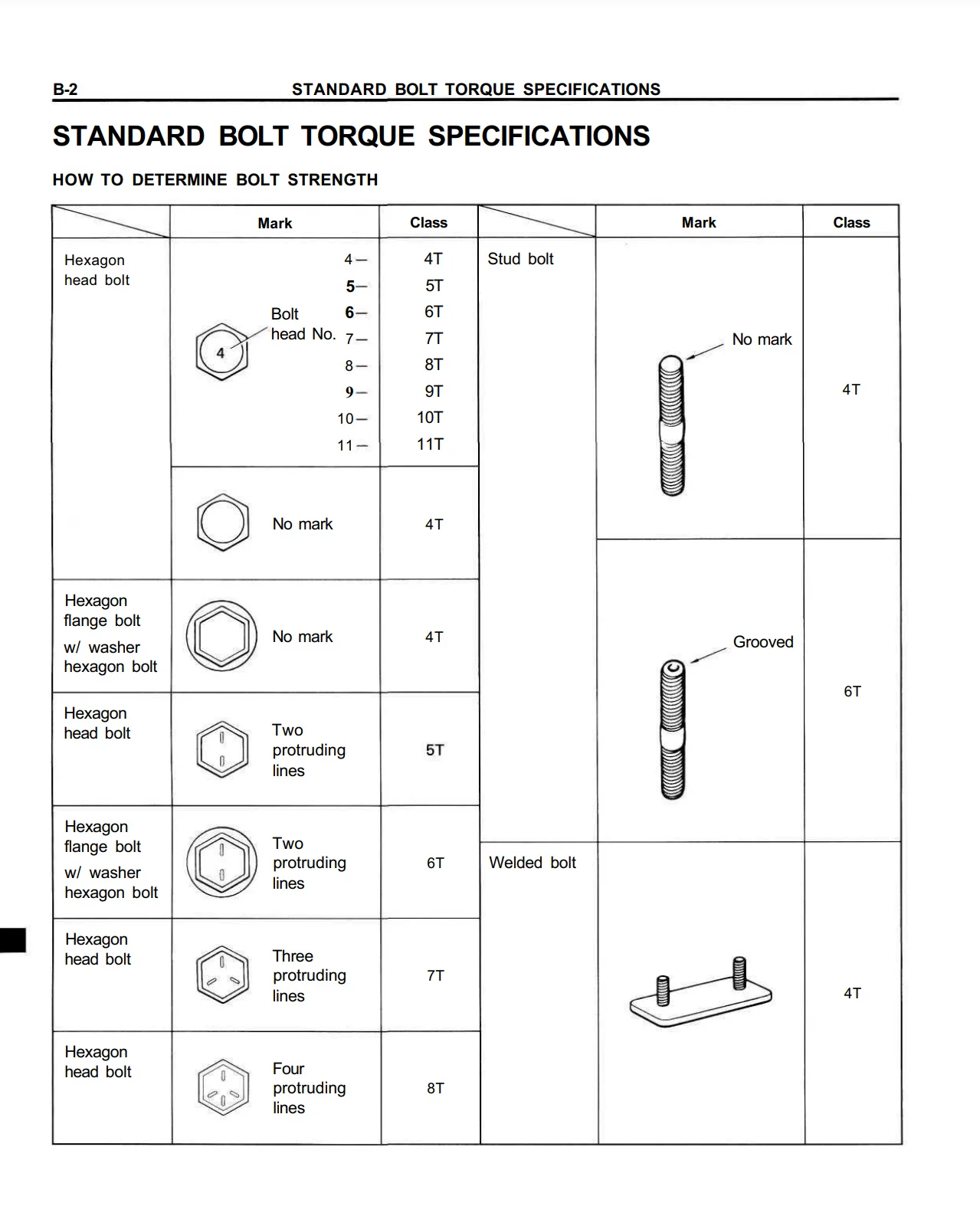

This?

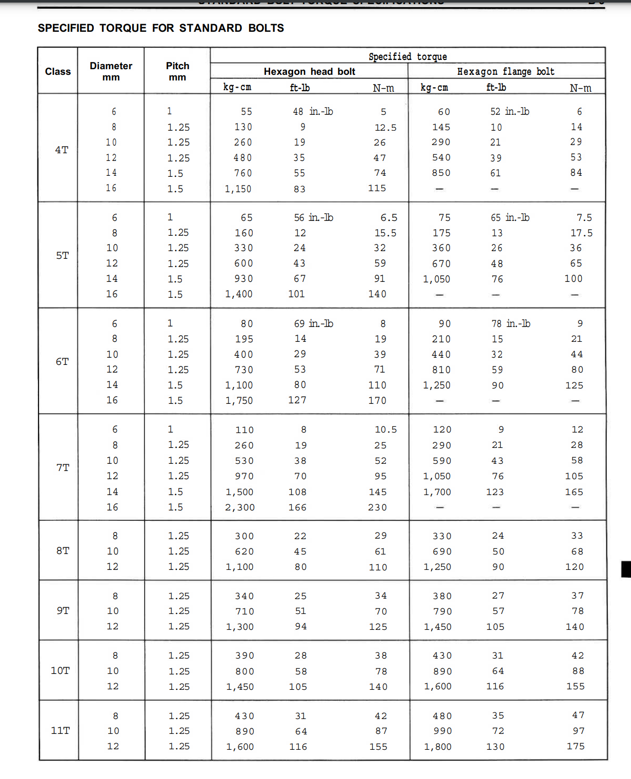

Close. It’s the piece that your piece (diagram) is bolted to. The 4 bolts I am looking for the torque spec for is the crossmember that connects to the frame rails. I am installing Arb skids. There is a torque spect given for the bolts...but I wanted to cross reference it with the factory spec.
