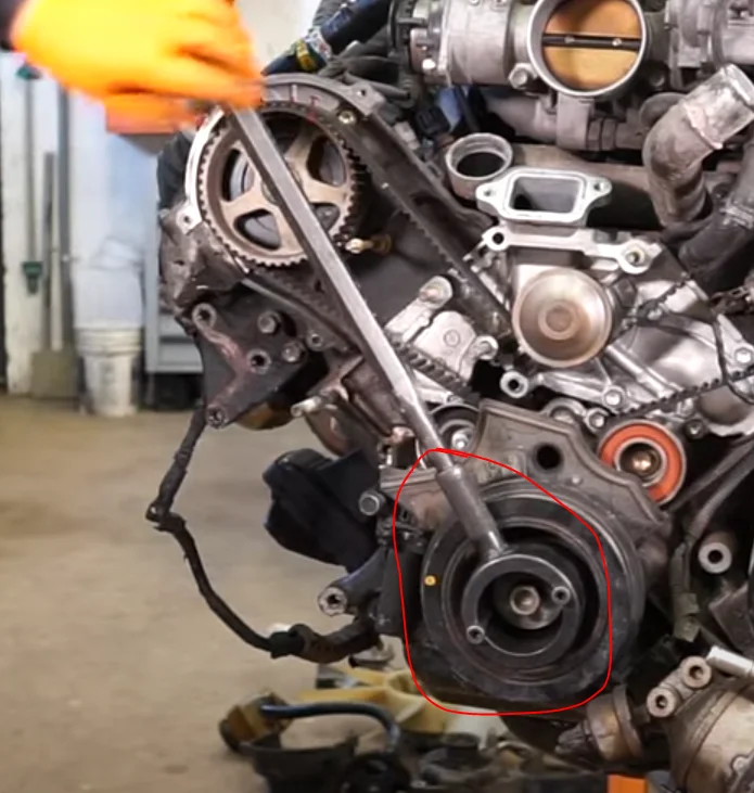

@OTRAMM has a handy dandy tool for this. Might be something you can rent. Otherwise, a big @ss impact will take it off no problem. Just did mine this weekend. There's no great way to torque it without this tool imo. Holding the cams instead is a little iffy, not great.
i've got a tool like your amazon link and it works great - it was just the required torque that was killing me
