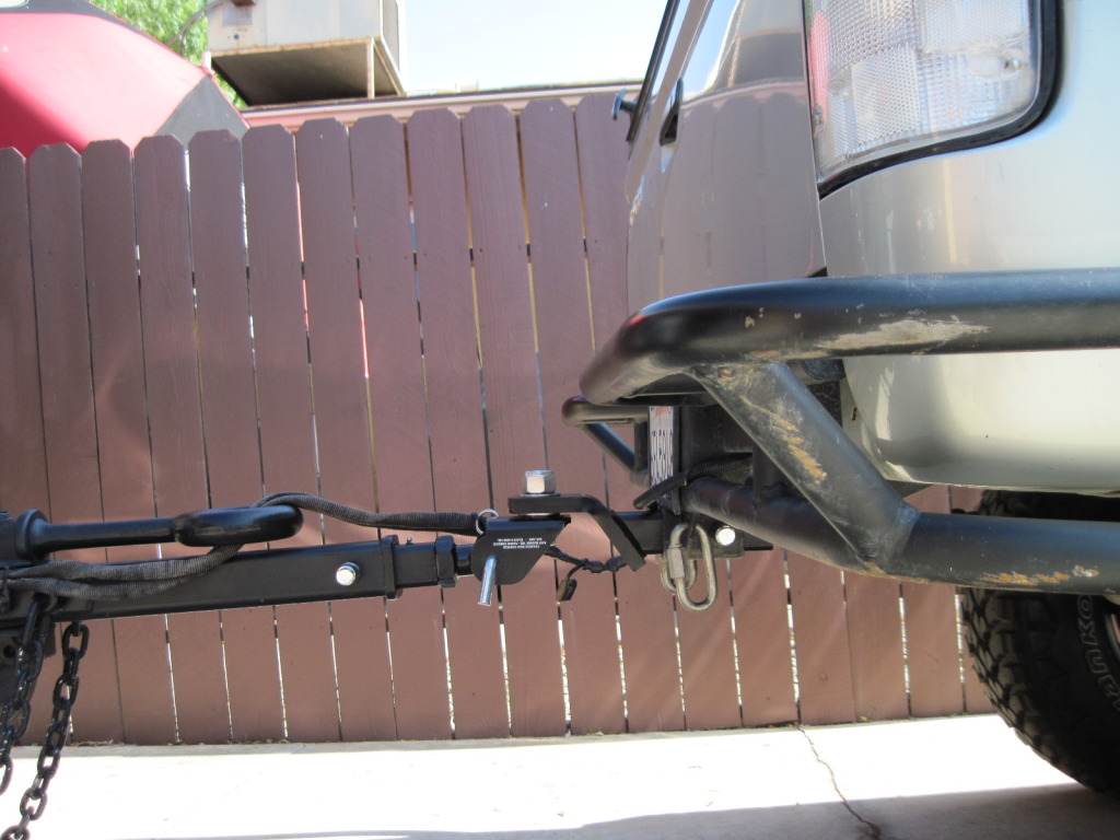

Maxx Coupler doing it's thing...
Pinyon Trail, SoCal #1
Pinyon Trail, SoCal #2
Pinyon Trail, SoCal #3
Pinyon Trail, SoCal #4
http://i1191.photobucket.com/albums/z465/DellTaco00/Max Coupler inverted/MaxCinverted1.jpg
I personally prefer trail work/towing with my Maxx C
versus the original pintle/lunette combo.
I've used both...
and hands down the Maxx C. proves smoother, quieter
and has proven it's durability.
I feel it also offers more articulation then my Pintle/lunette combo ever could.
^ based on my personal experience. (old school peeps will still ignore the truth)
Assuming a rotating lunette or pintle hitch I see no difference in range of motion (360° axial, 180°+ pitch, 180°+ yaw*), so I'm not sure how this could be the case.
*In Yaw there could be a slight difference, but it would be entirely dependent on the geometry of each specific tongue. In any case the difference could only be a max of about 10°, and that would still offer more than 180°
oops... meant "better" not more.
reason I say better...
is because no matter how well matched a pintle and lunette
may be...
there will still be an occasional bind and snap release.
^ this will never occur utilizing the Maxx C.
