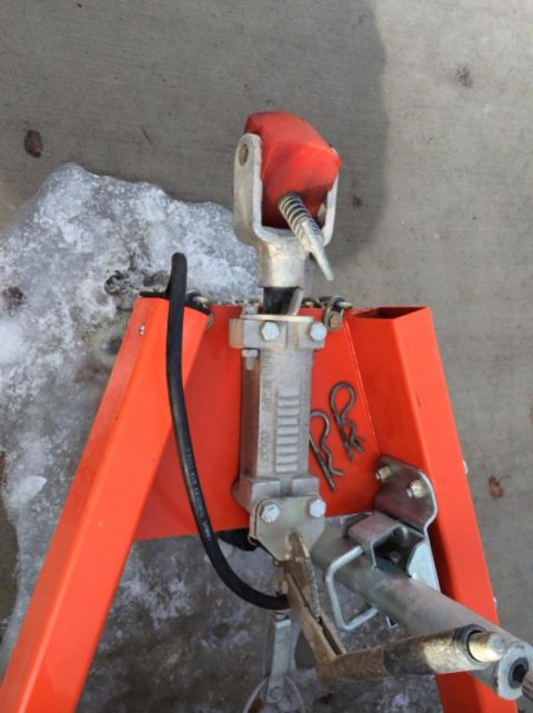

My Treg is no longer available from any US seller, but you can still order one from Oz. I have used mine for twelve years and it is still great, though a lot of the plating is gone from the main pin and the C coupling where the poly block rubs. You can buy a locking pin for it. I sometimes use a small padlock in place of the retaining pin at the bottom of the main pin.
Vertical range is plenty adequate for anything but extreme rock crawling, lateral is limited by trailer contact with the tow vehicle, roll is unlimited.
I really like the coupler. It has been proven in the worst Outback conditions and is very popular Down Under. It is dead quiet in all situations. If I ever need to replace mine, I will probably buy another. I really like their Hand Brake version, but unfortunately it will not work with an extendable tongue.

My Treg is no longer available from any US seller, but you can still order one from Oz. I have used mine for twelve years and it is still great, though a lot of the plating is gone from the main pin and the C coupling where the poly block rubs. You can buy a locking pin for it. I sometimes use a small padlock in place of the retaining pin at the bottom of the main pin. Vertical range is plenty adequate for anything but extreme rock crawling, lateral is limited by trailer contact with the tow vehicle, roll is unlimited. I really like the coupler. It has been proven in the worst Outback conditions and is very popular Down Under. It is dead quiet in all situations. If I ever need to replace mine, I will probably buy another. I really like their Hand Brake version, but unfortunately it will not work with an extendable tongue. http://www.tregtrailers.com.au/poly-block-couplings/ John Davies Spokane WA USA

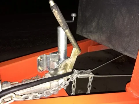

Do you have any pics of how that hand brake works? You are in GJT aren't you, I go there all the time. I know Hugh at Safari. If you are I'd like to see your trailer.
PM me next time you are headed this way. I still have the camper although I'm working of selling for a new model from the same company.

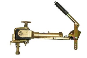

With a light duty trailer like Jonharis has, I presume the trailer does not have brakes. So he is using an axle with brakes, but only as a parking brake? That would be easy to rig up.
My idea is to use a 40 or 60 rear axle on my trailer, so I could theoretically rig up an emergency brake such as above on that axle? Could an electric brake controller be set up to work with a 60 series rear axle, for movement braking? Then rig up the emergency brake as well? I like the idea, anyone see flaws?

It would be much simpler to just order and install a Dexter axle with their P-Brake units. You could hook up the two parking brake levers via cables, and leave the electric brake magnets disconnected if you like. But it makes sense to connect them and use a controller, even on a lightweight trailer. Mine has a typical towed weight of about 750 pounds and it has brakes.
http://www.expeditionportal.com/forum/threads/59536-Dexter-10-x-2-25-electric-brakes-with-parking-feature
http://www.nickstruckparts.com/k23-086-00.html
Plus the Dexter axle would be hugely lighter than a Land Cruiser axle.

From the looks of it I suspect that the p-brake handle on that Treg coupler assembly could be mounted elsewhere. For that matter any similar such handle from the junkyard could be employed.
I have electric brakes on my camper. I highly recommend them for off-road use, regardless of weight. The added control in technical terrain is appreciated. You are correct in that the integrated lever in the Treg operates a parking brake. The cable that you see threaded through the assembly terminates at each hub.
