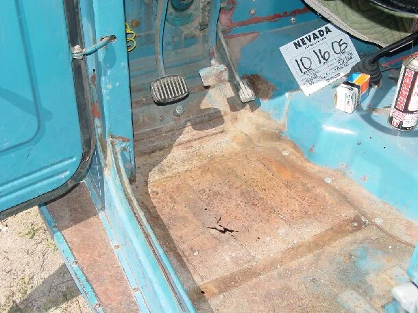

rust spot
this is the small spot of rust. do they make replacement panels here in this area?..or is it going to be a generic sheet to fix?..thx paul

It'll be a generic fix. There are very few '45 parts made though '40 parts work in some cases.

That section of floor pan should be the same as simular years of FJ40s. I was able to get a good section of floor pan for my 63 fj45swb from someone on this forum.
