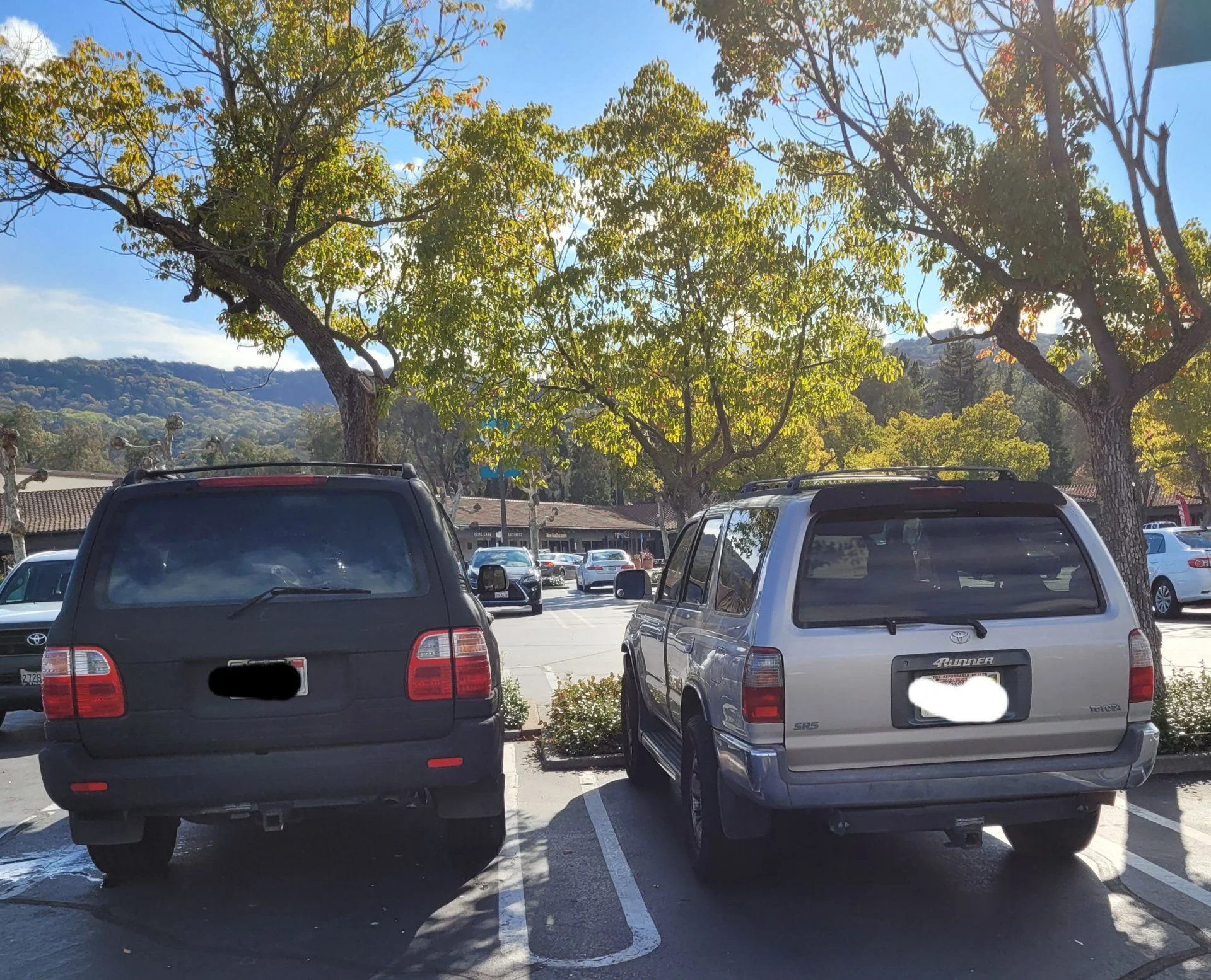

I have a 100 and a 4th gen 4Runner and the 4Runner is much cheaper! Land Cruiser parts are a lot more. No regrats though
