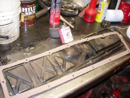

Side cover gasket....
This is where your Gasgacinch or Caterpillar 5H-2471 Green cement come in and shine...clean the cover and the sealing surface of the block very well agian with brake cleaner or other fast evap. solvent. Use some contact cement on the gasket and cover, attching your gasket to it. After the gasket has set up on the cover, I use just a bit of black sealant on the lower half, just to help keep things leak free. (sorry about the crappy first pic)
Hope this helps!
-Steve
View attachment 56394View attachment 56395
