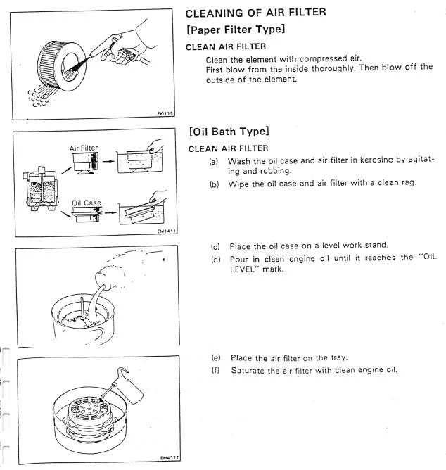

I dunno, really - but I wouldn't call it the most common config, thats for sure. But... it IS in the EPC so I guess its normal after all. Neat.
Anyway, here you go... looks like its hard to screw up:
I've had lots of trucks with these and I always used the same oil I was using for the engine.
