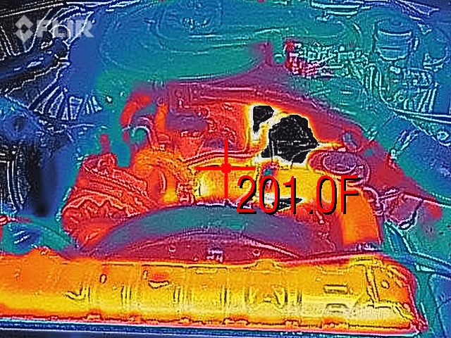

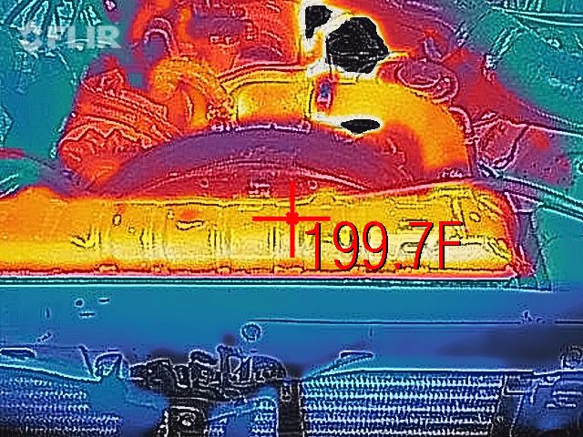

In order to confirm the temp gauge was working, I took these infrared photos a few minutes after the engine was turned off. These were taken when the gauge was reading the highest - just shy of the red.
Any thoughts on whether this is normal heatsoak, or if something looks awry?

When I turned the engine off, temp read halfway. A few minutes later it was almost into the red.
While the gauge was reading high, the thermostat housing read 201F

While the gauge was reading high, the radiator read 199F

Any thought on these temperatures? Gauge working properly based on these observed temps? How much should the temp increase after turning the engine off? I can't seem to find this info anywhere.
The FSM says over 230 is considered "overheating". What happens when it's 30 warmer outside, or I was driving harder and the engine was hotter before shut down...
Normal for that. I believe all of these motors do it (mine does) - it has to do with where the temp sensor is located (top of the block) - so when you turn off the engine, the water by the sensor gets real hot...until you start moving water around after you start the engine again. That it hits the top of the gauge is not a huge concern.
One thing you might want to do is ensure the system was burped properly. Search the forum or You Tube it for that. Also I hear that a bubble of air can get trapped under the temp sensor after cooling system maintenance....not a huge deal, but again something you might want to clear out.
i'm no expert, but I don't think your numbers are concerning...I think it's a 190 or 195 deg thermostat in there.
Yeppers, the motor is being constantly cooled till you turn it off. The heat just builds up at that point. Then it cools off. I would not be too worried at those temps.
Normal (as stated above). What you're seeing a few minutes after the engine shuts down is the actual temperature of the head. The head is always hotter (a lot hotter) than the coolant when the engine is running and at operating temp. Since the temperature sender is screwed into a fitting that's screwed into the back of the head, when the coolant stops flowing, the sender soaks up the heat from the cast iron head.
Many modern engines have the temperature sender screwed into the thermostat housing, which is a bit removed from the head, so you don't see the big needle spike a few minutes after shutdown like you do on the 2F.
For all its annoyances located back there, it does have one redeeming quality. If the engine were to lose coolant while driving, the sender would still detect the increase in temperature since its screwed into the head. Temperature senders that are installed in the thermostat housing, or worse, the radiator inlet hose, are more dependent on being in contact with coolant to tell you what's going on.

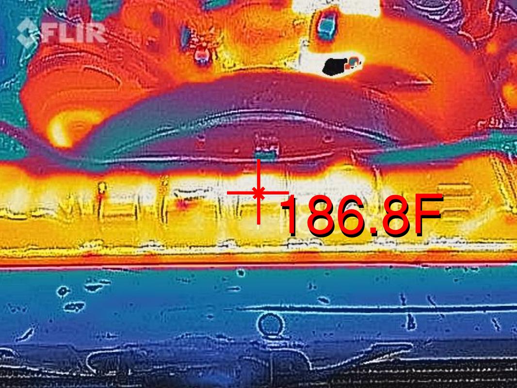

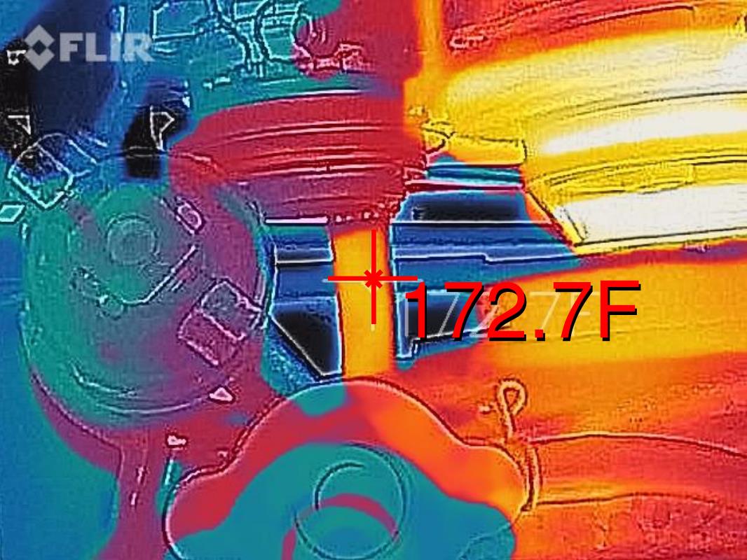

For the sake of comparison I took some more IR photos with the engine on. The gauge was reading a bit under halfway when these were taken.

While the temp gauge was reading in the middle, the radiator read 186F
While the temp gauge was reading in the middle, the radiator outlet hose read 172F (I assume the rad does a lot more cooling at speed)

I believe this is in line with everybody's comments above. These temps are only marginally lower than the temps noted in the original post. Meaning there's only a little bit of heatsoak - it's not like the entire cooling system is overheating at turnoff.
I guess the next thing to look at would be the temperature of the temp sender when the engine is on, and then a few minutes after it was turned off.
