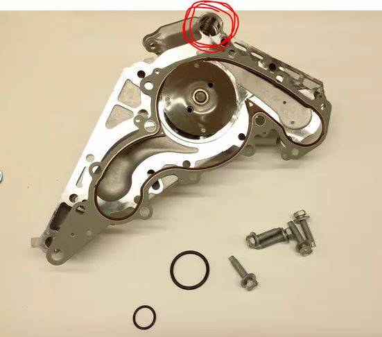

Well....my guess is they botched the O-ring at the back of the water pump...hopefully they didn't put sealer there too, just the O-ring and a little grease is all that's needed! RTV and O-rings don't work well together!
I'm also noticing that some liquid gasket is being squeezed out from between the water pump housing and the block. I know the FSM calls for a gasket, without and additional silicone or FIPG. How common or "OK" is it to use liquid gasket between the water pump and the block? Is it a huge red flag? The shop owner mentioned to me that he sees lots of leaks with AISIN brand water pumps, therefore preferring a different brand (don't recall which one)..
No sealant behind the water pump! The metal gasket and cleaned block are all that's needed. I do a fair mix of Aisin and toyota pumps, haven't had one leak yet! As a matter of fact I'll only install thise 2! Man, I think someone didn't know what they were doing when they did that job, the only sealant used is on the flat surface at the thermostat to water pump connection. Definitely none on the O-rings or behind the water pump...
