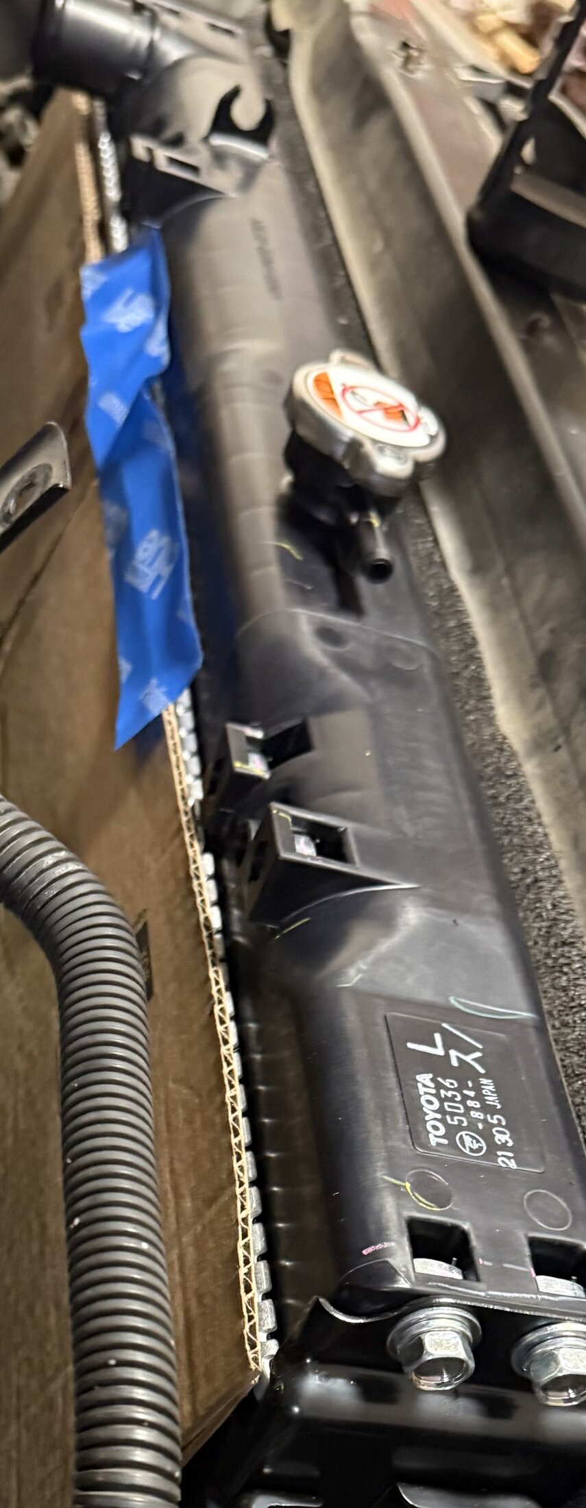

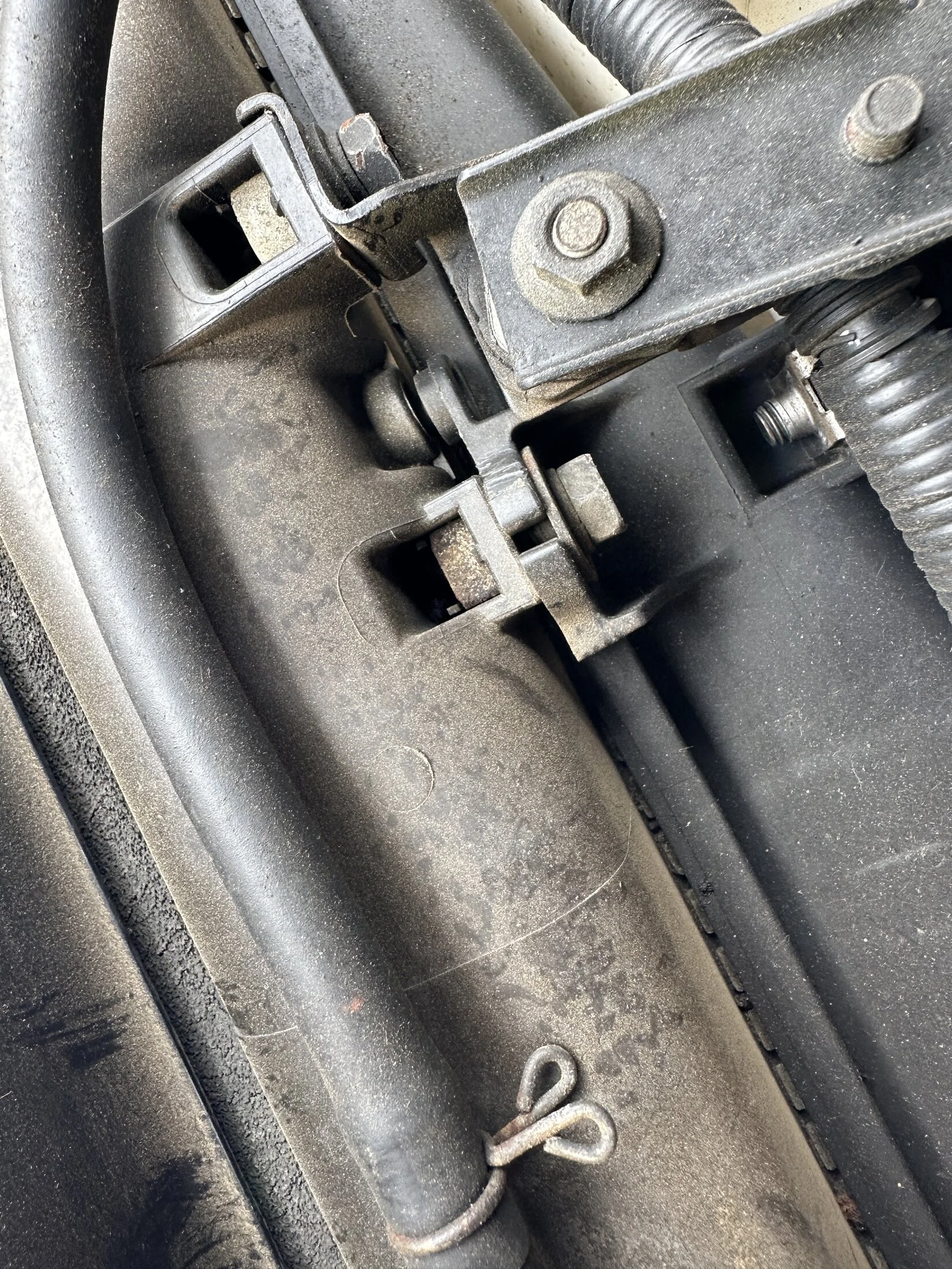

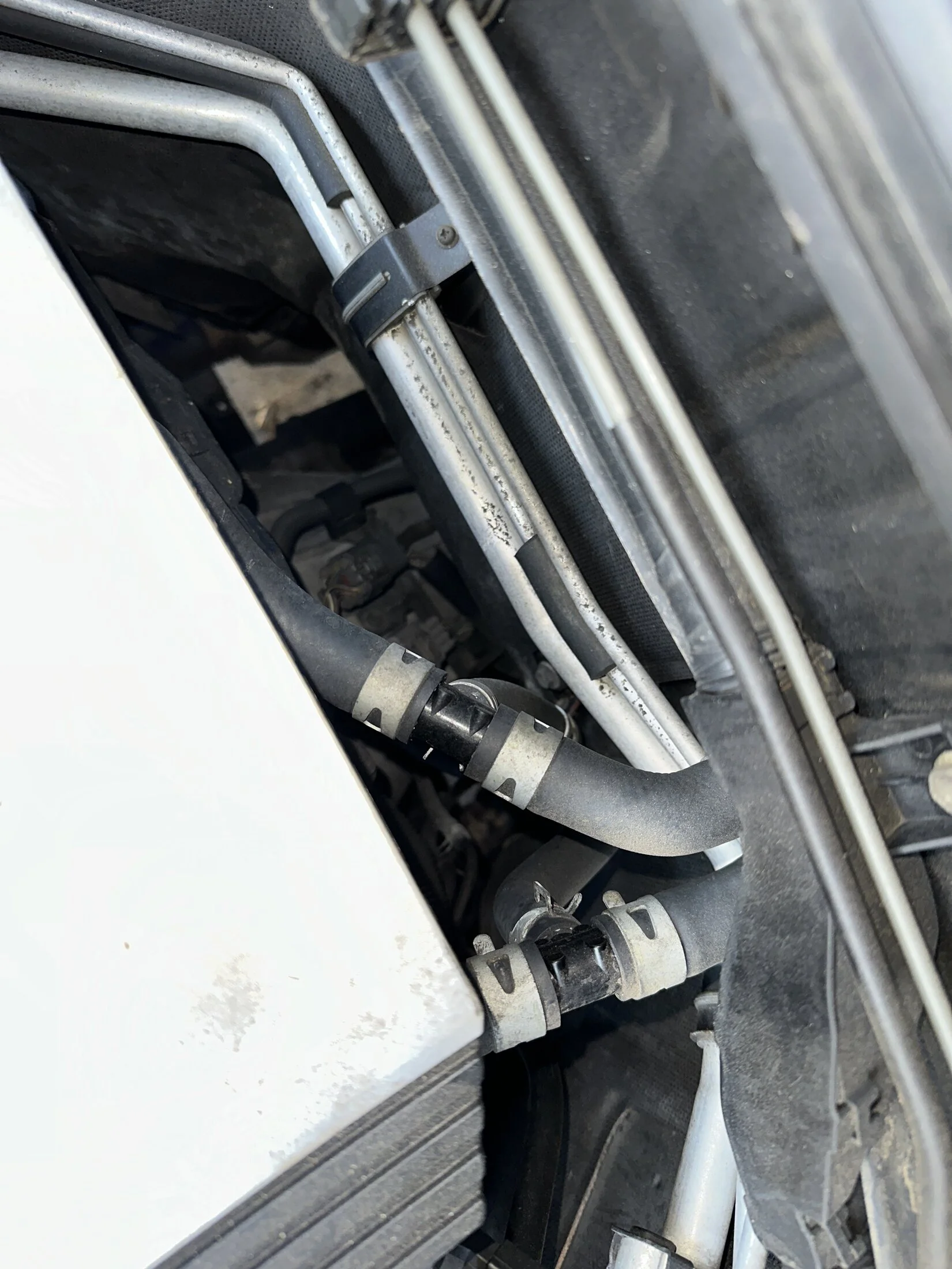

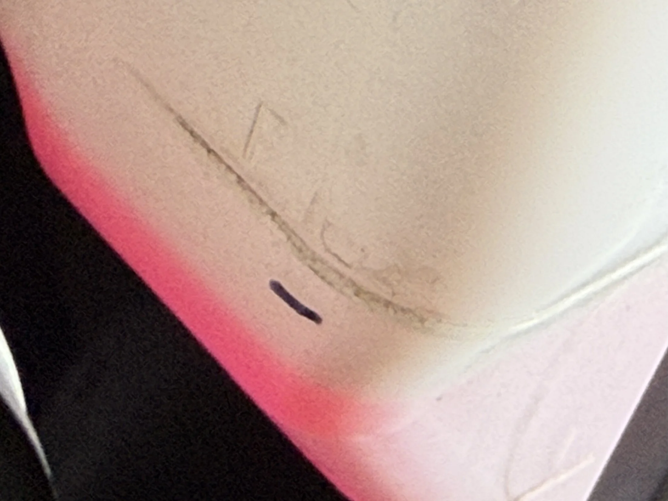

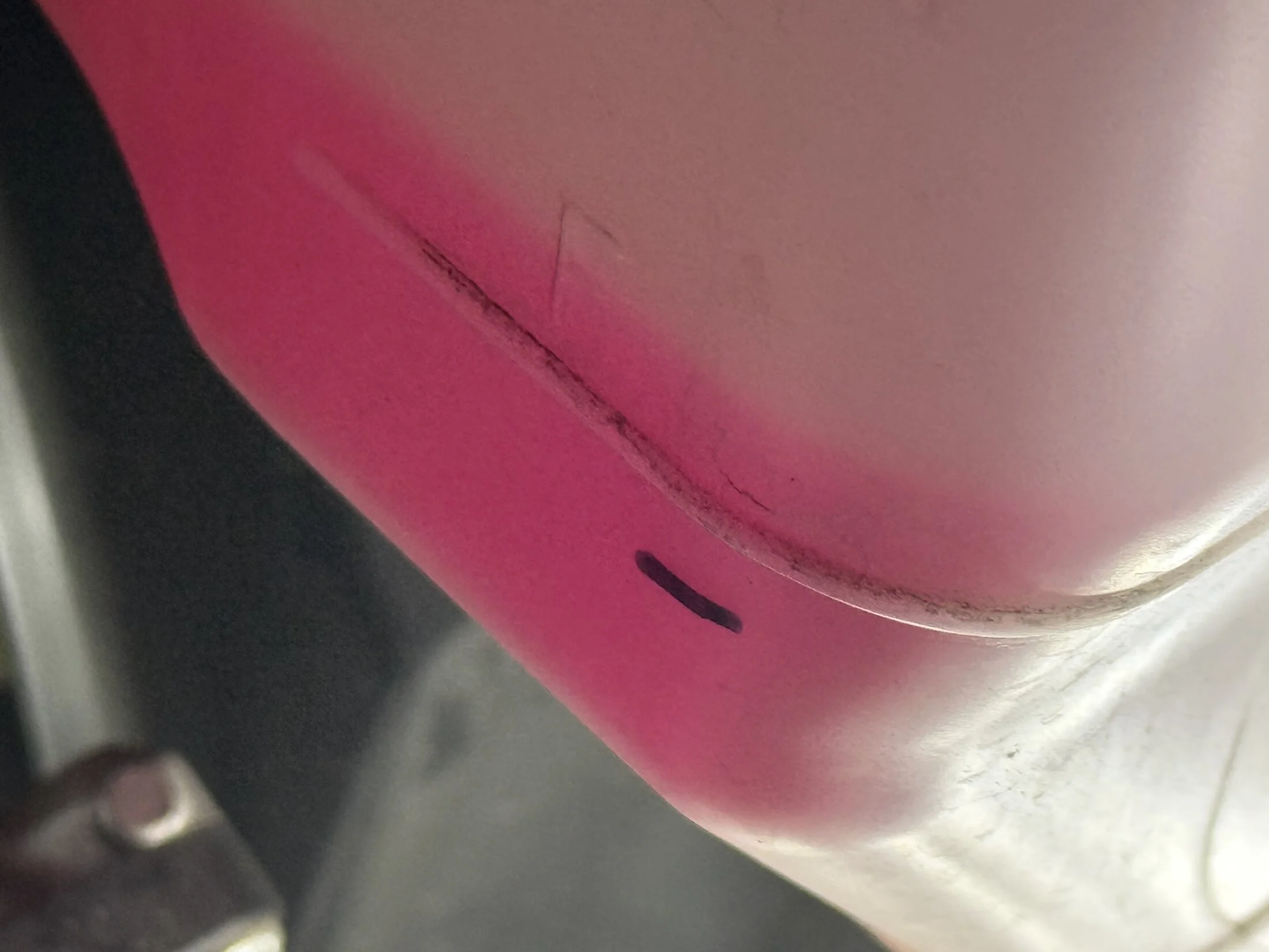

I took the cruiser on about a 550-600 mile trip this weekend. This morning when I checked, my coolant reservoir was almost completely empty. I opened the radiator cap and it had coolant up to the top. Temperatures during driving were right at the halfway mark and never had a dash light for low coolant. Car currently has 221k miles and timing belt/water pump were done at 188k. I have been looking at some of the coolant leak threads and tried to check common spots and haven't found a leak. What I did find is this piece on the radiator was broken. Is this just a mounting piece or can coolant actually evaporate from this hole? First picture is the driver side and second is the passenger side which is not broken. It looks like the piece itself is part of the entire radiator so doesn't seem I could just replace it. If this is not the cause of the coolant loss, I guess I can do the coolant flush I was planning on doing and continue to monitor.
Mounting tabs. If you were losing coolant there you'd see coolant there and/or pink coolant residue.
Got it, thanks. I looked around and couldn't find where the coolant was leaking. I was already planning a coolant flush so I'll do that and monitor.

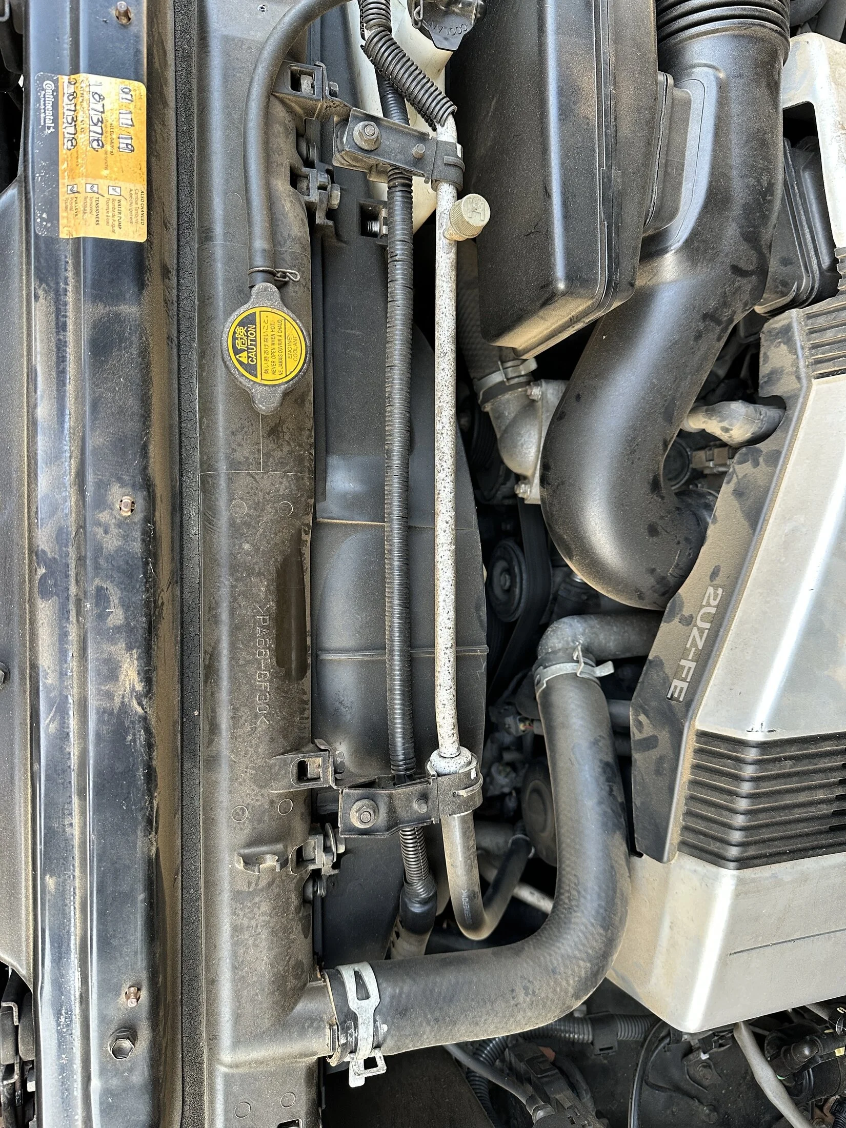

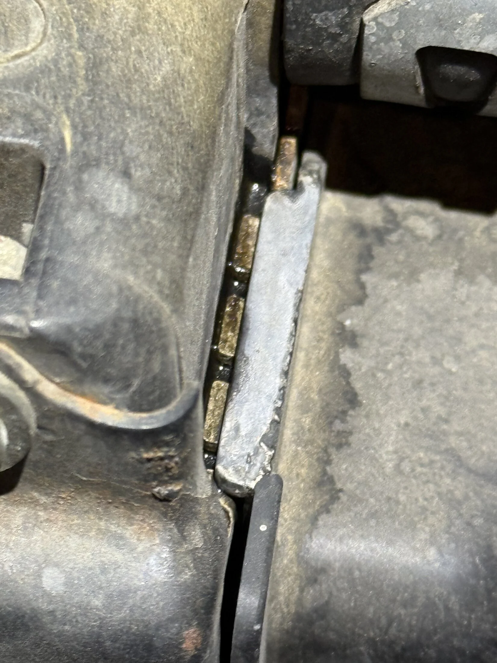

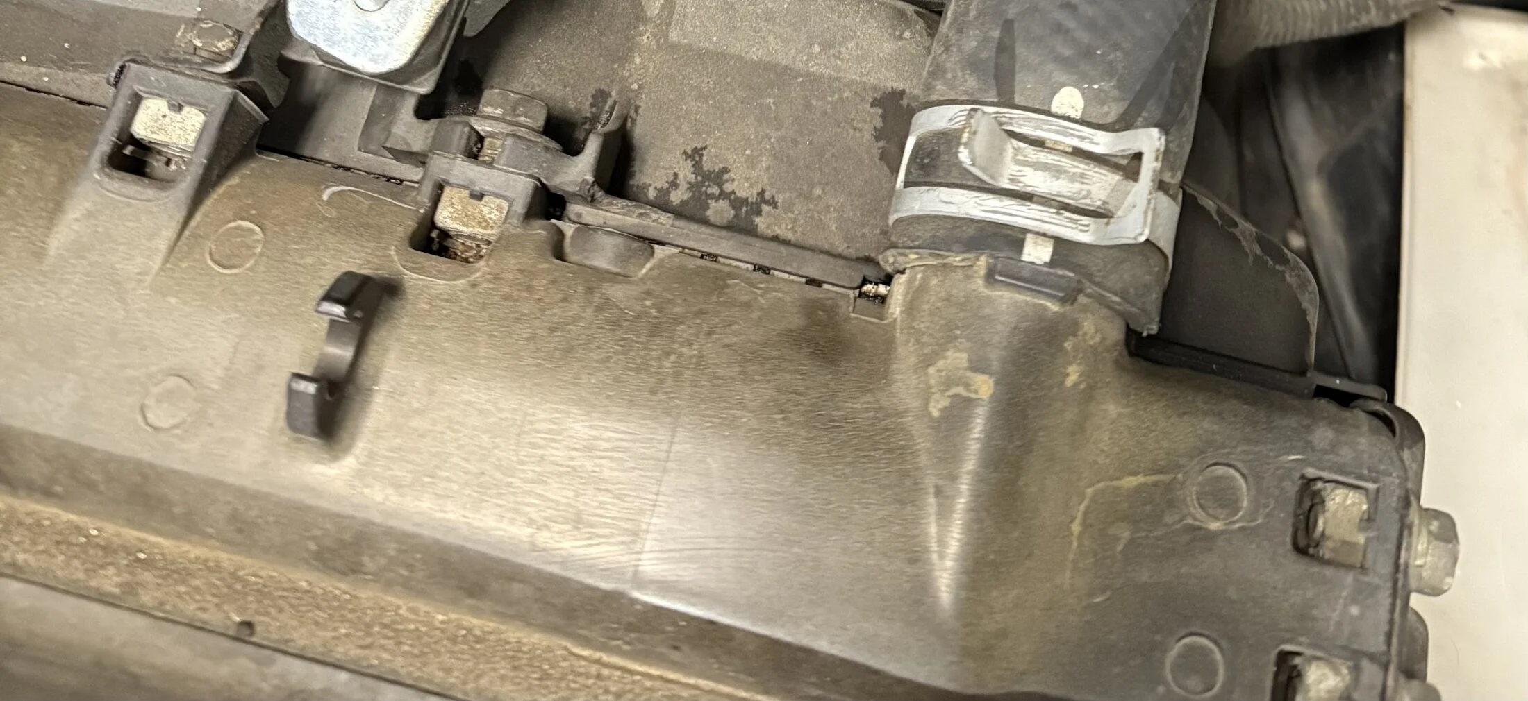

Check the actual color of the top cap (the whole top length). The top cap is plastic, as it goes through its thousands and thousands of heat cycles it will change color as it weakens.
If you look in the pic, compare the color of the fan shroud attachment points to the top cap. The new one by comparison is very dark. Look down between the top cap and you will see little metal “dashes” look for coolant here or evidence the top hose has been weeping

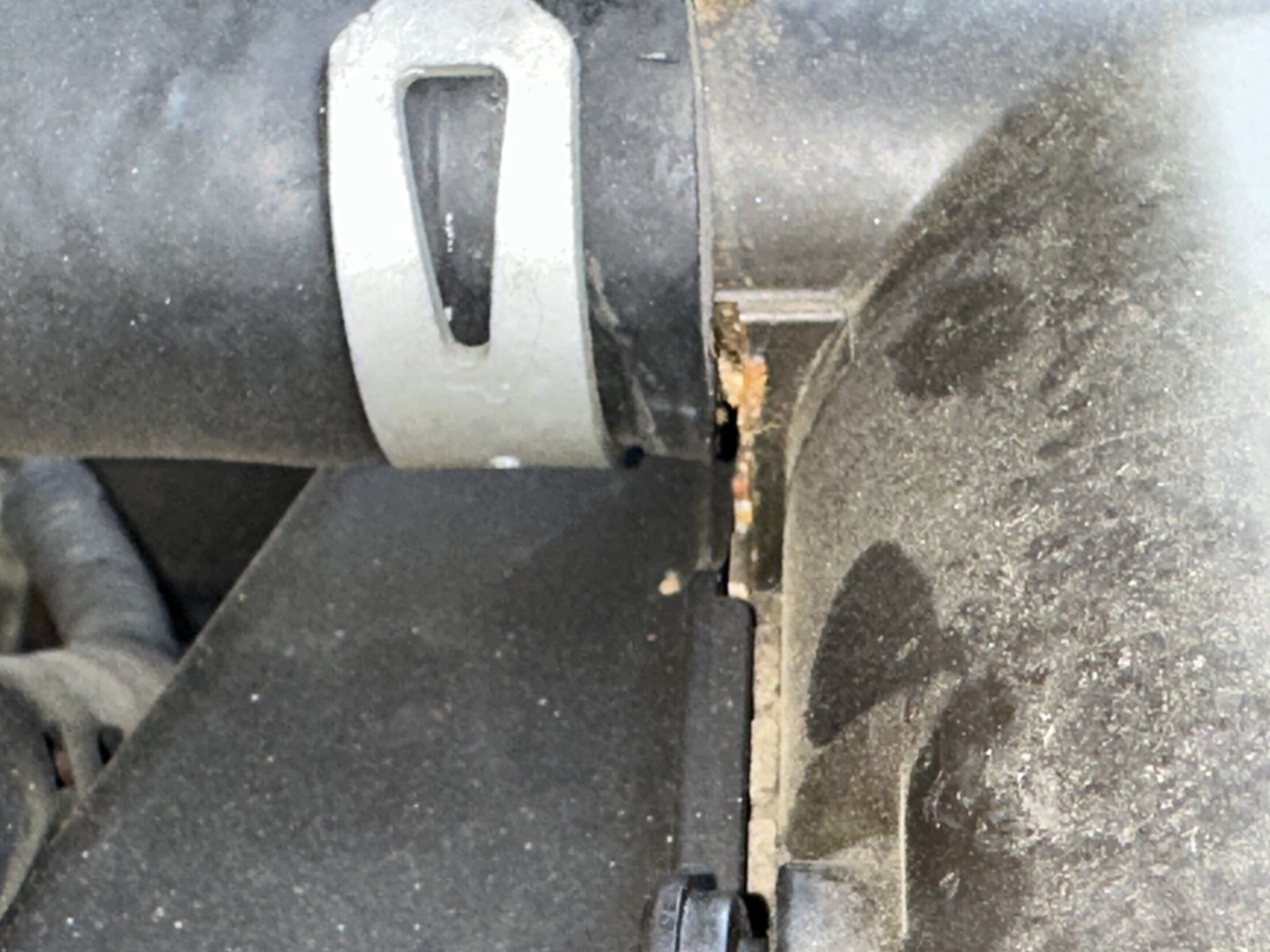

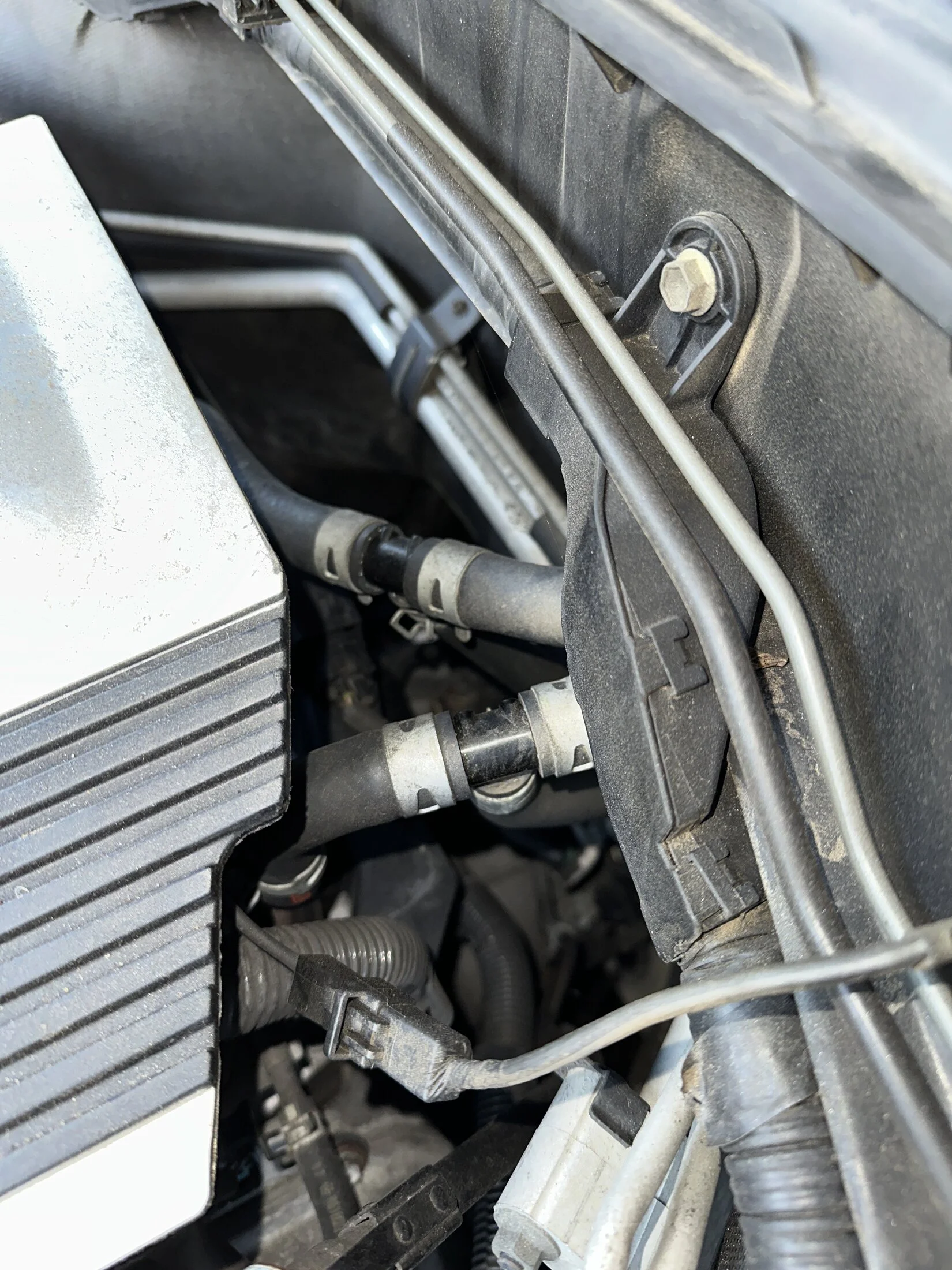

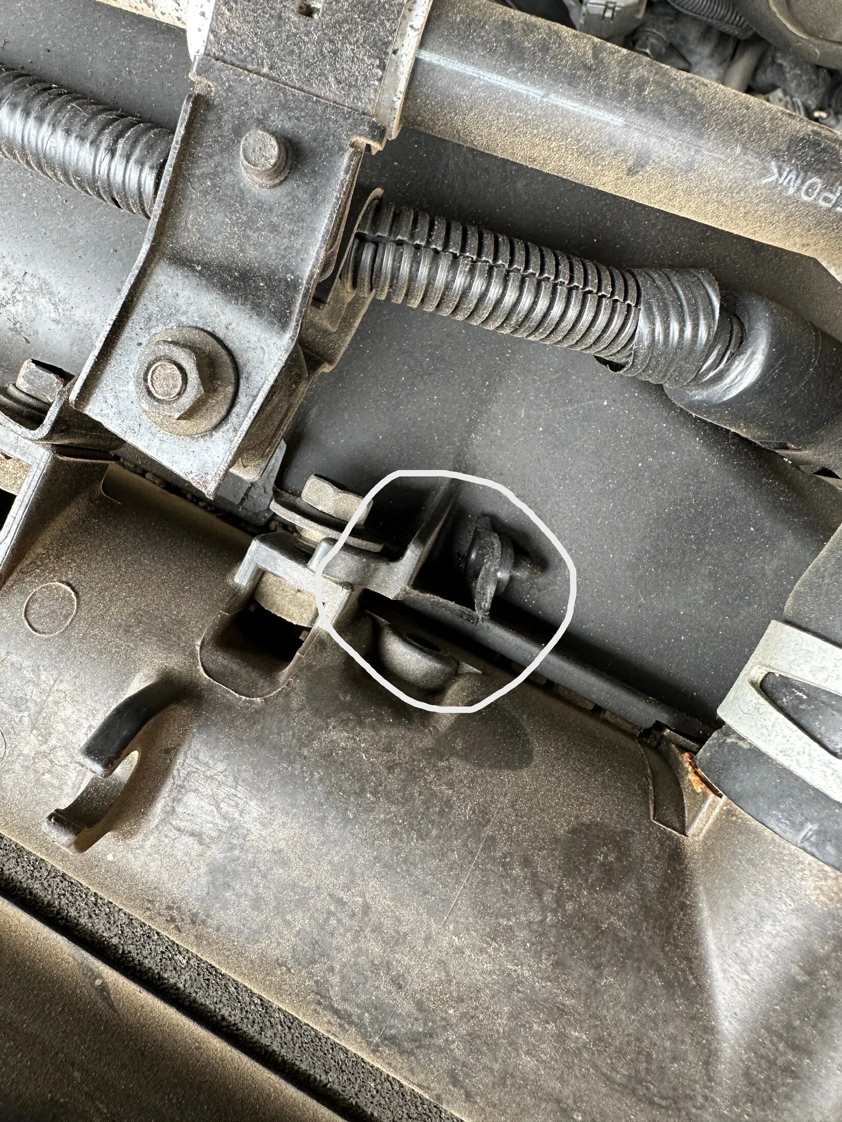

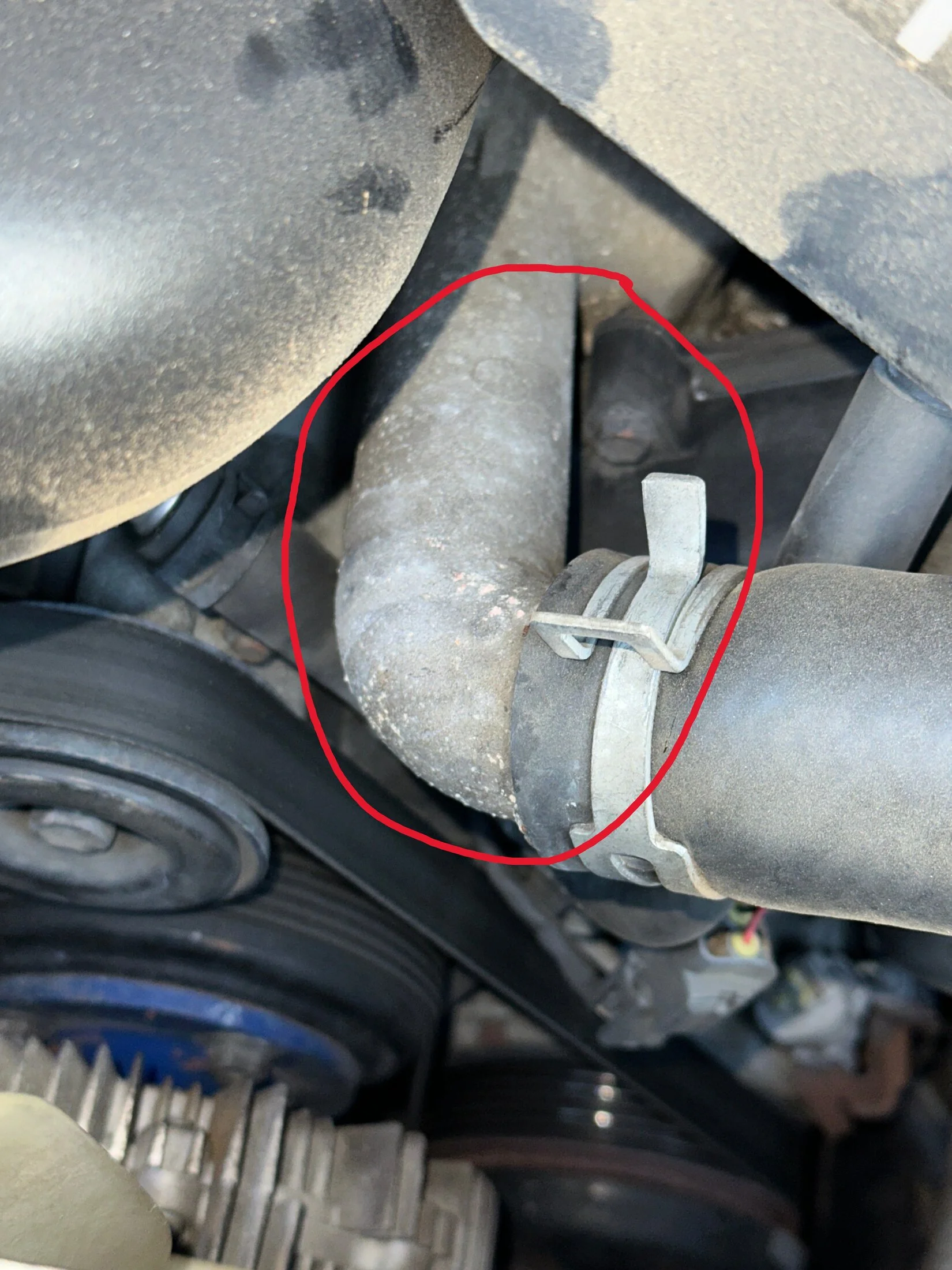

Those were helpful. I wiped the dust off from the top of the radiator and it does look pretty brown, but didn't notice and leaks from the top portion. Regardless, probably should change it. I did notice the top hose had some white residue which may be where it is weeping from. I circled it in red in the picture, is this it or is this not enough for almost the entire reservoir to have leaked from. Also the part of the top hose that connects to the radiator is pictured. I also have pictures of the heater T's which to me looked to be more dust, but let me know if that actually looks more like coolant. I plan to change the heater T's anyway, but would be good to know if that's where the leak is.

If you look in the pic, compare the color of the fan shroud attachment points to the top cap. The new one by comparison is very dark. Look down between the top cap and you will see little metal “dashes” look for coolant here or evidence the top hose has been weepingView attachment 3915640View attachment 3915641View attachment 3915645.
Those were helpful. I wiped the dust off from the top of the radiator and it does look pretty brown, but didn't notice and leaks from the top portion. Regardless, probably should change it. I did notice the top hose had some white residue which may be where it is weeping from. I circled it in red in the picture, is this it or is this not enough for almost the entire reservoir to have leaked from. Also the part of the top hose that connects to the radiator is pictured. I also have pictures of the heater T's which to me looked to be more dust, but let me know if that actually looks more like coolant. I plan to change the heater T's anyway, but would be good to know if that's where the leak is. View attachment 3916941View attachment 3916942View attachment 3916938View attachment 3916939
Heater T’s look like they may be original. Usually a sign when they are still in the factory (pain to get to) position.
Top hose (hose number 1) looks like the constant friction clamp has been moved. I would move it back to its original position. Sort of hard to tell but there may be some weep there.

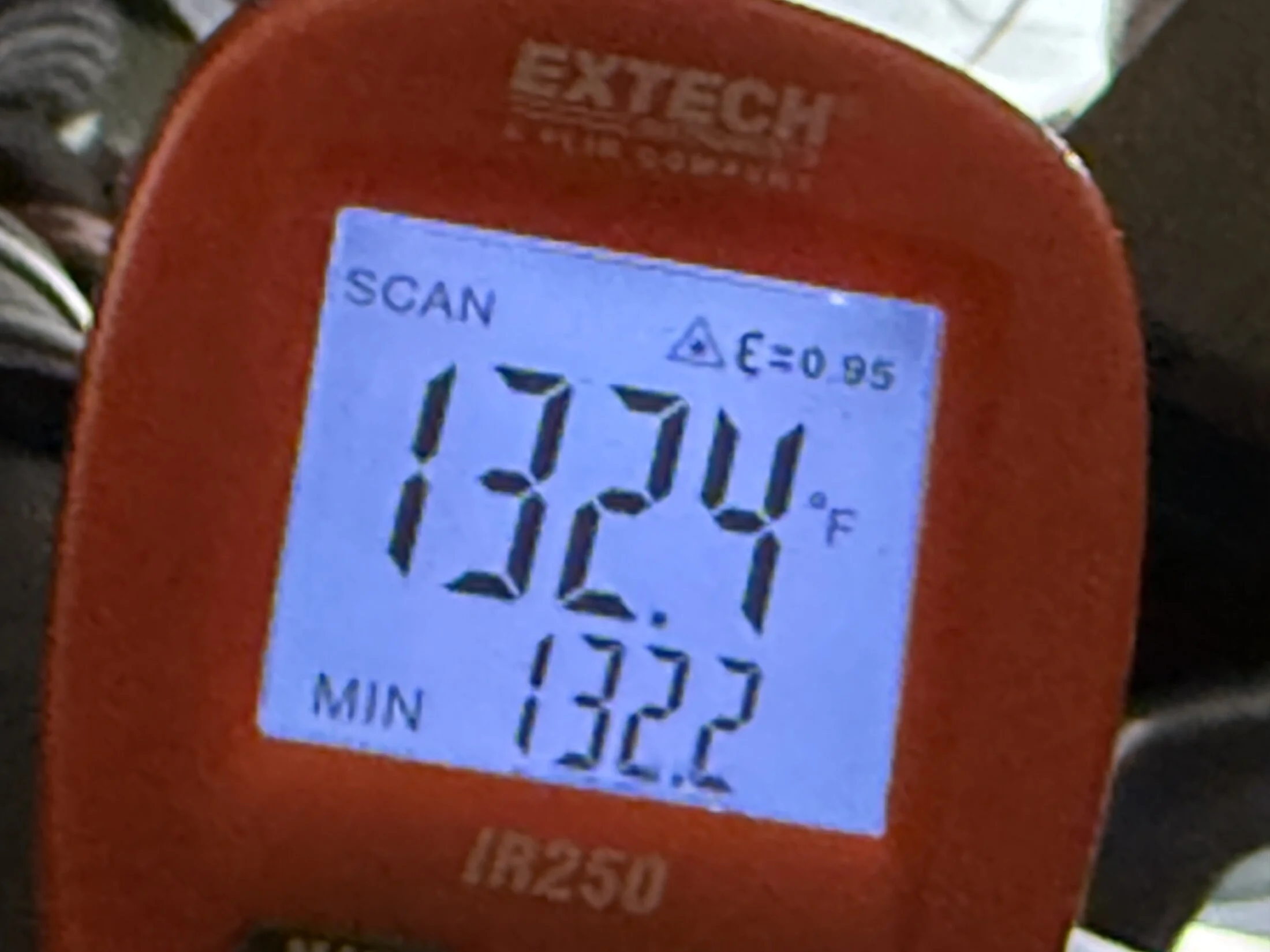

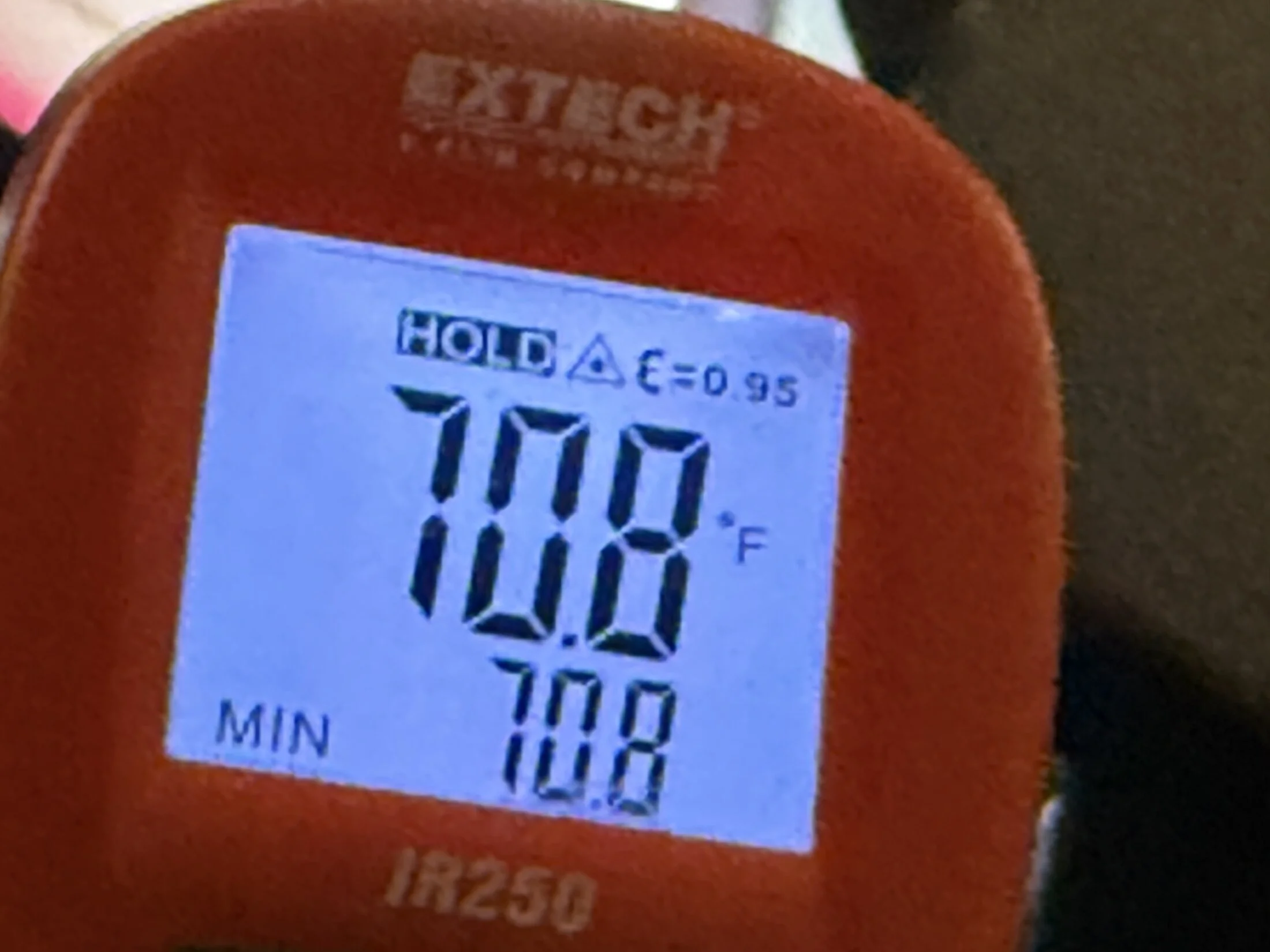

I would add coolant to the overflow in the early morning up to the full line. Note the ambient temp, or if you are industrious shoot the tank with a temp gun. Keep track over a couple of weeks and see if you are losing coolant, but do note that hot coolant will take up more space.

Thanks for all the help, really appreciate it. I’ll add some to the reservoir and see what happens. I’ll clean the residue from the top hose and move the clamp too and see if I’m losing coolant.
