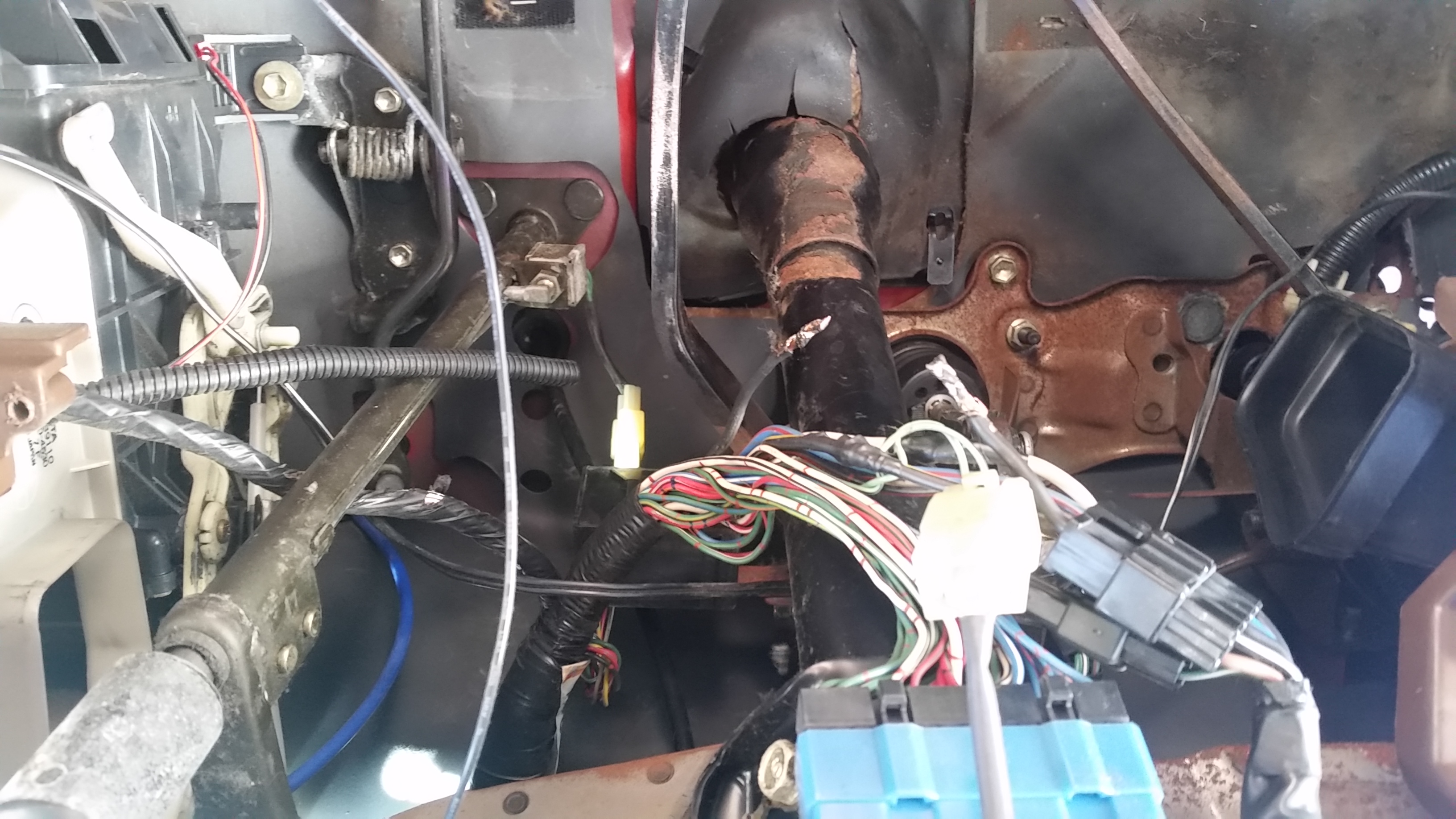

on an unrelated yet comical note, I've figured out why my 86 4runner hasn't been running correctly. The alarm system that i've never used on the truck decided to turn itself on, and i don't have the disarm fob. I found a couple boxes under the dash, one a viper box and one marked Avital zone 1. I saw blinking red lights that were not on and found them.
Ed, maybe some famous Electroman help removing this security system so I at least have a running backup truck?

Watched a 10min tutorial on youtube and learned how to the security systems work and how they're installed and removed.
Woo hoo, all taken out, starter bypass relay removed and reconnected regular. Old red runner now starts and runs, but I now recall never fixing that exhaust leak at the downpipe/cat junction. Not sure if I fixed the overheating on this one neither, but I remember something about a 2 stage thermostat
