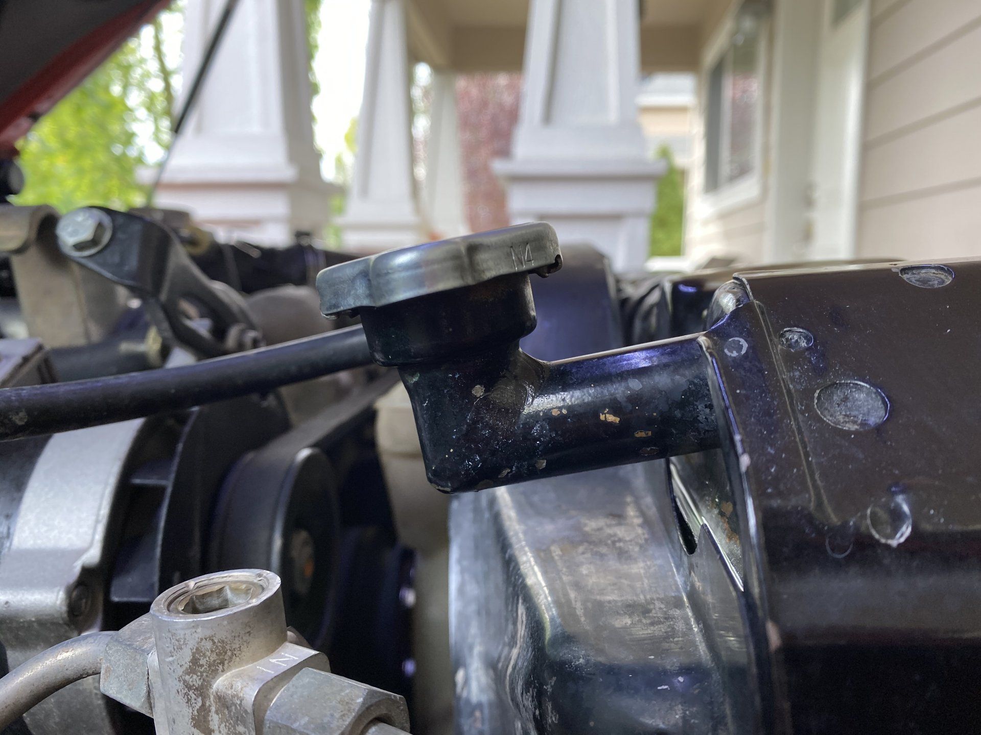

Been reading up on some CSF posts and a lot of folks are talking about the necks behind delivered bent. My radiator now that I am replacing the neck is slightly bent below horizontal. I can’t figure out if it’s a stock radiator or not. I guess my question is, is there supposed to be a bent at all downward for hood clearance or is it supposed to sit level?
Normal/ Not normal?
Curious.. Is your coolant reservoir on the front driver side? Your hose looks like it's going to the windshield washer.

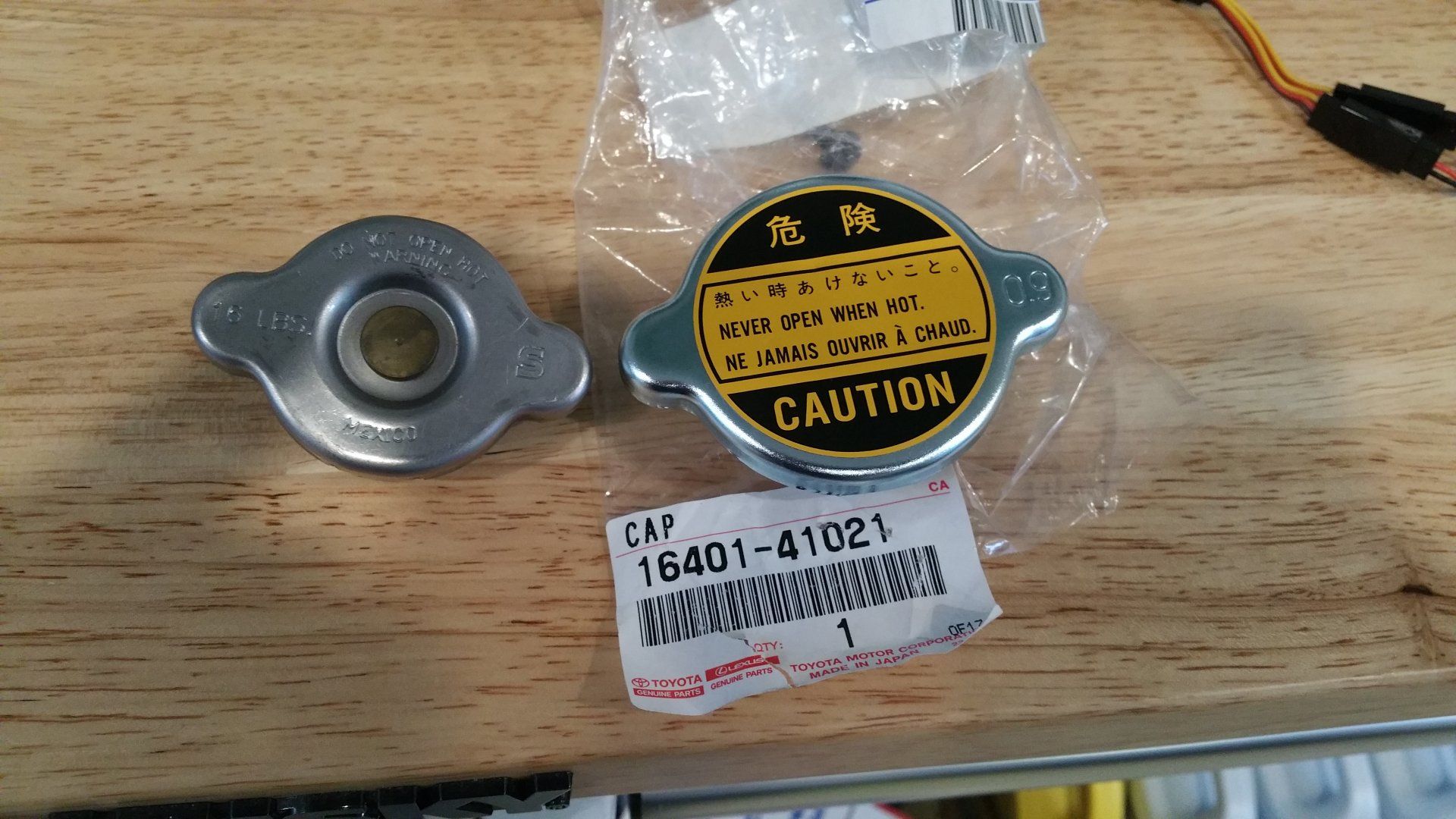

I just got my new CSF 2708 installed. I bought 2 caps and neither fit....one on the Rockauto site, the other oem Toyota. My original cap with cracked gaskets is a 16psi mini and the new radiator has the same one. So what is the correct cap I need to get? Yours looks oem.

My cap is OEM. My new radiator came with one of the cap tabs a little bent.

CSF requires a different cap. I'll find the PN. That was from 9/1/16, it'll prob be a bit more $$.
THANK YOU. Is your cap the mini? Do you have a part number handy? Big difference in size. I might have bought the wrong Toyota cap? Thanks again

@NeverGiveUpYota YOU ARE THE BOMB! Thank you so much. Radiator is in but i might still be able to add that draincock...? Boy do those plastic plugs make a HUGE mess. Gonna see how fast my local dealer can get me one of those caps. Thanks again
