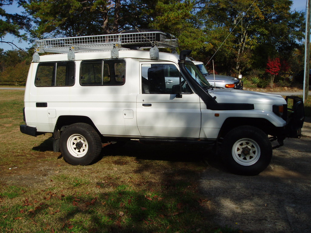

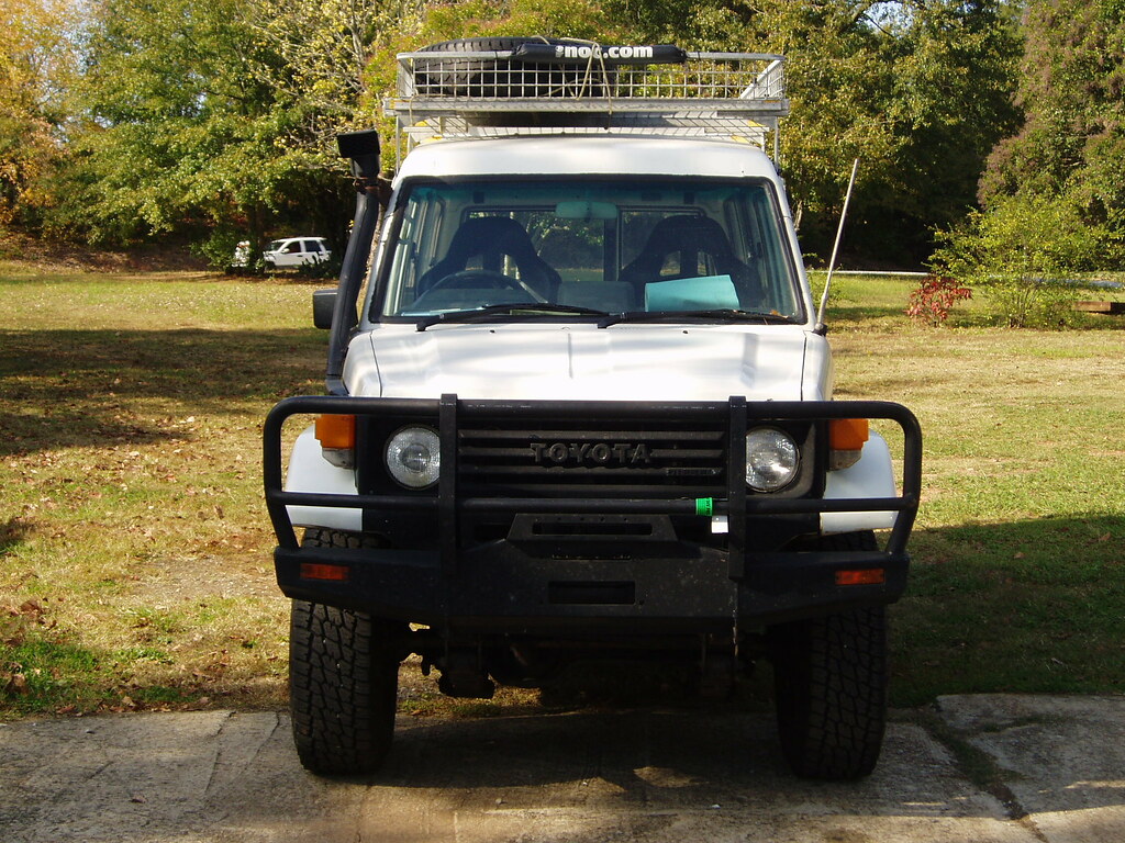

1. Getting her home and taking the rack off.

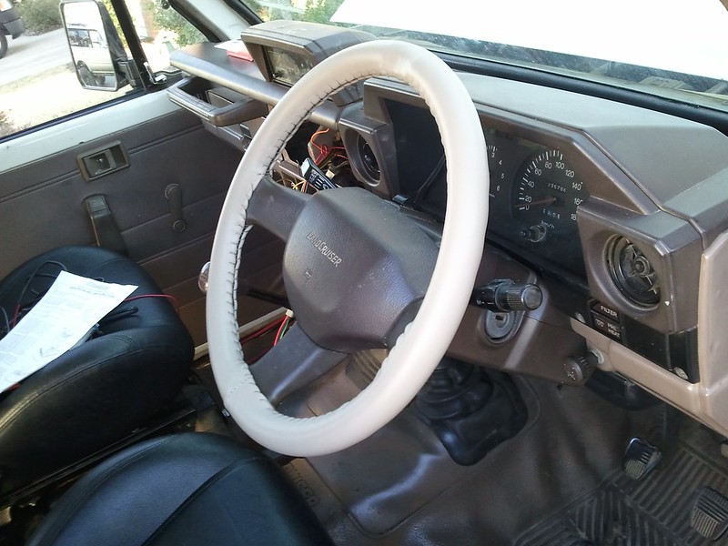

2. Interior starting point.

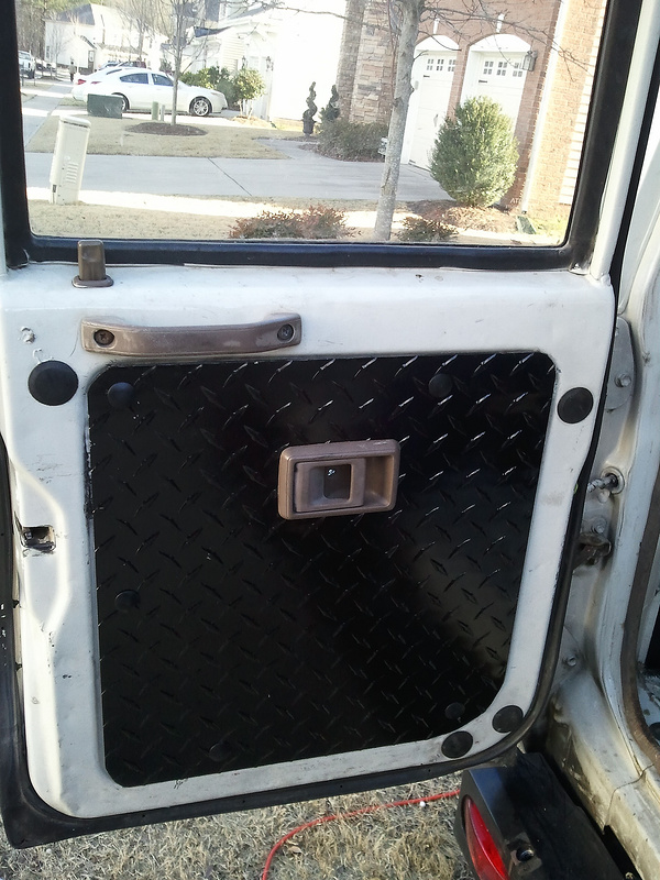

3 & 4. Mods waiting.

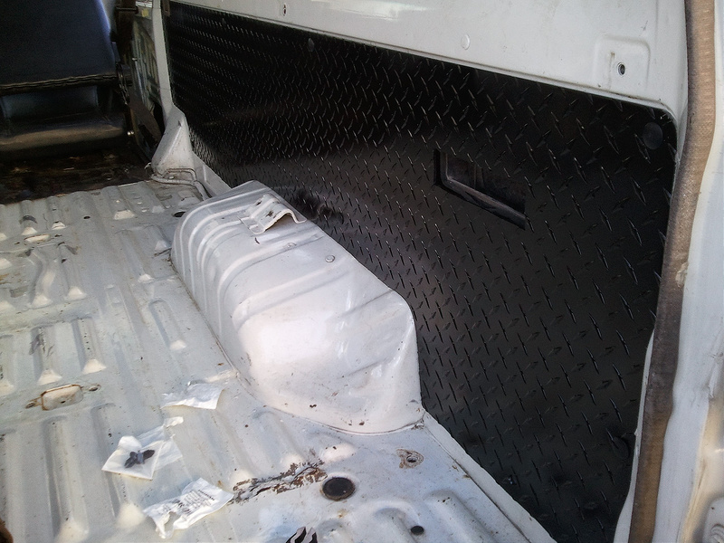

5. Interior post Second Skin sound deadening and diamond plate paint.

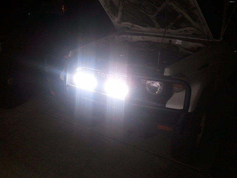

6. LEDs installed and ready for Darin's.

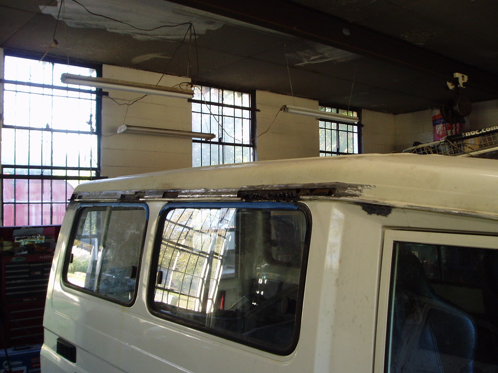

Did a little metal work above the drip rails. Not unusual on Toyotas, had the same on my 60.

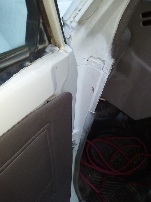

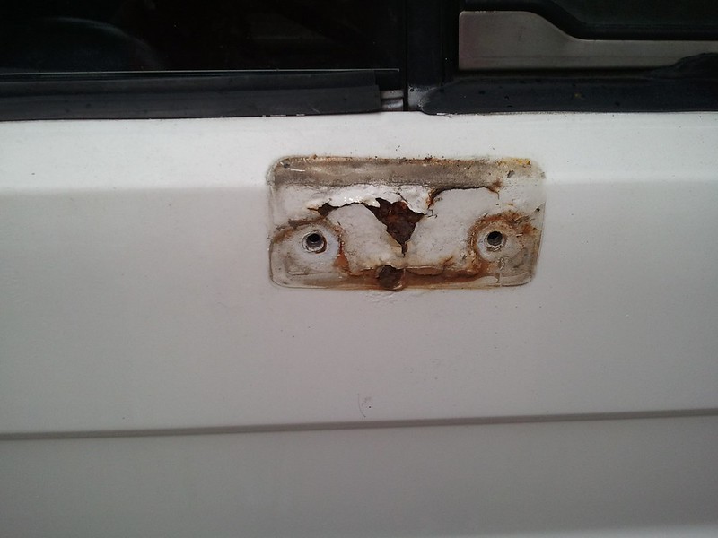

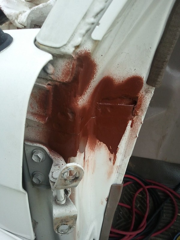

Then spent a while getting rid of some surface rust, this one that darin with weld up and cover since it made it through the outer skin.

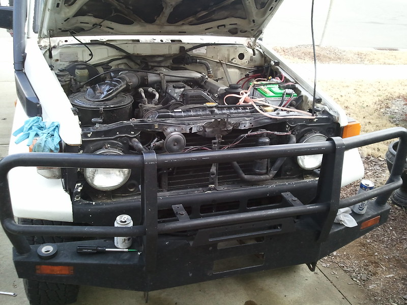

The main focus was to get the lights, horn and window wipers working again for inspection so Brett could register it.
The first two days were working on these. Checked to see if the wiper motor was getting power, it was. Checking the linkage (which broke 3 bolts removing it), and a crap load of other things. I finally took the motor apart and found out that all three of the brushes were completely worn down to nothing.
These parts are not replaceable so we had to order a new one, which ended up with two wrong parts and a lot of phone calls, emails to canada. Sadly the part number was worn off the original so it made tracking one down even harder. The right one should now be in the mail and on the way to Darin's
Thought the horn was a wiring problem which turned into a wild goose chase because there is about 200 feet of wires that go no where and do nothing stuffed into the engine bay and up under the dash.

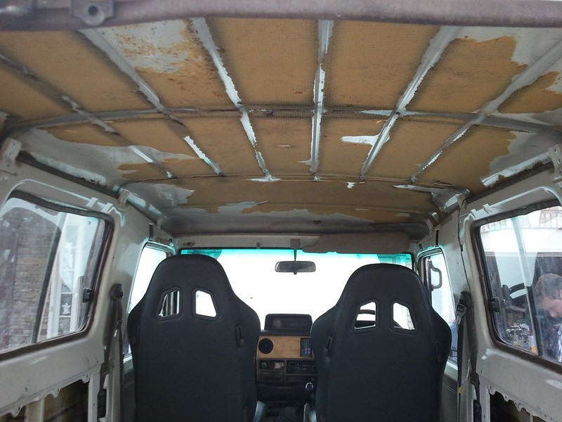

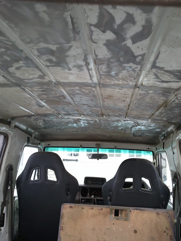

stripping off the headliner which took for ever. I'm not sure what kind of wacky japanese super glue is up there but I want a tube of one. Even after dousing it in about 6 cans of adhesive remover, paint remover and everything suggested at lowes it still would stop my dewalt drill with a wire brush to a dead stop. Finally I took a grinder to it and covered myself in the process.

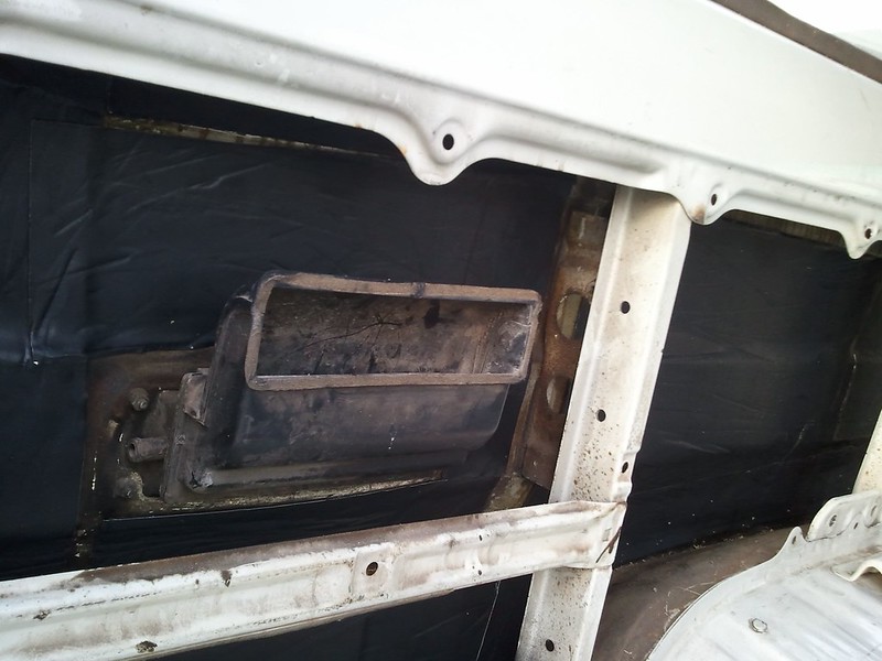

We sound deadened the doors (front and rear) and the side panels of the truck. Spent a while tracking down an annoying vibration with eventually turned out to be the seat belt roller. Now the thing is dead quite compared to before. When the roll on sound deadener hits the floor and roof it will be great.

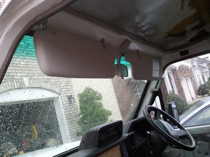

Tracked down new sun visors because one was missing and the other was starting to crack. Tracked down new style windows from a 76 cruiser because one was missing and the other cracked and the 76 series ones are bigger and look better.

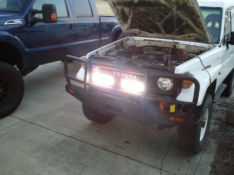

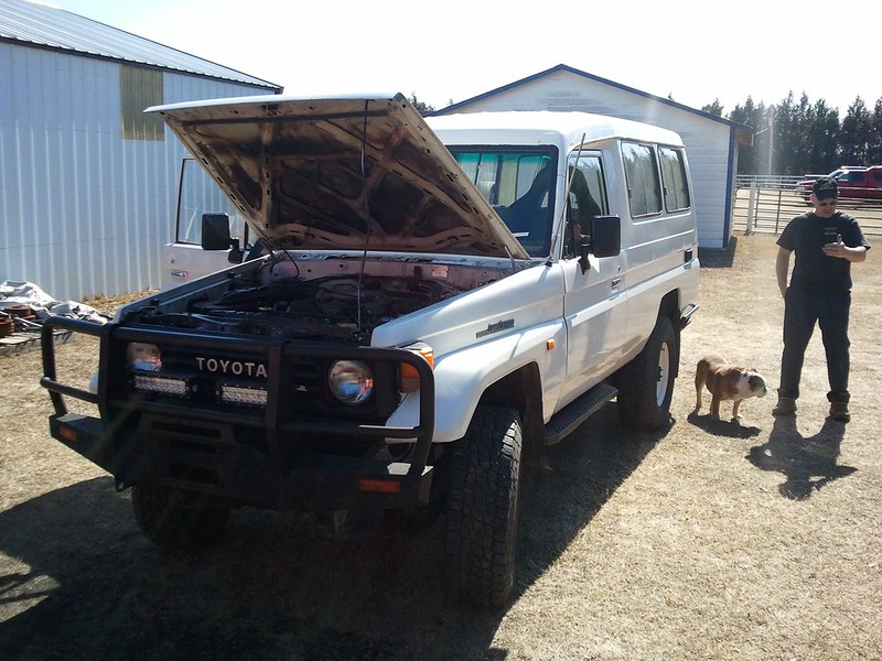

Installed the LED bars I won at Logan's run.
Fixed a connector on one of the lights that was stopping it from turning on.
Put blue LED's in the dash and rear tank gauge. Put super bright CREE's in the reverse lights, and the dome lights. (had to fix a connector to get the dome working again)

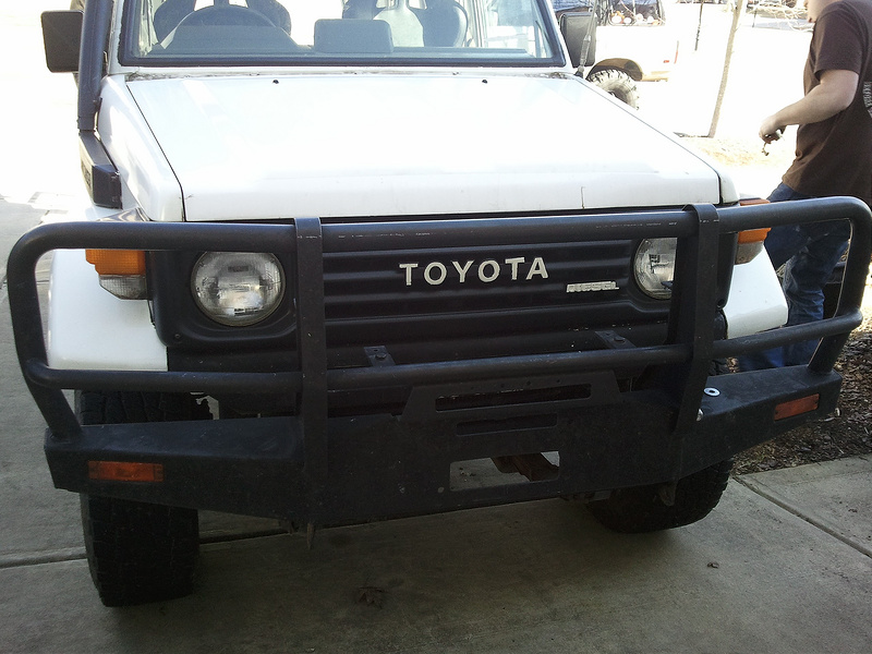

Removed and painted the Grill. and the lower panel below the grill.

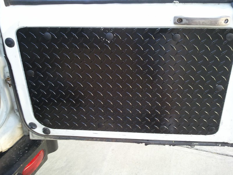

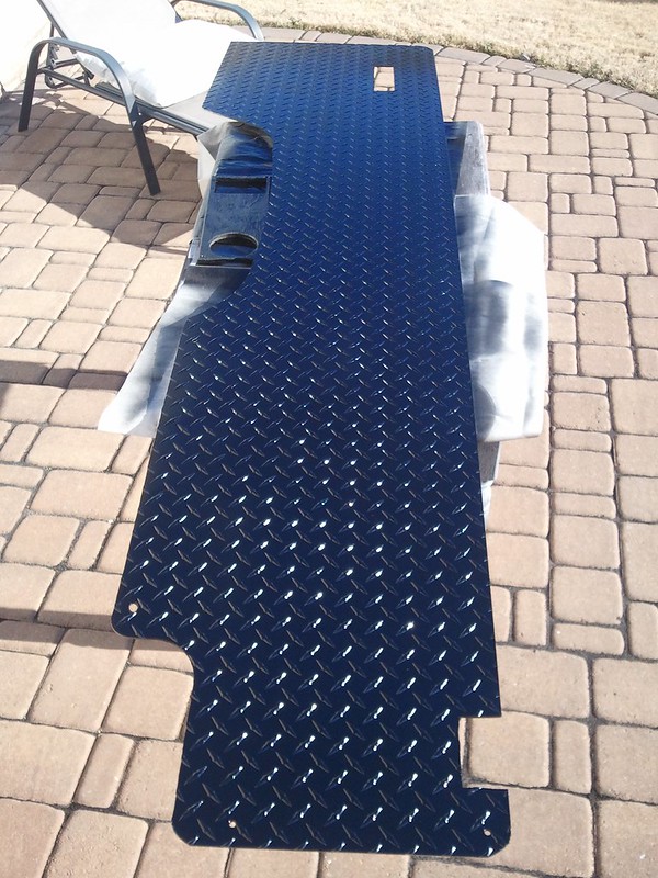

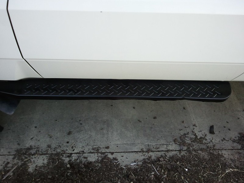

Removed and painted the diamond plate gloss black.

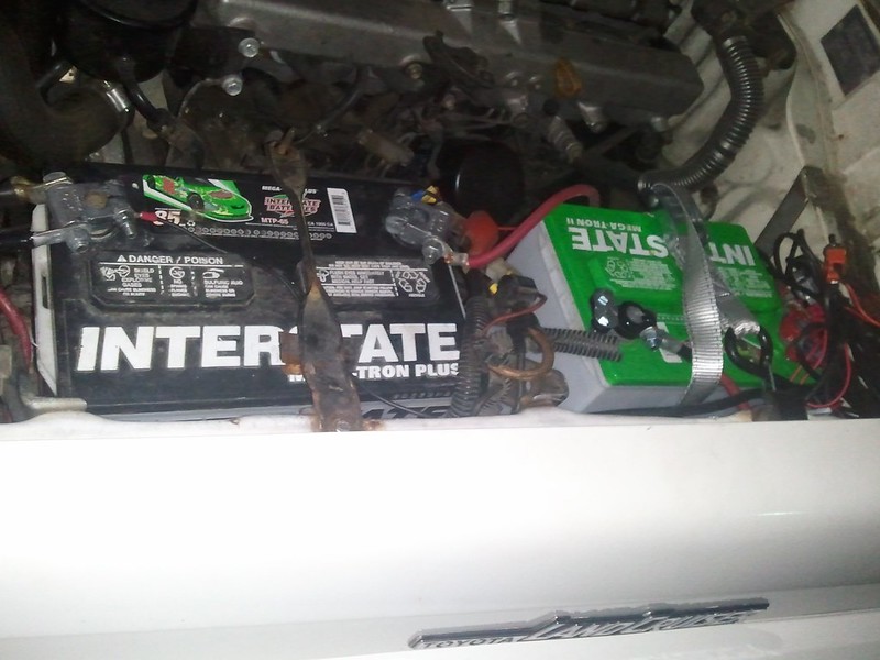

Finished up the dual battery that Quinton had started back in July. And figured out the slight battery drain we were getting was from it being half installed.

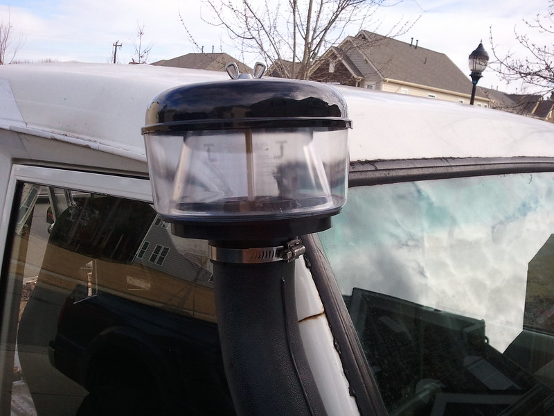

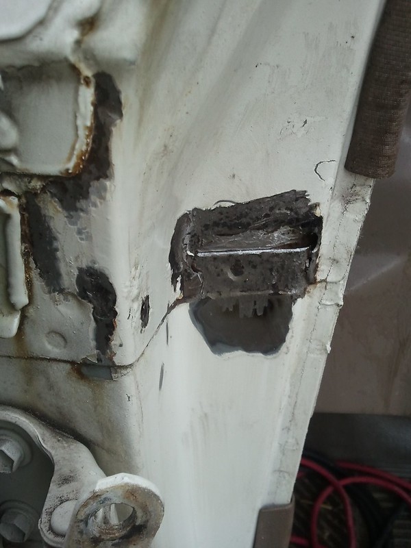

Installed a donaldson pre filter on the snorkle only to realize that at some point someone had hacked up the top of the snorkle so it wouldn't re attach to the a-pillar arm or would and leave a large gap. While trying to re-install it a bolt broke and when trying to extract it the bolt and the threads disapeared inside the pillar :mad: (Another thing for the master, Darin, to fix)
Installed a new leather steering wheel cover.

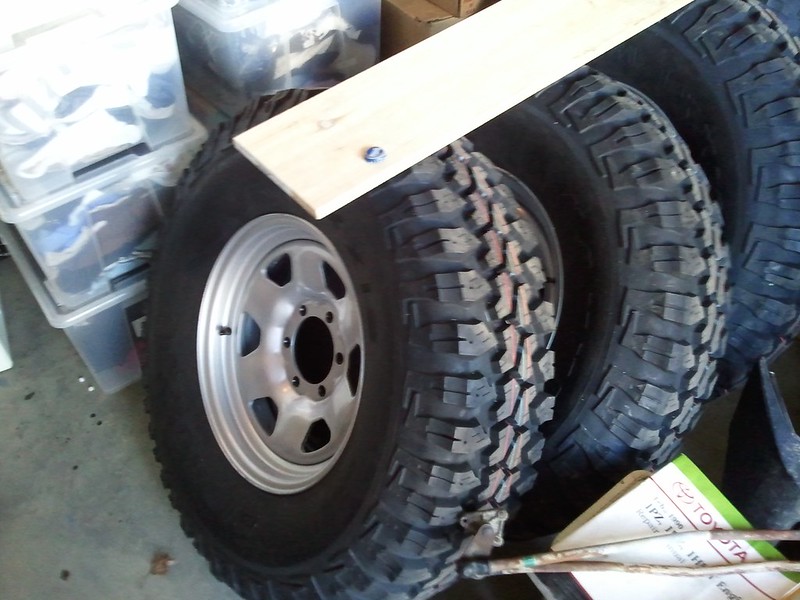

Ordered some skinny 33 MT tires. Maxxis big horns

Eventually the ARB will be repainted also

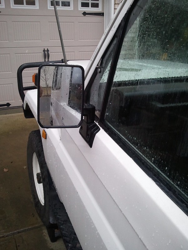

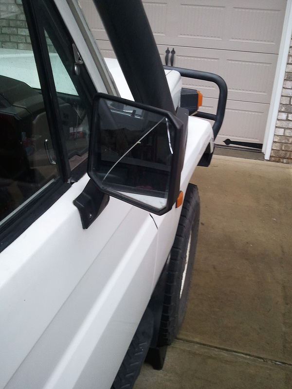

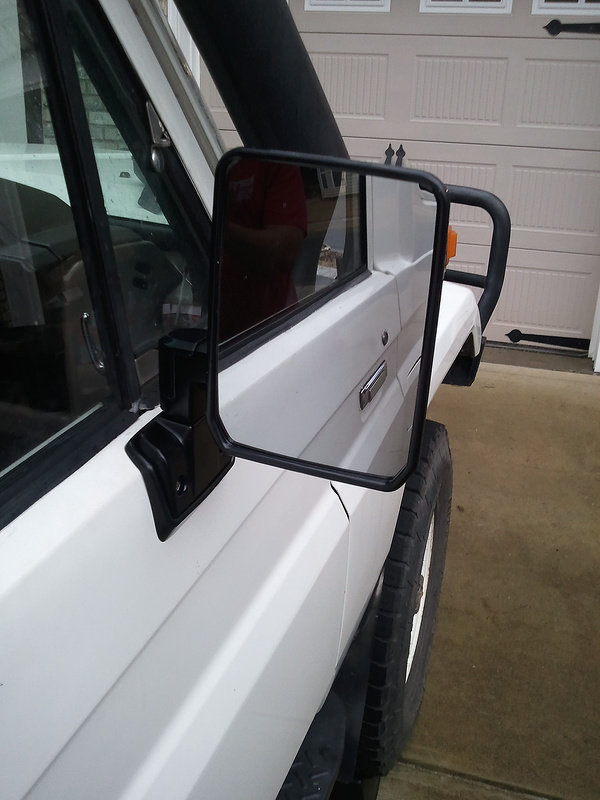

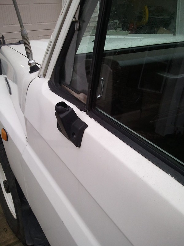

Mirrors
Found this under the drivers mirror that will have to be ground off and painted soon.
Before
After

New pre-filter
Sun Visors
Painting the diamond plate and some dash pieces
Sound deadening behind the panels
Panels installed
Painted the side steps

New Tires on Factory 70 series wheels
LED's installed (there are the Spot kind since Eric and John Vee were wondering)
