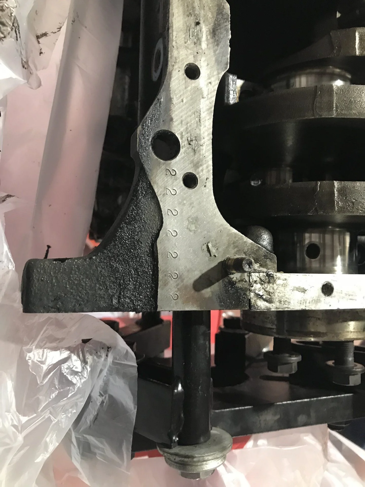

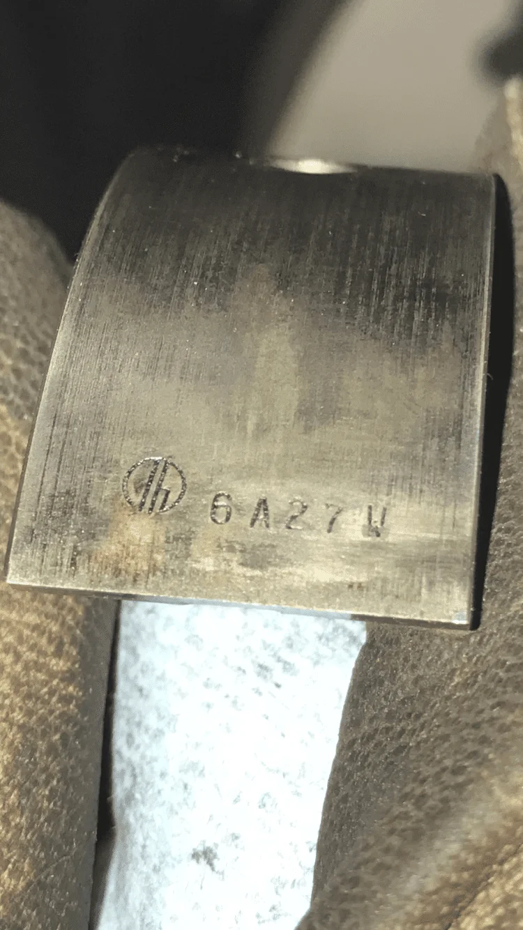

The engine block stamp shows “2222222” which per FSM indicates I have std #2 bearings for the crankshaft bearings. The individual crankshaft bearings did not have any marks on them even though FSM says it should. All we saw was some other #s.
All the conrod bearing caps were stamped #1. FSM does not indicate what this number means. I am assuming this means the conrod bearings are std #1.

Your best bet is going to be taking it to a machine shop and having them measure everything. Have you checked the crank at a machine shop as well? Mine "looked" really good, but the machinist said he would grind/polish the crank and I would need the next undersize crank bearing. My rebuild kit already had the crank bearings, but they weren't any good to me after the crank grind. Between this and the cam bearings I had a few weeks/month of parts finding/shipping waiting to get the right parts.
I would get the crank/cam checked to make sure they are in spec and measure them, then go ahead and order whatever main/con-rod/cam bearings that correctly fit. You should be able to find the measurements for the parts you are ordering.
