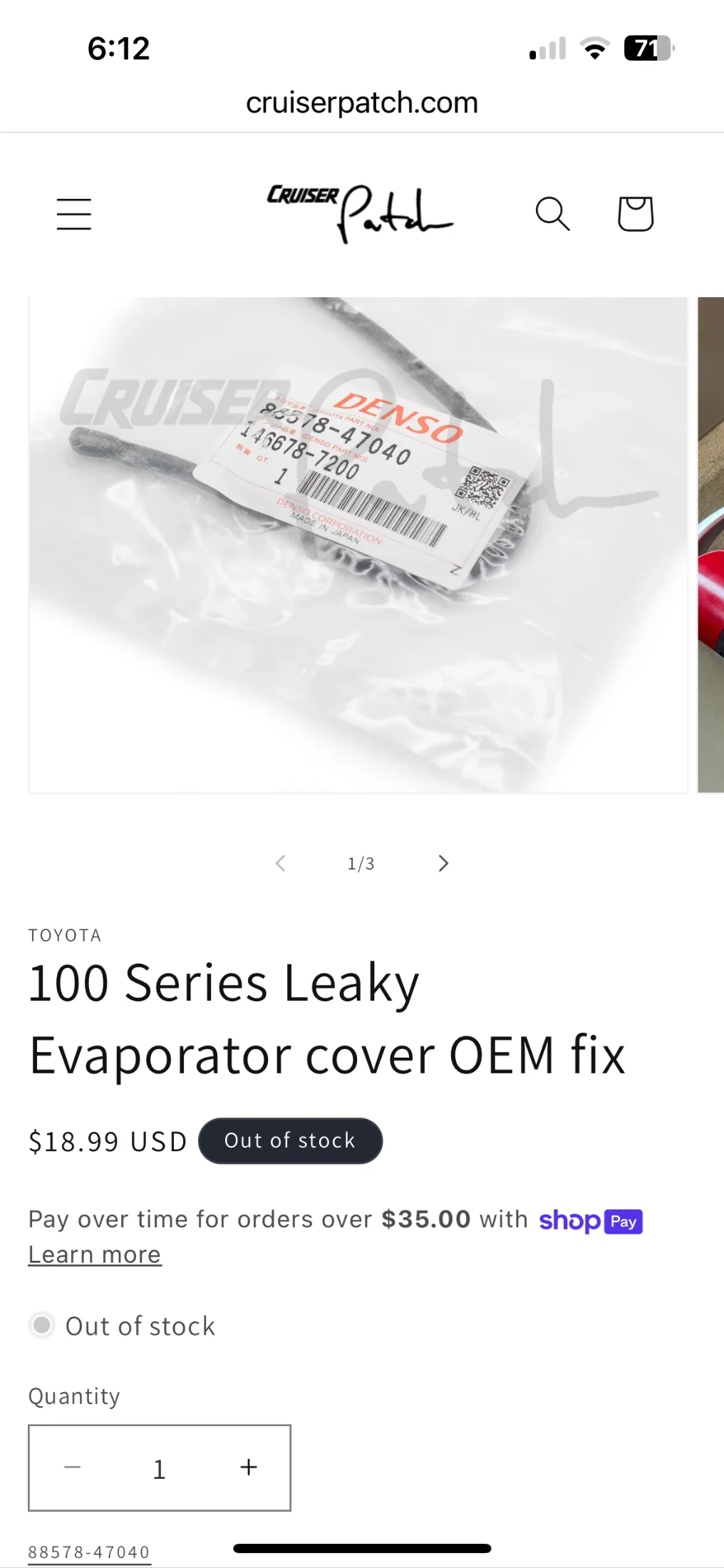

CruiserPatch sells a kit to address this.
@RollinYotas, thanks. If this is the one you are speaking of, it’s out of stock.
You’ll be completely underwhelmed at the OEM foam gasket, and more so when it starts leaking again in a few years. A couple years ago I used a piece of rubber window screen spline. It worked great.
