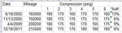

I think it is more important for the numbers to be close to one another than what the actual value is. What I mean is that there is a lot that can influence the the test--accuracy of your tester, are all the plugs removed, is the engine warm, is the battery fully charged, is the carb throttle wide open, and of course, what is your elevation.
These are my compression numbers, taken over the years, using the same tester. The numbers are higher than the FSM, and I have over 200K miles. But I don't think this means my engine is better than yours.
3 and 5 look identical, and only 8% off, so seems like not much to watch.... Cheers on a solid motor!
