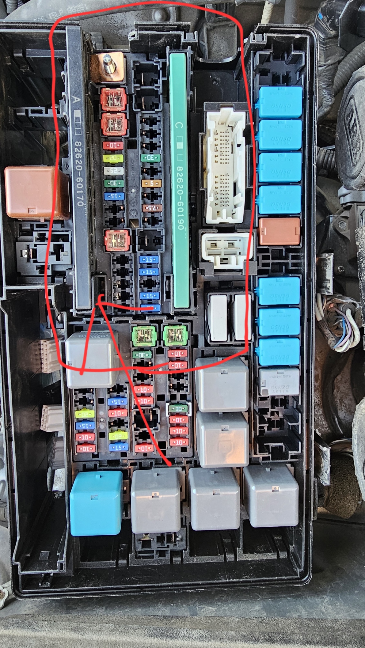

I am pretty sure it is the main fuse bar (fusible links). Replacing it is proving to be a pain, apparently requires taking the fuse box, which is not going well. Any guidance there will be appreciated.
Well, I got the replacement fusible link assembly and was able to split the top and bottom of the relay box, but still need to remove the section with the fusible links and can't. Has anyone done this? I was hoping the link assembly (the black bar) would just come out, but no, and I can't find a way to push it down to unbolt the end tabs.
Well, I got the replacement fusible link assembly and was able to split the top and bottom of the relay box, but still need to remove the section with the fusible links and can't. Has anyone done this? I was hoping the link assembly (the black bar) would just come out, but no, and I can't find a way to push it down to unbolt the end tabs.View attachment 3752055

a lot of the Toyota fusible link bars have a couple screws into the tabs on the bottom of the blocks. you have to dig into middle earth and disassemble the origami'd fuse box assembly to get to the bolts then the block lift out. There is a bunch of cussing involved so plan go do this away from the women and children.
